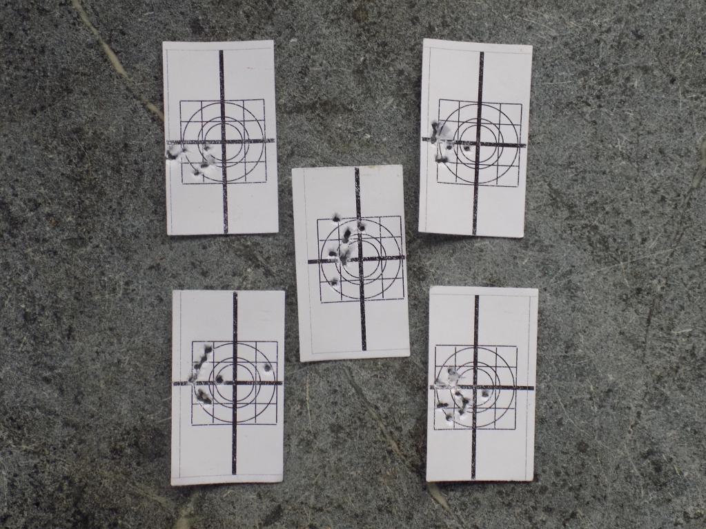

I shot five nine shot groups at 36 yards. The average group size for the five groups was 1.16 inches. That's not terrible but still far from what I am after. Using a quarter I could cover 40 of the 45 shots shown on the target. So eight out of nine shots went into quarter at 36 yards. For perspective the top left group just fits under a quarter. Here is a pic of that target:

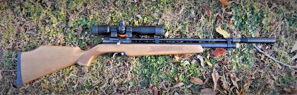

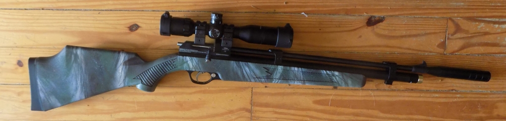

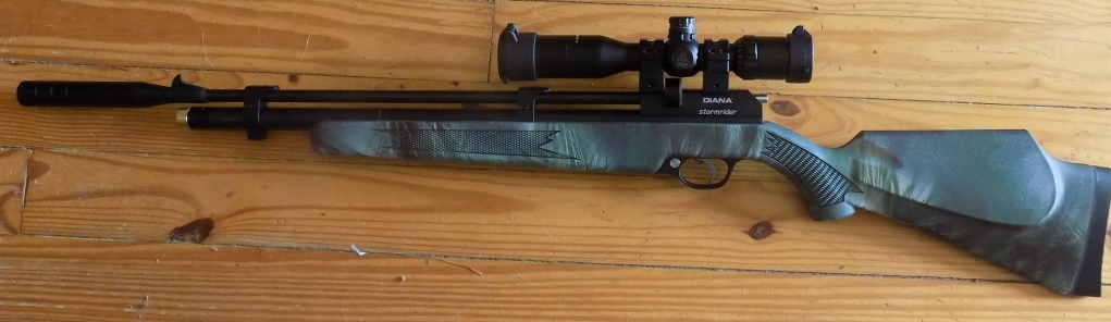

I also went ahead with the camo, even though I could not find all the colors I wanted. The end result kind of grows on me so I guess I'll keep this way till a better idea comes along:
As it is, this is a 40 yard squirrel rifle. It holds 30 shots of air at a very consistent 965 fps for Barracuda Lights. That works out to three magazines at 16 fpe into a group that will stay on a squirrels head at 40 yards. Like I said I had hoped for more but, really that is a lot of bang for $425 when you include the regulator, extra barrel band, and 3x12x32 UTG.

So I got out the dremel and made sure I got the crown and "forcing cone" properly polished and crowned. Then I shot the following targets. This is a slight improvement over what I shot on the cardboard in the above post but not what I expected. Group size went from about 1.2" average to about 0.9" average. So an improvement but not yet what I wanted. Here is the target. What we know for sure from talking with other Stormrider owners is that the crown will need work and the forcing cone will need polishing. The former improves pellet flight and the latter prevents pellet damage during feeding. In both instances on my gun the metal edges were still sharp and there wasn't any chamfer or bevel or crown of any type. The small squares on these targets are 1 CM square. Two and a half squares to the inch. Have a look at this target at 36 yards, nine shots in each group:

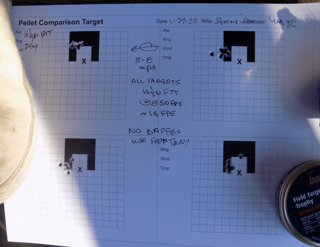

Here are all the targets I shot in one sitting after that change:

Well, just a brief update. Today I was again shooting this rifle. It was again disappointing me. So I ran through half a dozen different pellets again. And again decided something just wasn't right. I removed the moderator and installed the barrel bushing that serves as a crown. It comes in the hardware with the rifle.
Talk about LOUD!!! Once you get used to a silencer your forget how loud a PCP is without it. Well I measured 72 dB behind the rifle without the silencer. Then with the baffles removed but the silencer attached, I measured 64 dB behind the rifle. With the factory baffles installed l measured 61 dB behind the rifle. My son tells me the one I sent to him is much quieter than the Diana 350 he already has.
I noticed something else. This rifle is picky about it's choice of pellet but it shoots them all better when the silencer is removed. I guess my earlier observation was made while switching pellets. So I shot half a dozen different pellets with the moderator removed. It liked the JSB 8.44gr and the H&N FTT 8.64gr. pellets best with both of those shooting into dime sized blobs at 25 yards.
Well I decided to reinstall the moderator and remove all the baffles. That quieted the rifle and the groups immediately opened up to about an inch or so at 25 yards for the two favored pellets (mentioned above). This is getting frustrating. The groups were better than they were with the baffles installed but worse than they are with the moderator removed. I'm thinking some baffle testing is in order.
To that end I am running some baffles off on my 3d printer tonight and will get back to this thread when I have tested with those.
This will likely be my last post in this thread for a while. I took the Stormrider out with the 3d printed moderator baffles. That did not go well at all. Then I decided to just shoot for groups with it's favorite pellet. Moderator was on the rifle but the baffles were removed. It shot as well as one could expect a $200 PCP to shoot so I am happy.
