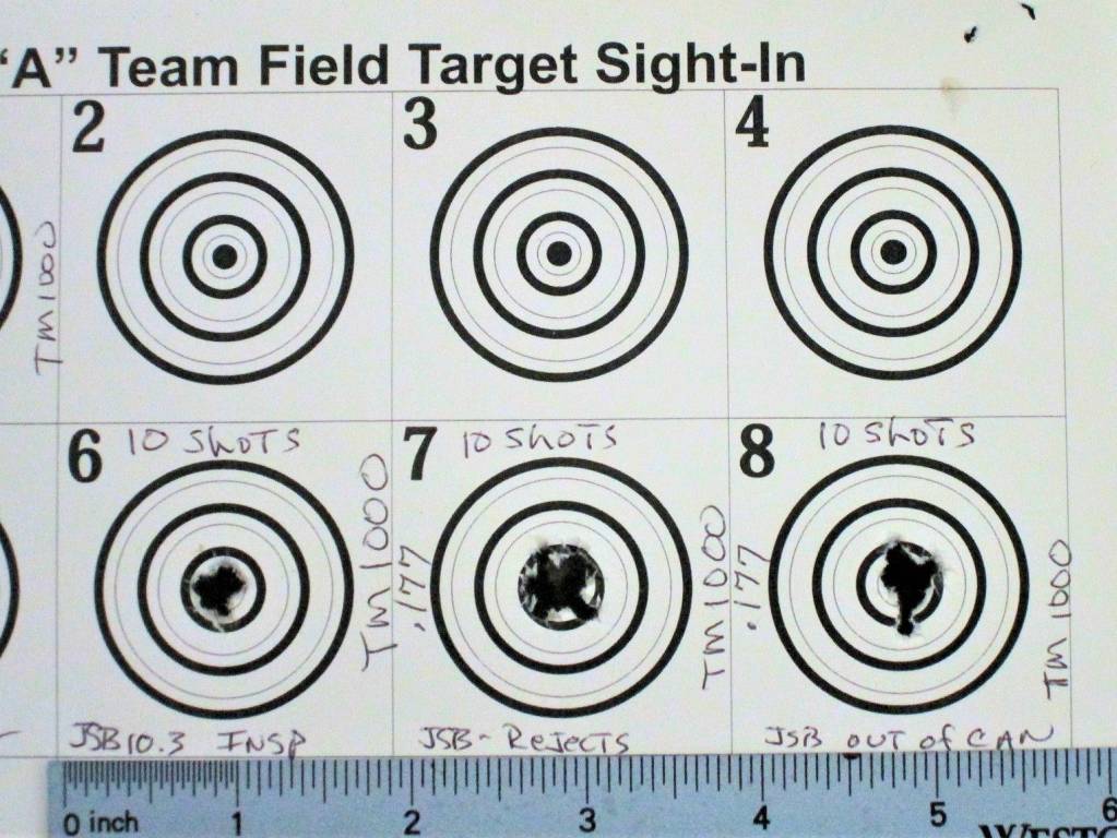

If you are into precision shooting, like benchrest, then a pelletgage is almost a must. You can't trust what's marked on pellet tins. Weight and dimensions vary and sometimes considerably. Here's a test I ran a while ago on some .177 pellets in my TM1000. As you can see, the inspected and segregated pellets shot better than the the rejects and the ones straight from the tin. Big deal you say? This could make the difference between a 9 and a 10 on your target. Winning or losing a match.
Without a gage, I can tell how pellet quality has suffered.. just slipping the pellet into the breech shows tight to loose, some almost fall in while others need a good push!! Been that way for years and not gonna get any better unless we are willing to shell out big bucks for sorted pellets. I have used what would be premium pellets for decades and never found really good consistancy from any!! As a precision toolmaker for over 50 years, I can tell you that "Lazer" accuracy means nothing, just a fancy term to make folks think super accurate....mechanical sizing tools still create the most accurate hole size !!!
