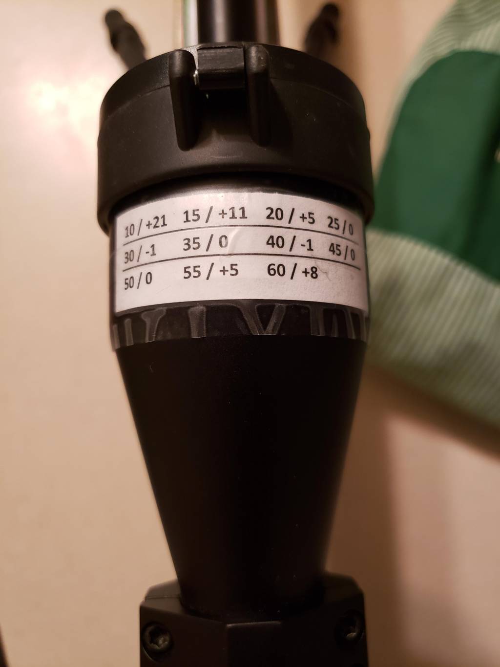

For the time being, I've just manually ranged the m-rod and have a piece of paper taped on the scope from 10 to 60 yards which is about this little guns operating range. I want to use it for upcoming small game season - squirrels, rabbits, etc . . . By manually, I mean I just setup targets at 10, 15, 20, 25, etc . . . . and figured out how many clicks up I need to hit bullseye at that distance. My numbers and strelok are NOT jiving though - not even close. Case in point - you can see in the accompanying photo that I have it shooting pretty flat between 25-50 yards. I'm flinging crosman 10.5's at a pretty fast 971fps - it's a pretty flat trajectory - and surprisingly accurate considering the speed. If I key in this same 50 yards into strelok - it has me dialing up 5 clicks. That's not even going to be a haircut going over mr squirrel - it'll be more like a low flying airplane. {sigh} ( lol )
