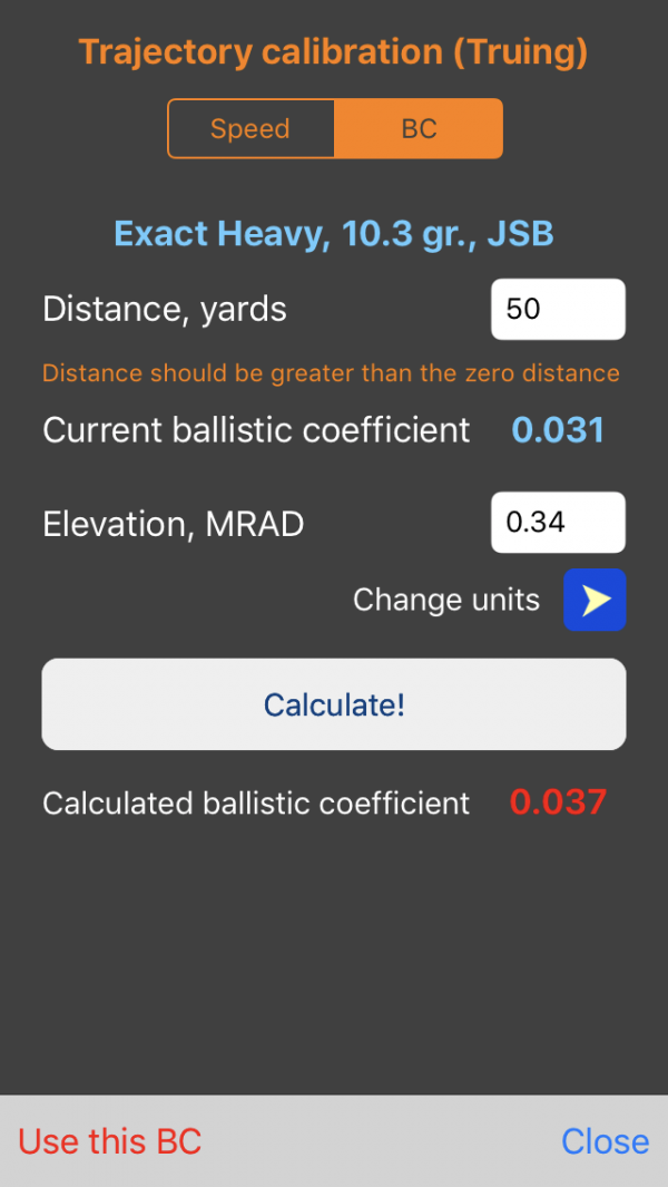

I purchased Strelok Pro about a week ago and after fumbling around for about 24 hours to figure out how to use it, I find it to be very accurate and a huge improvement over ChairGun.
The only feature I have not been able to get to work so far is the BC calculator. I have tried everything I know to try. I fill in the data and nothing happens. If anyone has a fix for the, I would appreciate the tips.
Even with that, it is well worth the money.

I assume you have all the info for the pellet you are using entered into the cartridge section. Click on the bottom right icon and you need to Click the BC tab. The pellet you are testing should be highlighted in blue and then shoot that pellet out past your zero yardage, so if zero is 50 yrds you need to go say to 75 yrds, shoot and measure difference from aim point and enter that for elevation change. Make sure you change units to inches and then click calculate.
Hope this helps and good shooting.

Have you selected the GA function for BC?Give that a try. For me anyway Strelok is much easier than chair gun. And spot on.

make sure to click BC

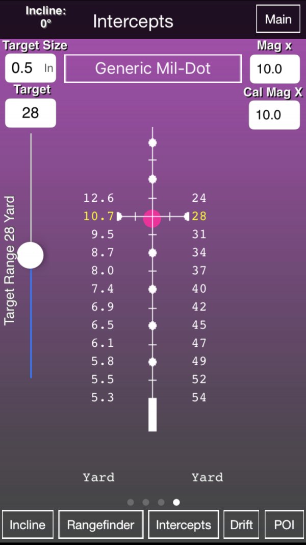

You dont have top re zero. Every ballistic app I have used gives you exactly what you just said they dont. I can open up strelok pro or BA or chairgun and pull up either a range card that will show me exactly how high or low my shot will be at 50 yds or I can input 50 yds and get a reticle view of where my shot will hit with my exact reticle I am using if using strelok pro. That data does not require a re zero or to have a zero thats set at 100 yds. Either you dont understand the ballistic apps or you are doing something wrong.

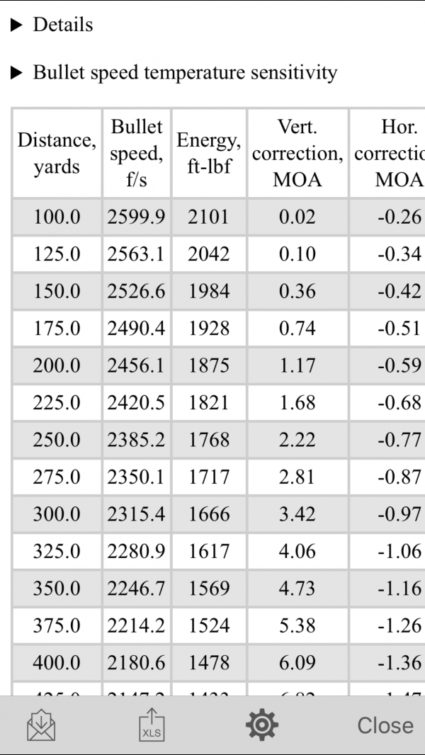

The manual for strelok pro says exactly what the vertical offset is for. You use the vertical offset to account for multiple loads in one firearm or for cold bore shots. Again you seem to be trying to take the longest most complicated path to find out what the drop is. If you know all the variables and have entered them then strelok pro will give you a chart from zero yards out to whatever distance you enter and anywhere from 1 yard increments to 50 yard increments. That chart will show you what the drop is in inches, moa or mrad at the yardage increments you select. The range cards in strelok pro are way better than chairgun in fact strelok pro is much better than chairgun.
Heres a pic of the chart in strelok pro:
