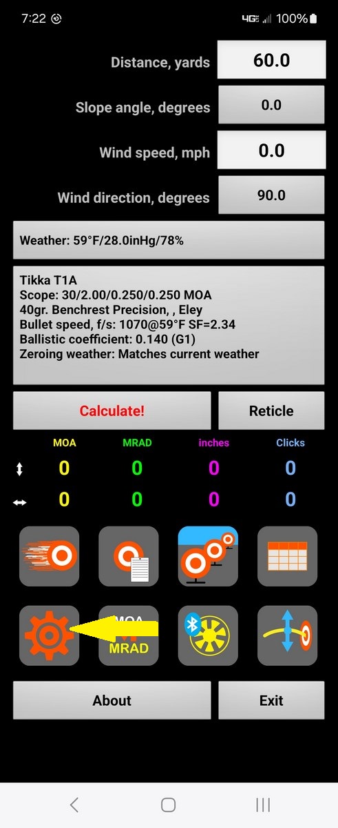

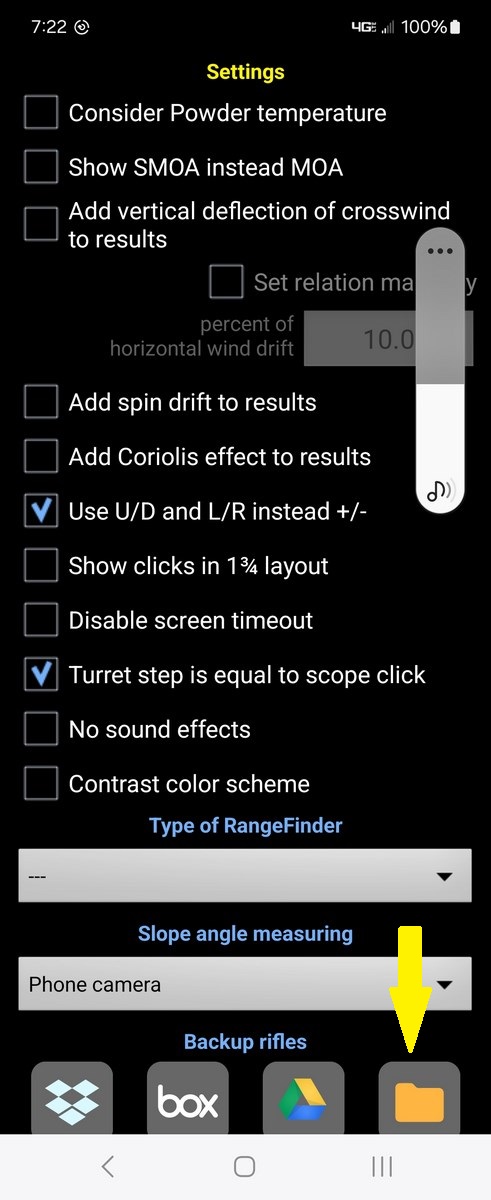

From the main screen:
Go in to settings - the little gear thing at the bottom left of the main screen

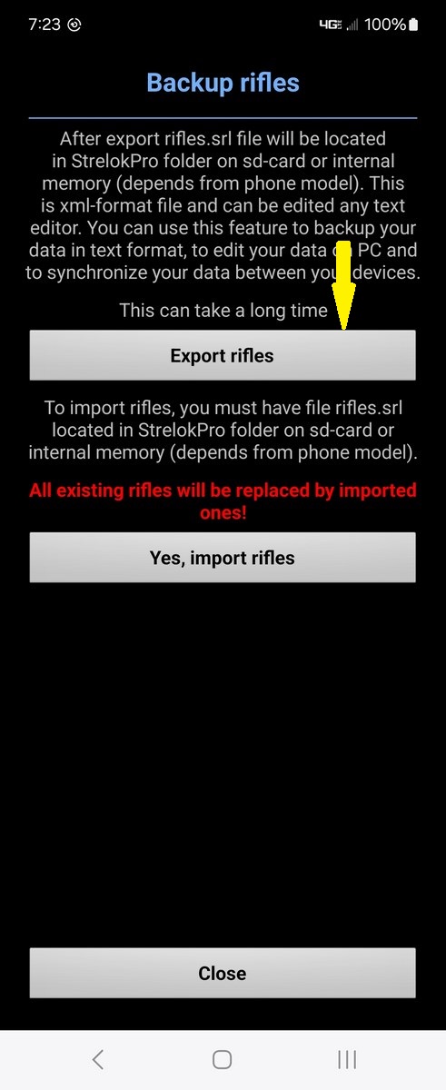

Scroll down to "backup rifles" and pick drop box, box, google drive, or the file icon. The file icon only lets you export to a file on your phone, I believe. Then you can download it to your computer. Pay attention to the folder that the files are downloaded to, as it may be hard to find.
You can then copy to your computer, or backup to the cloud, if you have that option.
Remember though, if you restore the rifles, it will overwrite any changes since the last time you exported them.

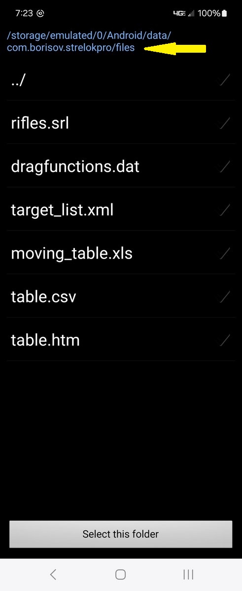

Here is where the files are on your phone as shown in explorer for windows. Your screens may be different

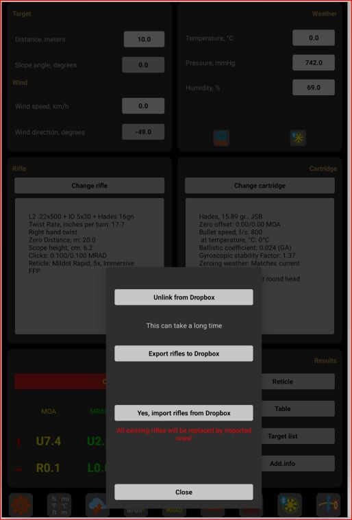

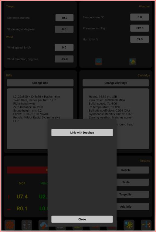

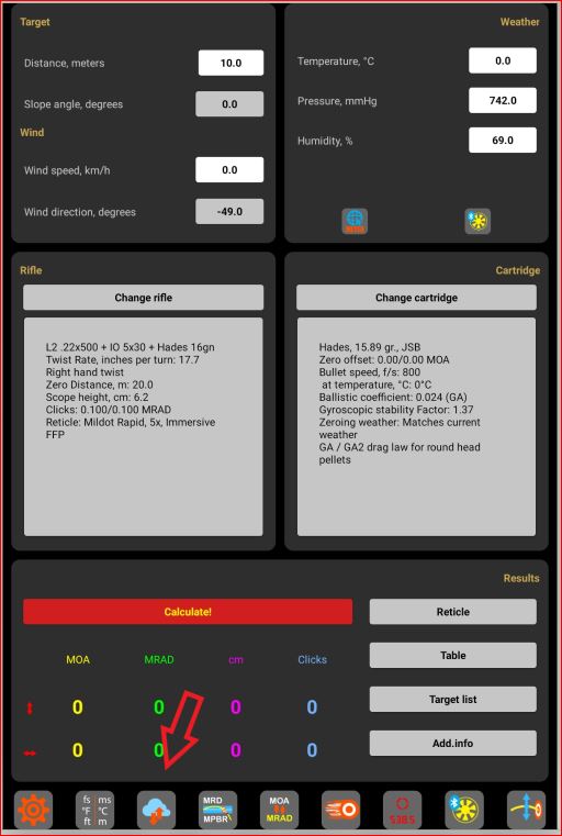

I don't know how the GUI looks like on a cellphone screen but this how the SP version 7.1.6 looks like on a tablet screen (before I made a Dropbox account)
After I installed the newly created Dropbox on the tablet, more options opened up.
I made my first Export, and checked the file in my PC, for now looks OK, but I would need to play more with DB to see how much is different from google Drive.

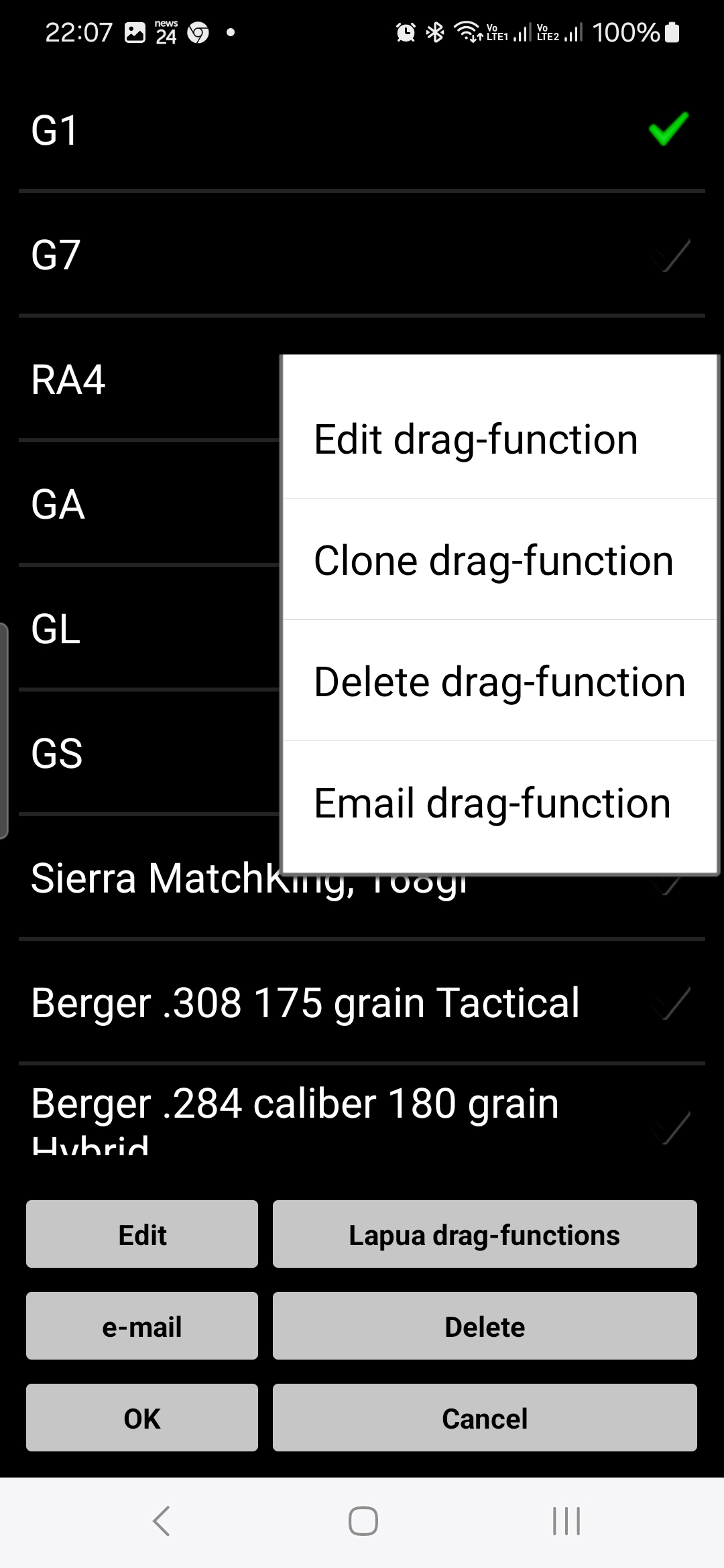

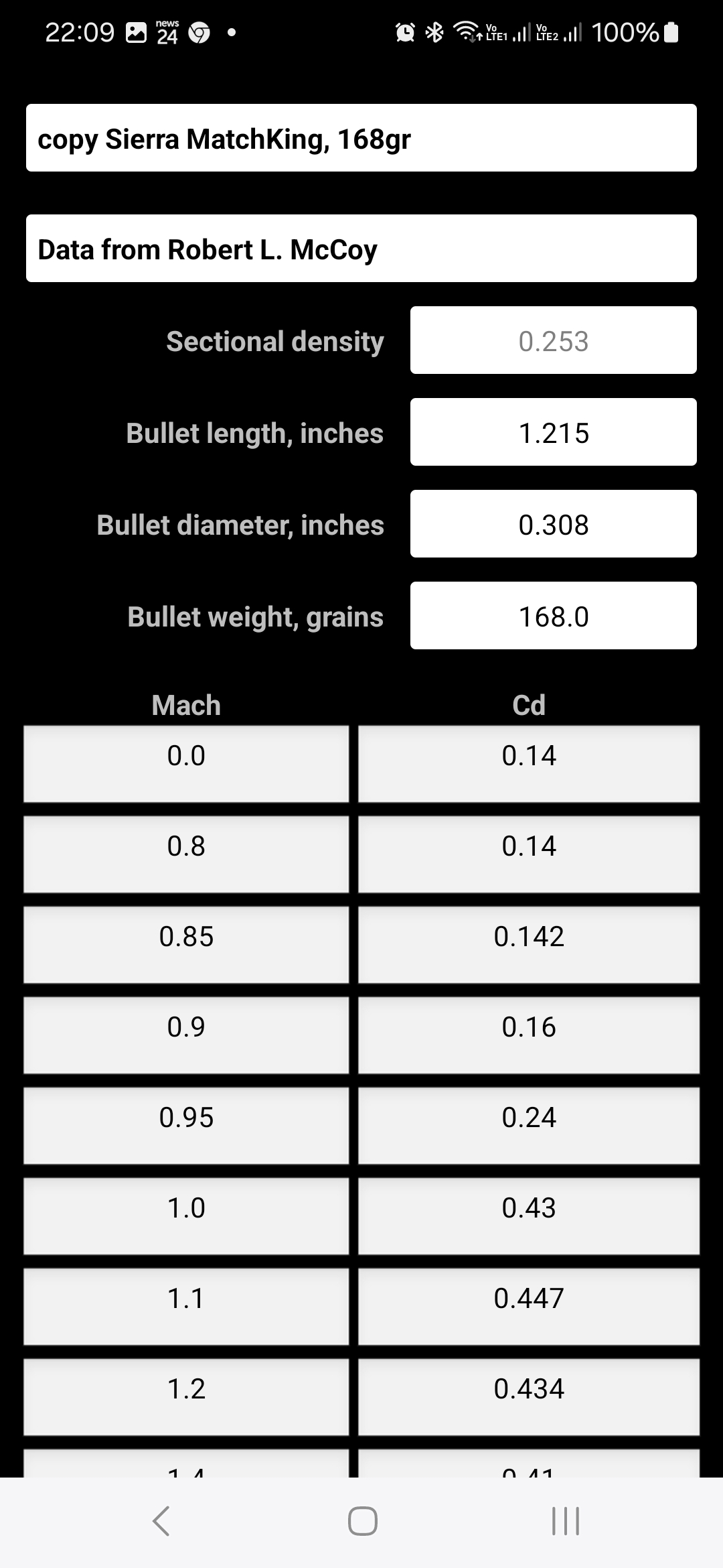

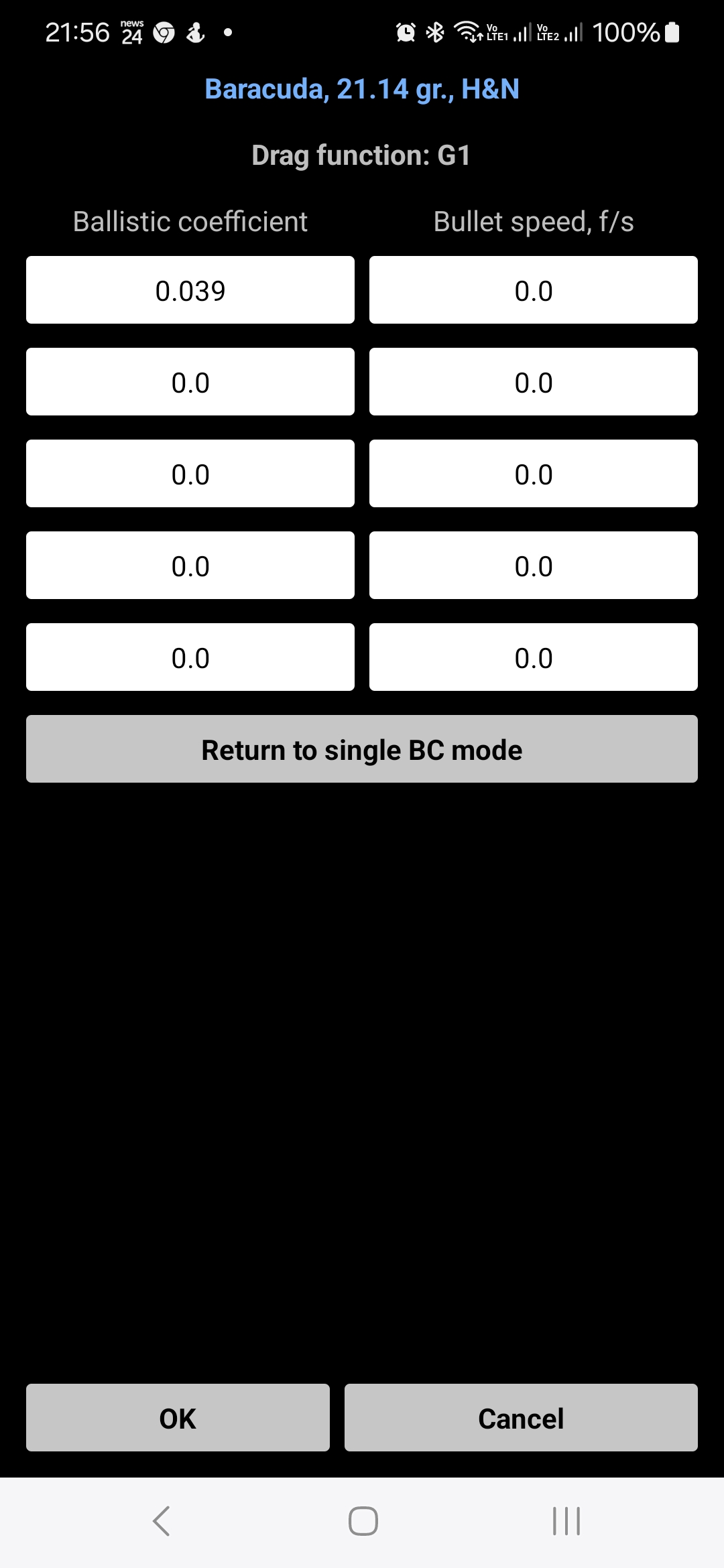

Because I can't update my version — and things just don't seem to work with the custom drag models.
So far I have been using the 5 different velocity-dependent BC values (what you referenced earlier) — but I'm getting into some wadcutters and hollow point pellets that I want to shoot at excessive velocities for their shape — and that seems to require a more refined approach.
