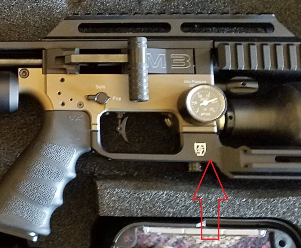

I removed the Arca 2 rail/trigger guard off this gun to get to the rear reg adjuster. One of the 4 screws stripped out when I went to tighten it.
The screw looks like it lost some thread on the very end. I'm hoping the screw went and the threaded hole on my M3 is intact.
Do you think this will be the case? ...like are M3's always harder than screws?
It's one of the front screws that holds the trigger guard on. 3 screws definatley won't hold the rail.

I got slighlty longer screws with some tiny lock washers to fill any space. I will use that info for sure form now on. Thanks! -Nate
