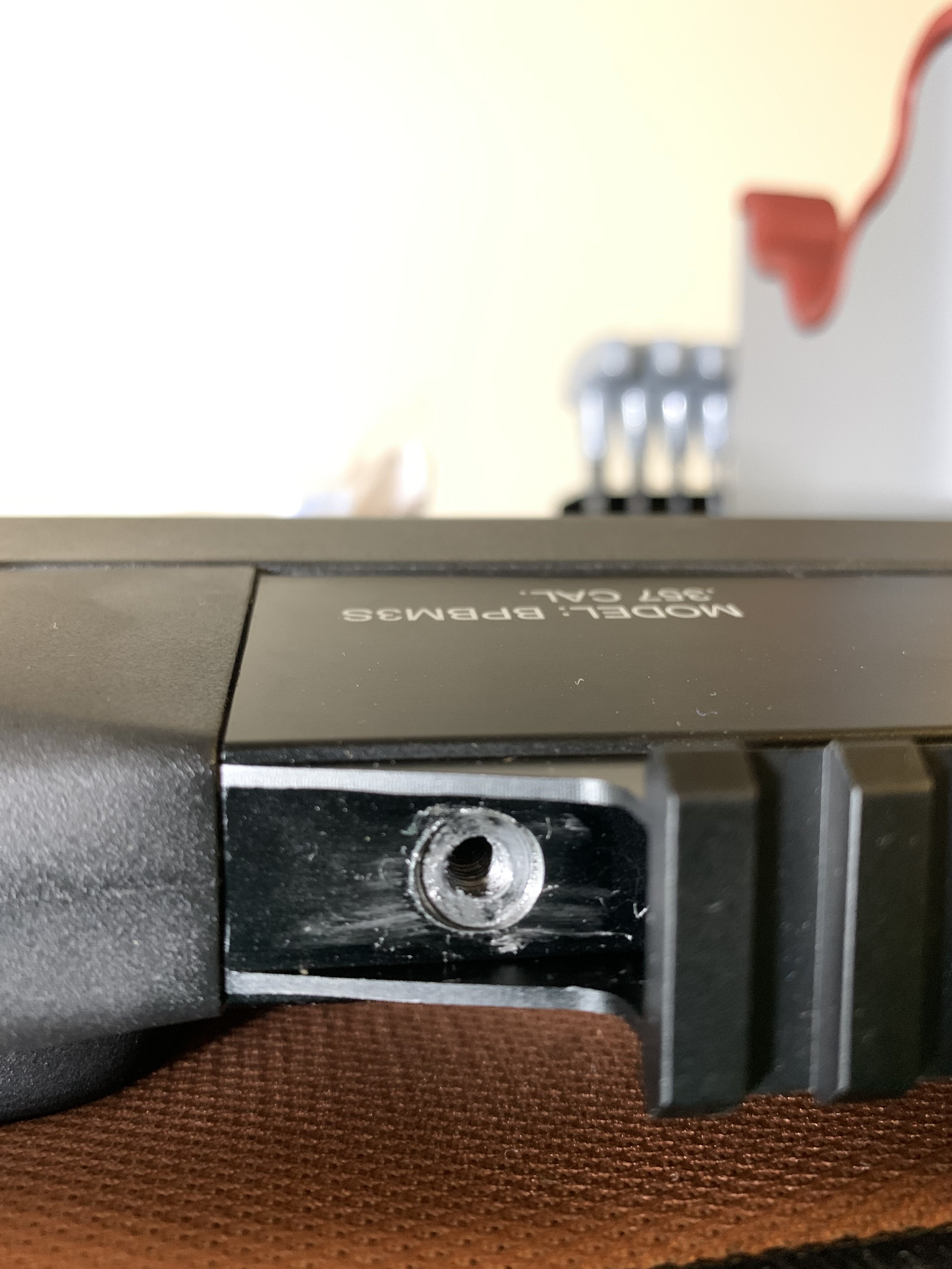

This time on my new M357, I was attempting to disassemble the rifle to install a depinger and pic rail adapter. When I got down to the last few screws, one was stripped. I cannot remove the shroud without removing the screw pictured below. This is a PITA

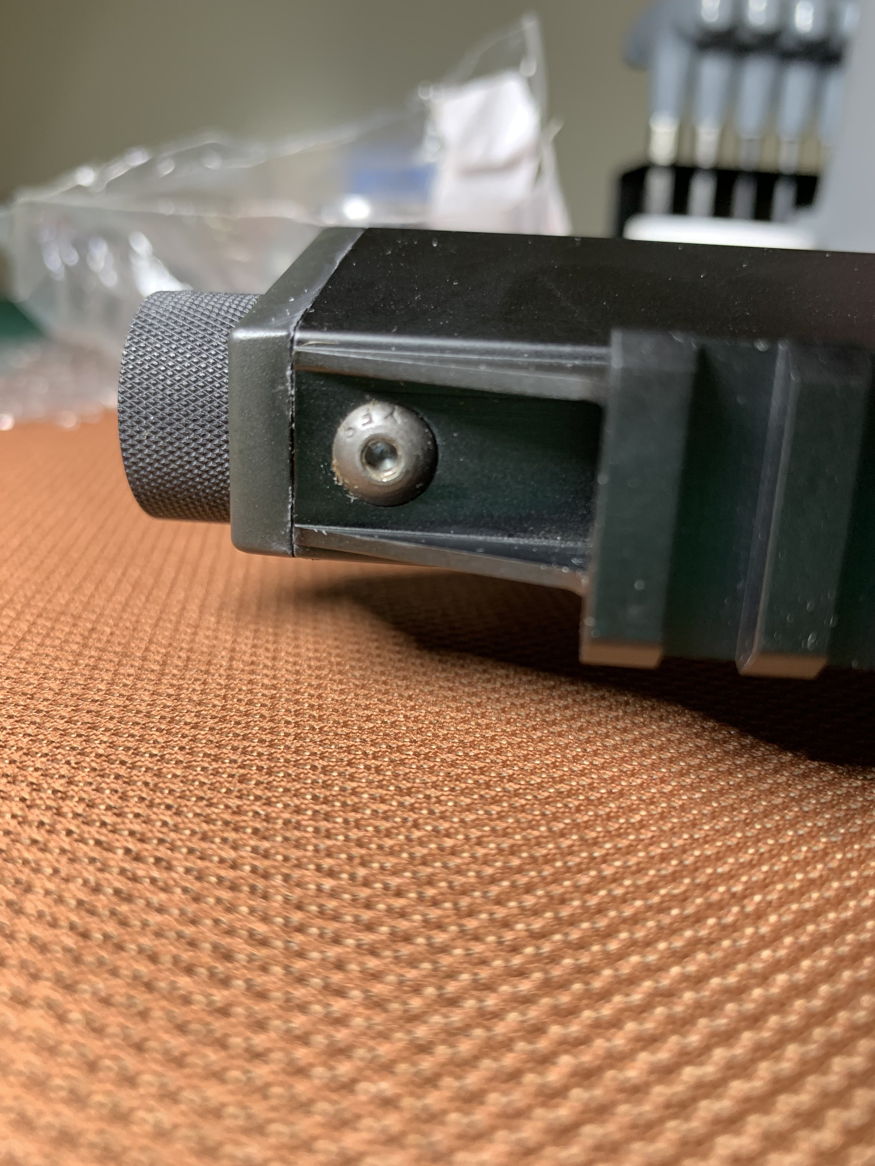

The one toward the breech removed easily and here’s how the shroud looked beneath and around it.

id suggest checking some easy outs.. might find one close enough to just tap into the stripped out head and unscrew it.. well that's what I would do.. yes a lot of trouble trying to cut slots in screws.. is it possible that you are using metric Allen wrench instead of American Allen, or opposite? I once stripped a bolt, looked like a Allen wrench but it was a large torx.. I can't tell the difference without glasses and good lighting

@markhooper I didn’t strip this one. It came to me this way. The other two were removed with the same tool no problem.
See if there is a torx bit that will tap in with a hammer. That has saved me a couple times. Then chuck the thing and buy new bolts.

@Healfhservices I may have to try that eventually.
