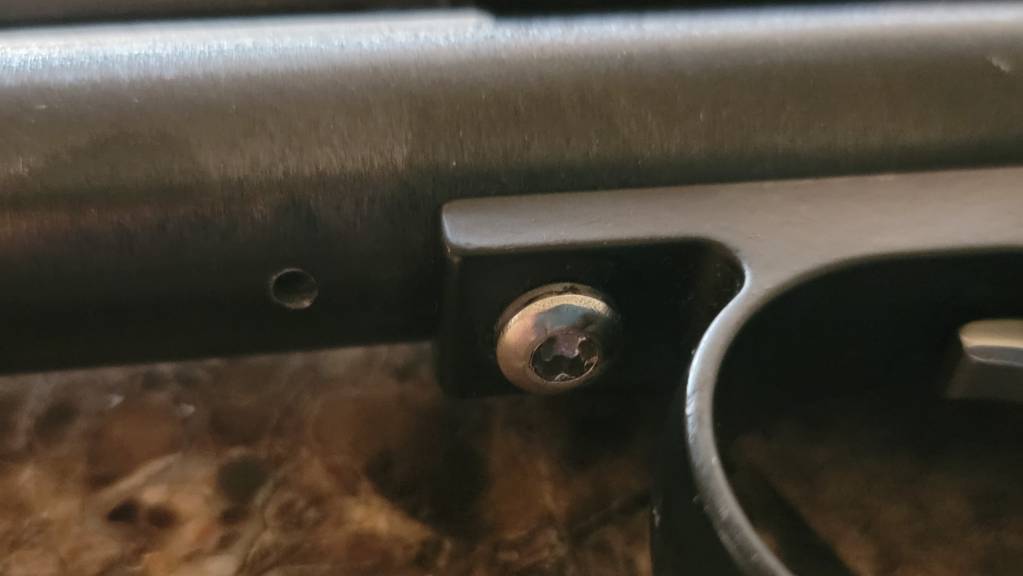

Since I did destroy an air tube (enuf hammering to bend) that wouldn't come unstuck. I came up with a emergency backup ejection system. Hopefully I never need it. With my hipac, no need to worry about air tube being converted to hpa.
