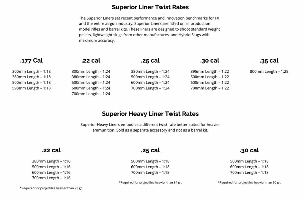

Stx superior liner VS superior heavy liner?
FWIW I use normal superior 500mm in my FX Crown for 25gr slugs. Accuracy is perfect.
Ive orderd a superior heavy from huma to replace my superior liner in my .25 crown.
What is the difference in those 2 liners except mayby TR? Ive read several places that the .25 heavy liner can Come in different TR so I Dont know what I get yet. But are there any other stuff to ?
I ordered a Superior Heavy .25 700mm from The Pellet Shop a week ago and arrived Saturday. Hoping I would get the Heavy 1:18, nope got the STX Slug Liner 1:16. I contacted TPS today and they stated FX changed from the Heavy 1:18 to the Slug 1:16. Was hoping to get the Superior Heavy 1:18 to shoot pellets as well as slugs. I wish they would have sent a notice that they changed Liners. Can't send back, non-returnable. :(
Mine came today and is 1:16 as well.
