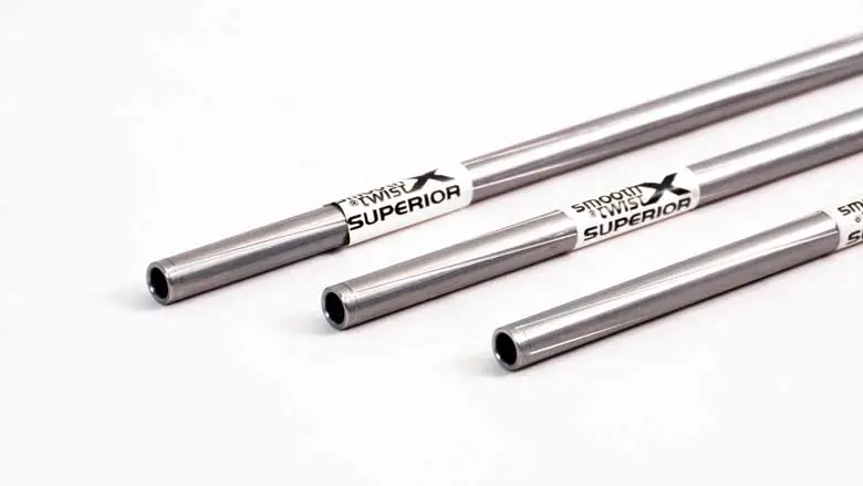

Fx STX vs Superior liner (according to me!...).
*STX = Rifling are little deeper, from chamber to muzzle end grooves are uniform and end abruptly (bore are choke), the pallet flight takes the shape of polygony impression.
*Superior liner= Chamber ends are totally round which resize the imperfect sized pallet, muzzle end also round (but not flare) which send off the pallet in full round contour (instead of rigged rifling mark around the pallet) which may be better aerodynamic in flight, the round segment end do not disturbed the pallet spinning patten because it's just a segment of ring at the very end.
Verdict is till now no one really knows what barrel is better than which, but their approach of Superior liner is something. At least that exact can't be reproduced in a solid barrel type except in metal tube reshaping process which FX liners are doing (let's just say they're taking full advantage of their innovation :) )

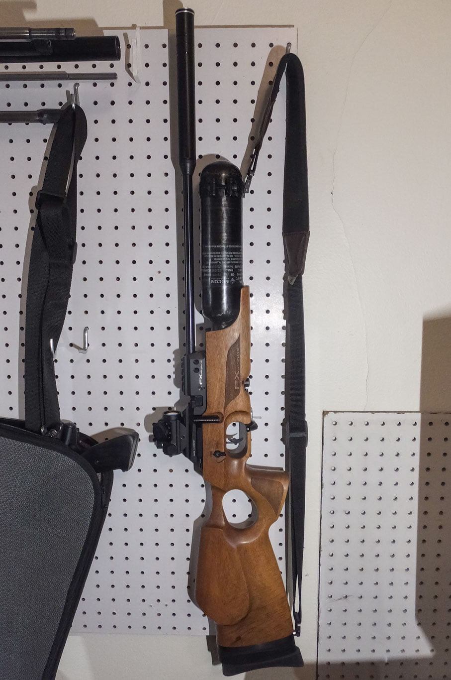

Fwiw I have st, stx, and superior barrels. Here is the ST on my Crown. It is an old mk1 impact take-off. Pre-dates the Crown, but fits it at least in the areas that are needed for it to function correctly.

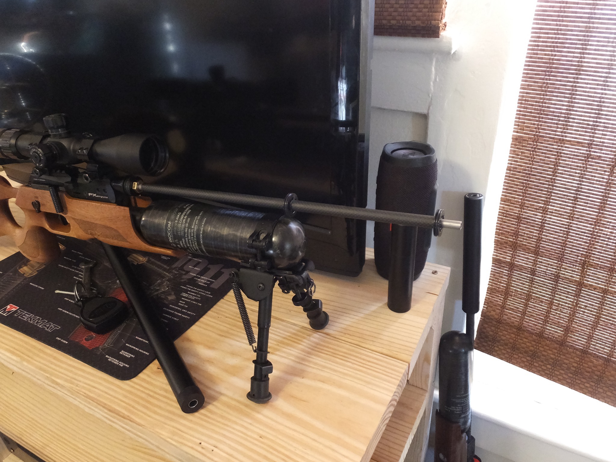

For instance, my 30cal barrel is a normal stx barrel. The entire shroud extends and has an air stripper inside of it as well as an expansion chamber that opens when extended. Actually pretty effective for moderation. So effective, I've never fit a moderator to it. Both my stx .22 barrels are superlights. Shroud is fixed, does not extend. Has no air stripper, just a thread adaptor and protector.
Here is under the shroud of a superlight, has carbon reinforcing tube bonded to liner, doesn't come this way.
Here is the older type extended. Don't have any photos of mine extended or opened up.

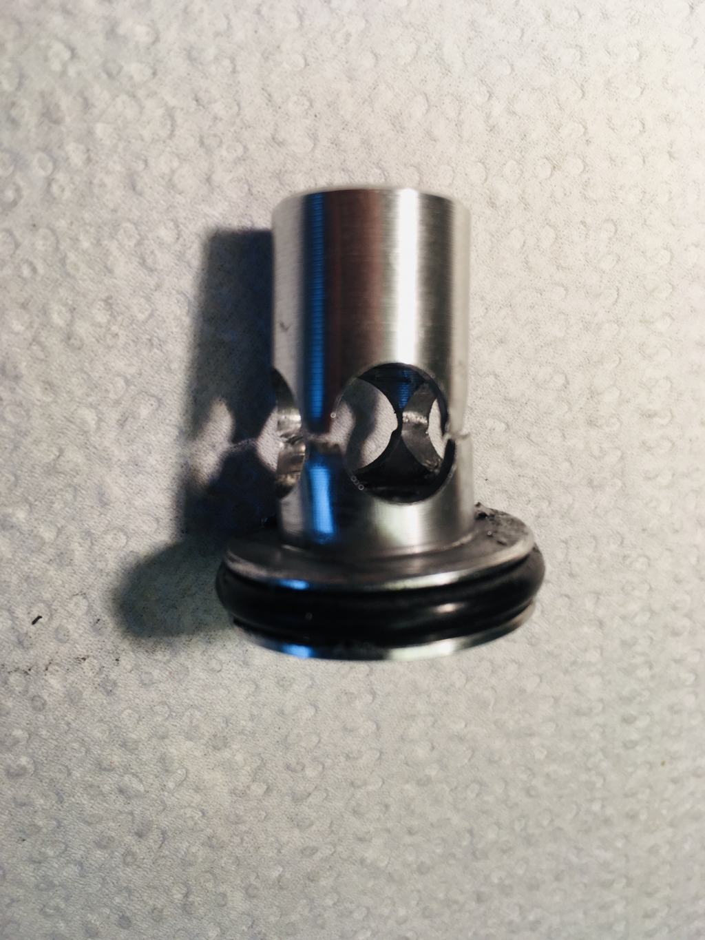

IDK to be fair. I'd assume they all work, but I'd choose larger holes. The importaint part is a small hole for the projectile to pass thru. Moderators act as air stripper as well. Only photo I could find, and it's broken (not mine) but this is what's inside the shroud. View attachment 440792
👍.. That's the one with space gap, I'll do the other way 20Unf male front, 20unf female behind, shroud cap thread around
