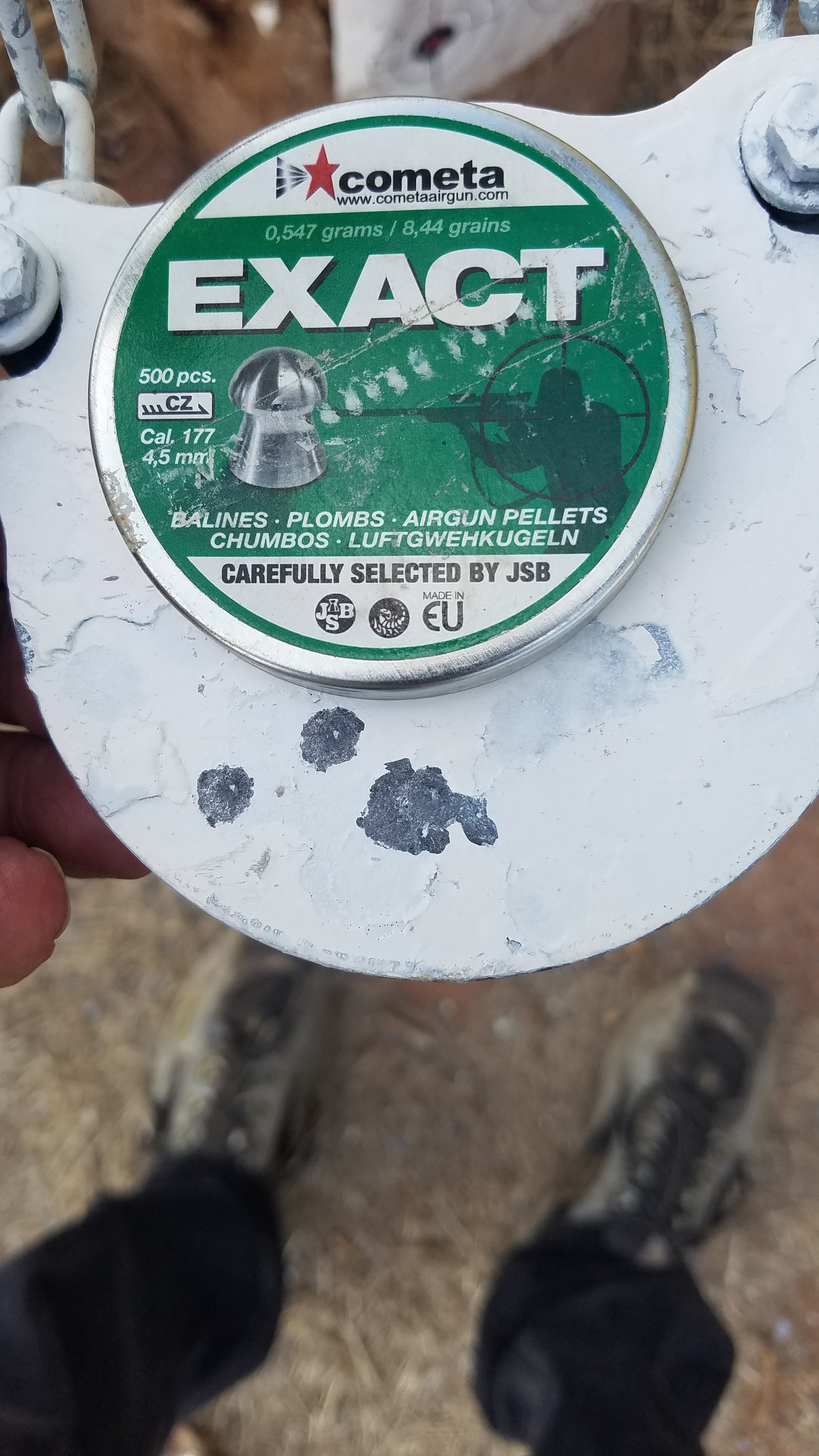

To that point, a friend approached me about seeing what could be done with his Steyr LG100 to make a good 12 ft lb shooter. I had happened to have a 20 year old LG100 barrel that seemed perfect except for a tight breech. I lapped it carefully and it tested as good as anything I've ever shot... 1 small hole at 50, over and over. Keep in mind, sub 12 ft lb but also nice conditions. Just for grins, I shot a group at 100...
The first 3 went in there on top of each other, then I could feel a very slight change in the drift, so held a little and saw it go a little left. The fifth had a little more change so I held a little more but still went out to the far left. Just one group and no question there was luck involved but man... what a good little shooter that was.
