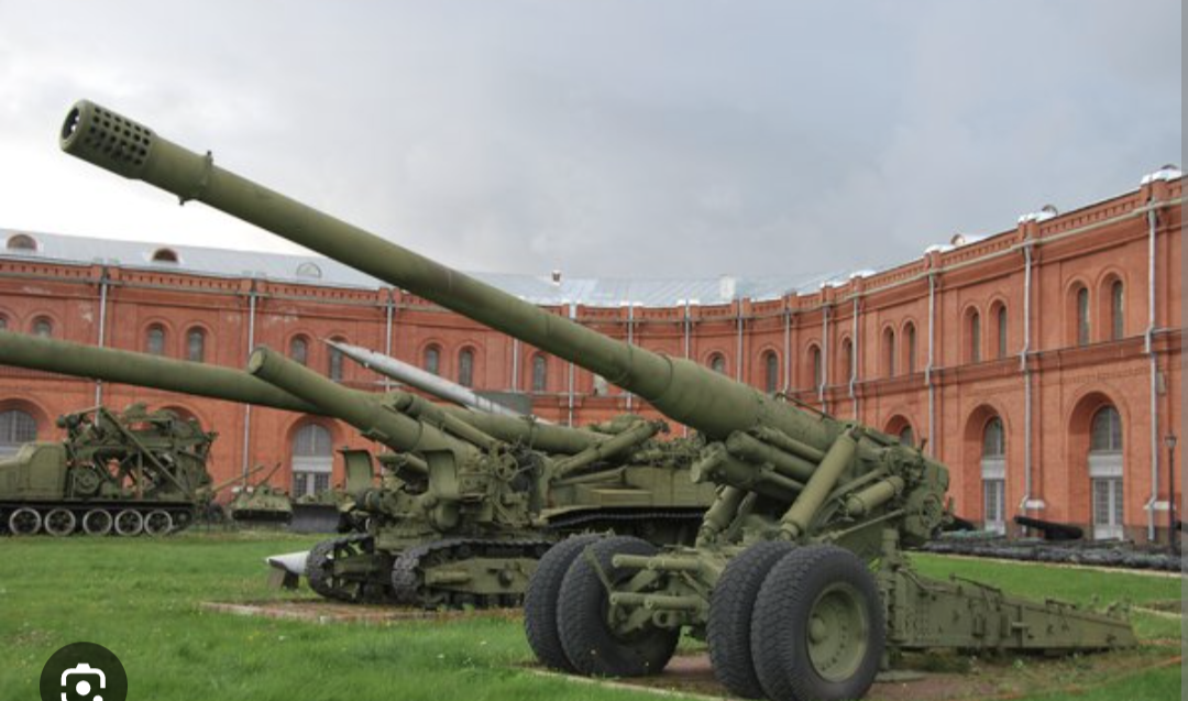

You could get away with tapering the barrel down towards the muzzle, if you left and inch or two long section at the original OD, right at the muzzle. Many German guns that were made over a 100 years ago had such a reinforced muzzle look, after tapering to a thin walled OD; even if it were not done for a choking purpose (image below).
