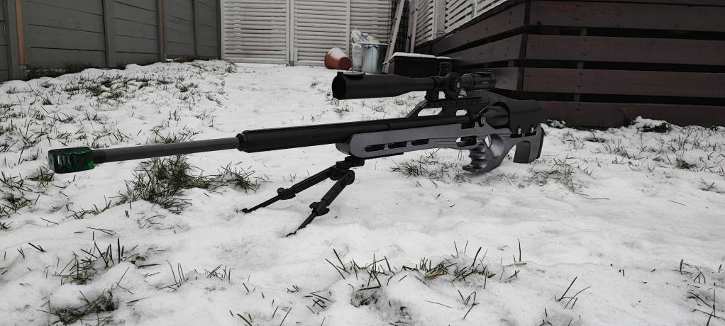

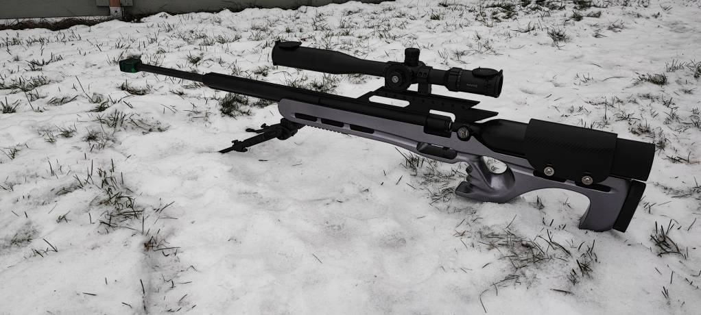

Adding a stock to texan platform is kinda needed to get everything out from it at extended ranges. Cant go wrong with 257 if single shot isnt a problem.. best accuracy is achieved with external reg feeding gun.
It dosent really feel that weird to shoot with solid stock.
