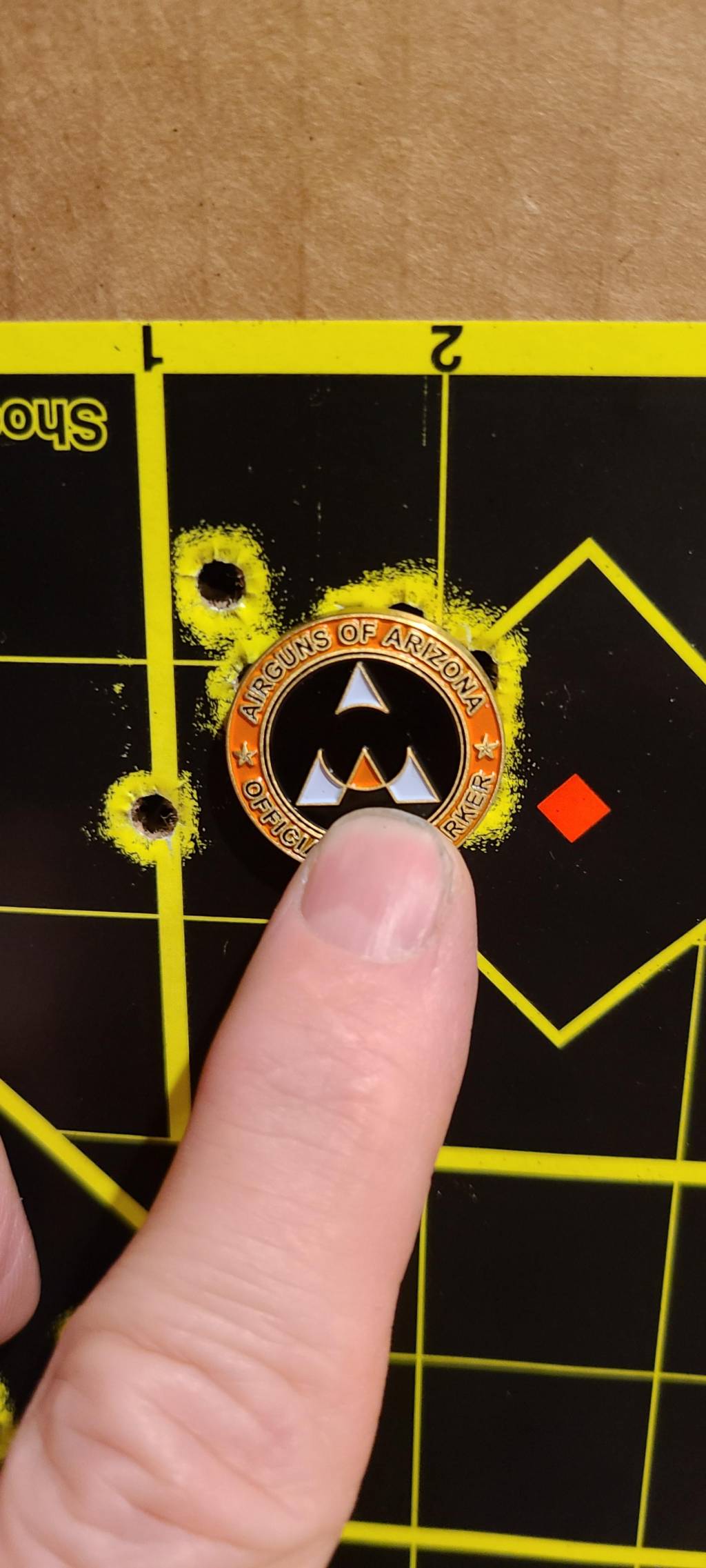

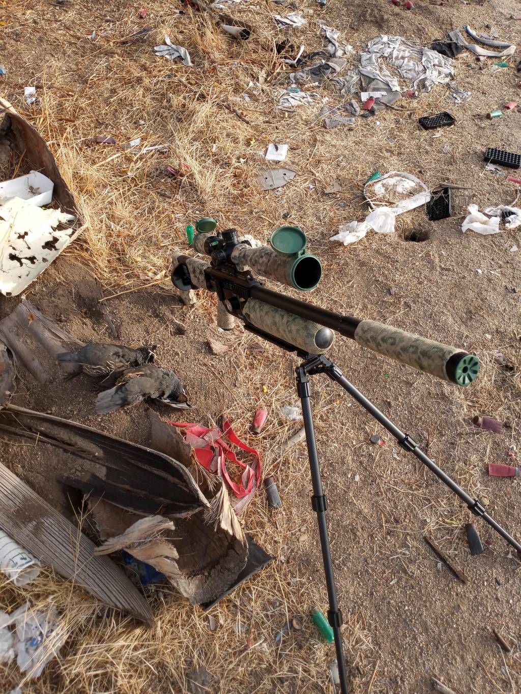

I hope your wrong. I'll be testing 54 gr this weekend. Like I said all slugs were shooting every where exempt 54 gr. Hammered two quails. One 30 yards and one 50. Elevation was about the same .shot group less than 1/2 inch. Not shooting from table.50 yards. Glued liner with anaerobic rtv .sorry sealant.. people keep dumping trash here.

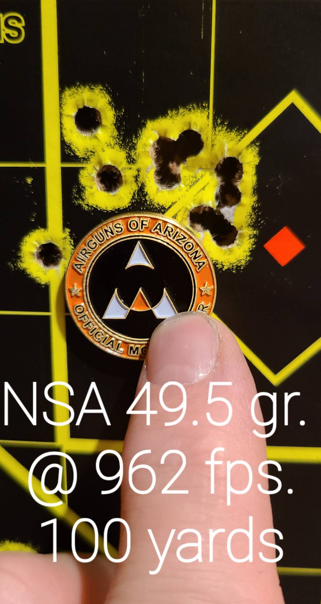

I shoot the NSA 49.5gr. through a 700mm superior liner 1:22. I have bumped the speed up to 980fps just to put a little extra smack on prairie dogs .
https://youtu.be/O8Z7GB7vxkI
https://youtu.be/90_1g8JAFSM
This is 88 yards shooting in my yard .
I copied Matt Dubber tuning method. I do have a MKII but it shouldnt matter for your M3 maybe a lower 2nd reg pressure.
A small burst of 155 bar air is what I did.

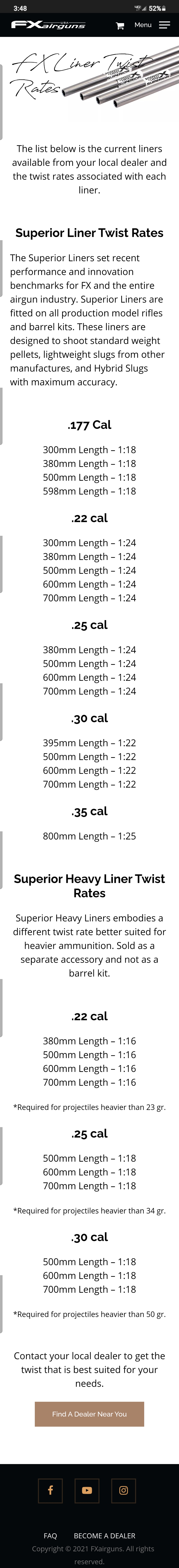

Another note on barrels - everyone needs to pay close attention not to the name, but actual twist rate of their .30 superior barrels since twist rates have changed 3 times. The first .30 Superior barrel was 1:40 or 1:37. Then later, the first standard hybrid liner was introduced at 1:26 and the heavy liner at that time was 1:22. Not long after, the standard liner was changed to 1:22 and heavy liner to 1:18. We still have the 1:37 liner also, but it is now called 'slow twist pellet liner' or something. What I suspect happened was that the 1:26 liner wasn't stabilizing the hybrid slugs at anything but really high speeds (which is what some initial user reports on the hybrid slugs were saying), so they dropped it to 1:22 to work across a wider range of speeds. Who knows what slug weights are best for the 1:18 heavy now. My 1:18 liner did worse for all slug weights up to and including the new NSA 54.5gr, so maybe its a bad liner or maybe the 1:22 is good for a wider range than expected?
