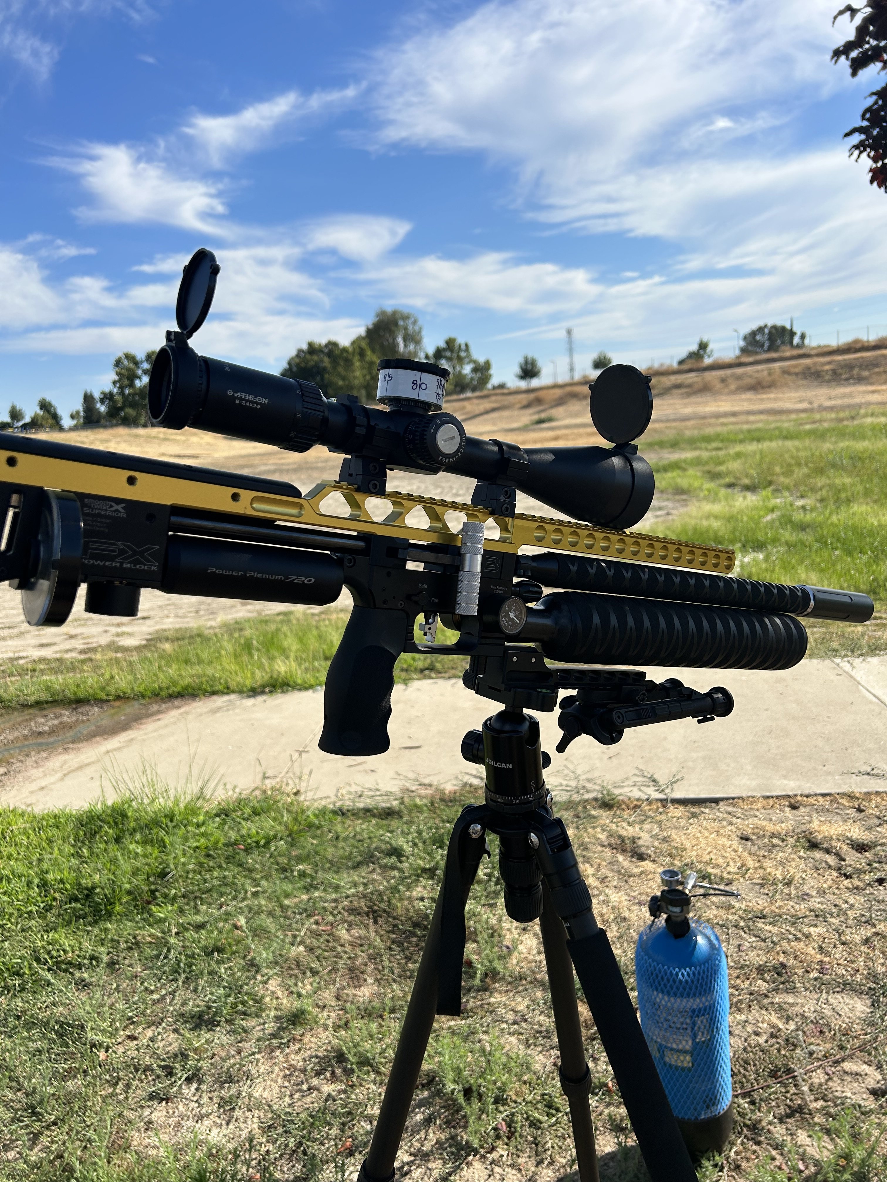

I have been shooting 47.2 nsa 30 cal and have a great
turn out it’s all about the tune shooting at a little over 1000 with a 700 mm barrel
