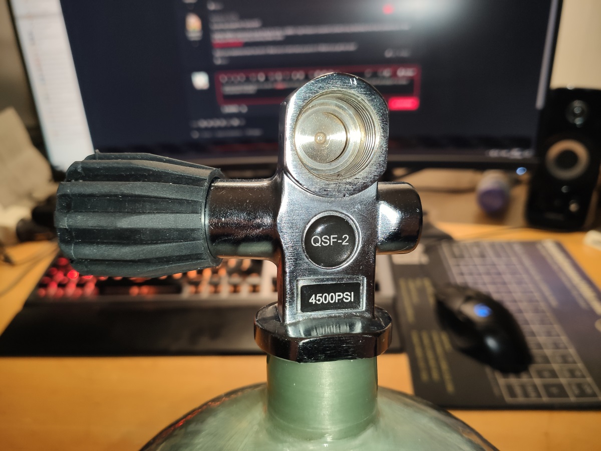

I just put some Chinese valve on my new 9 L Acecare tank, that part dont do it much for me, well unless it start to leak CUZ i never use a plug on my tanks.
The valve seem OK quality, came with adapters for any of the 2 kinds of connection.

I too bought a Tuxing 6.8 tank and I'm putting a SCBA valve on it so I can fit a Stikman fill system on it. I have my own compressor.
