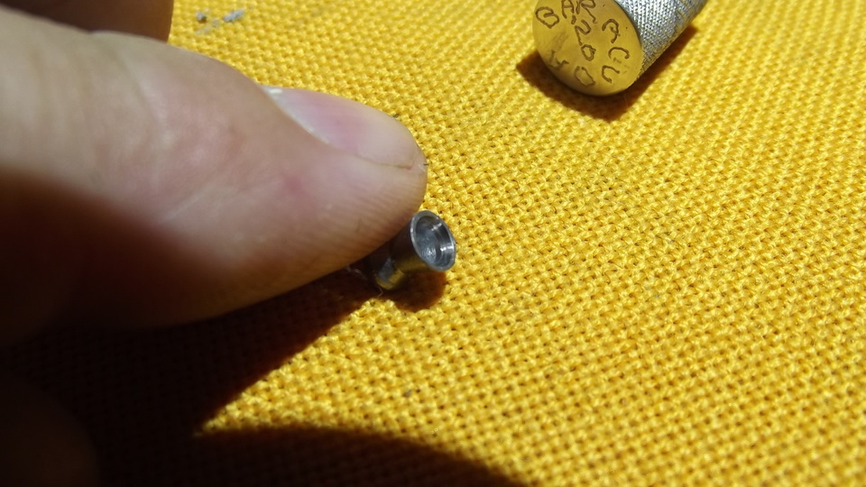

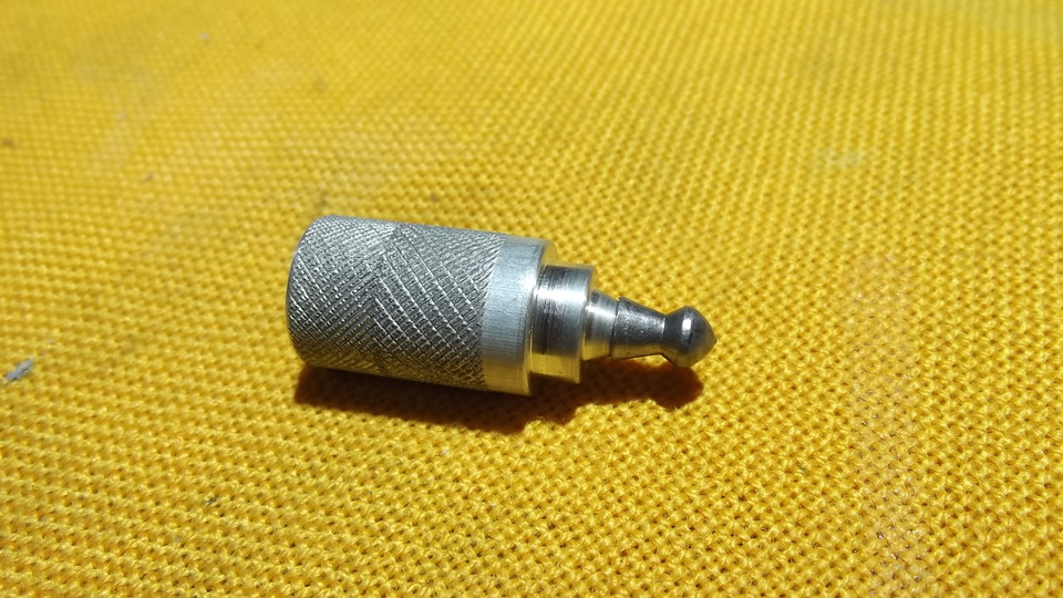

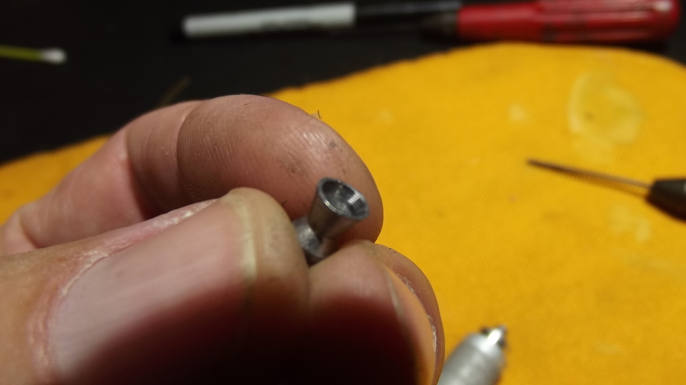

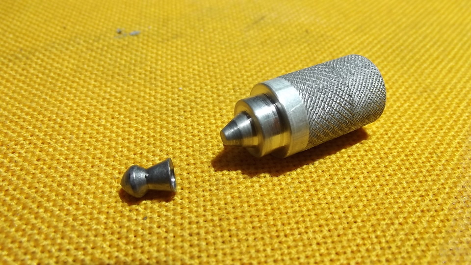

By the way, I studied that pelseat image you posted a while back and have to say I reversed my opinion. That is a very good design and you might consider marketing it (or maybe building a 3d template of it for printers and printing them of something like PETG).
That image IS NOT one of a pellet seater, but one that is of a TOOL that accurately Trues up and Straightens out a pellets skirt profile. Each tool is make for a specific pellets skirt tail angle, depth and diameter / caliber.
For if a pellets skirt DOES NOT fold in evenly as it loads into barrel, YAW is created and pellet will wobble all the way down barrel and fly weird all the way to POI.
This is for most AG shooters EXCESSIVELY NEUROTIC .... agreed, but for those who want the highest consistency potential another trick in ones hat that may for some shooters make a difference ? * This tool IS NOT a flaring devise !!!!!!!!!

Sadly when these @ 5 different tools were made for those pellets being shot, it was done as a ONE OFF exercise on the metal lathe.
Paying no attention to actual Degree's, the compound was bumped progressively, cuts made until such time the angles matched each pellet type & caliber by FIT and not a measured or documented angle. The TIP of the taper BLUNTED to be JUST SHY of contacting the floor of the pellets skirt cavity.
In using said tool, push too hard creating a flair the tool bottoms out preventing it. Like stated .... NEUROTIC endeavor absolutely !!

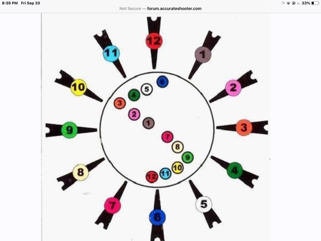

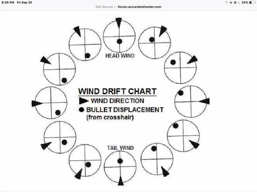

This wasn't a perfect comparison, but check out the list titled "Wind Deflection:" on the second page, about 3/4 of the way down.
https://www.airgunnation.com/topic/bsa-gold-star-union-jack-in-177-ongoing-review/
Did a comparison between a couple barrels, one of which was the polygonal barrel in my field target gun that has proven to be exceptionally wind resistant. Measured BC was very similar but the meta-analysis of all the shots and how far they were from the aim point suggested that pellets leaving the poly barrel would get pushed less (horizontally) than pellets leaving a 12 land and groove barrel.
Yes there were some flaws in the design of the comparison, but some data is better than completely unsupported claims.
Wind drift chart above is for Slugs. Pellets are the opposite.
