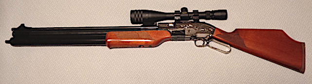

Hello i recently purchased a used sumatra and it was holding air fine, then after the second time i put air in it start to leak very loud from the receiver right at 2800 psi then after a couple shots it stops hearing it but the leak continues slowly i fill it up at 2800 put it away and after a week is down to 1900 psi, i am a little hesitant to get t apart just because don't know what the problem may be, is this a comment problem on sumatras? someone knows what the problem may be ?

Have you addressed this issue with the seller? Hope so! I would return it if I were you. I have never heard of such a thing as you describe. They're reliable and typically the quick fill port leaks that's why most folks change them out to the Male Foster fitting. The Sumatras are super easy to work on yourself unlike many other PCPs. Try cocking it then turn the power wheel all the way to the minimum and fill it. If it's difficult to turn that wheel all the way apply more tension to that cocking lever while fully cocked and click it all the way down till it won't go any more and if it still leaks after filling then it may be a simple fix and we can proceed further if your seller won't do the right thing which he should.

the problem sounds to me like the poppet has debris in it, may have a piece of metal shaving or plastic that's causing the problem, that's where I would start.
put a balloon on the end on the barrel with end cap removed, use a rubber band wrapped around the balloon to make a good seal on the barrel, With the gun cocked and unloaded, breech closed, fill the gun with air to max fill, let set over night, if the balloon fills up with air, it's the poppet.
