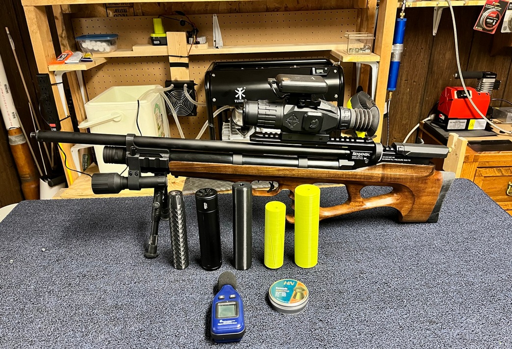

Slow morning for me so I decided to mess around with a cheap dB meter and some moderators.

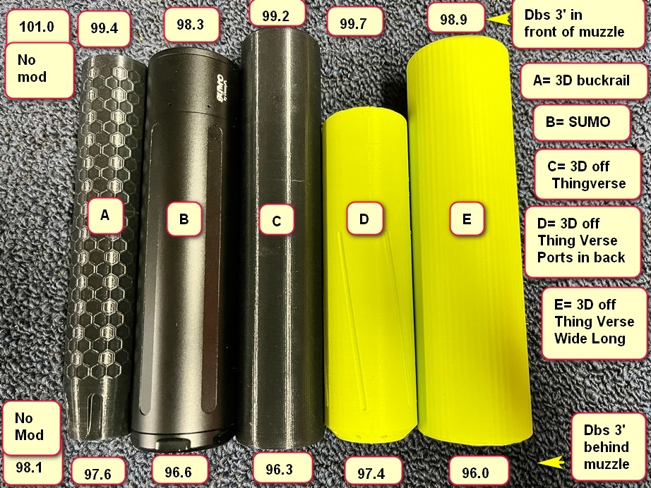

Here are the results I got using a .177 Akela @ 810-820 fps with H&N Barracudas 10.65g, indoors in my basement, shooting into duct putty. Readings were a average of a 5 shot strings. A inexpensive Amazon dB meter was used. It was placed approx 3' in front of the muzzle and then retested 3' behind the muzzle, close to where the shooters ear would be.
I was using up the filament that I had on hand, that is why some are yellow in color. The 3D printed moderators (except the Buckrail) were random free downloads off thingverese. Hopefully soon I will be able to design my own airgun accessories.
The SUMO won if going strictly by the dB reduction. Other things to consider I think would be cost, size and quality of build. Is a couple decibels reduction and better build with the SUMO worth 5x or 100x the cost of the others? I guess that is up to the individuals budget and taste. Also accuracy of each moderator was not factored in.
The dB reduction does not seem like a lot but it was very noticeable to my ear.
Could you post some links to the thingiverse designs? Curious to see what the internals look like. It looks like you're printing the entire moderator?
The ones I printed were 1 piece units but there are a variety of styles
If you search silencer or moderator https://www.thingiverse.com/ quite a few come up.

Thanks, yeah, I've seen them. Generally I think these kinds of moderators would be more efficient if you print a monocore, and slide the monocore into a carbon fibre tube. It makes the construction more complicated as you'll need appropriate o-rings. But the monocore design is a lot easier to clean-up after prints, and gives you quite a bit more design flexibility.

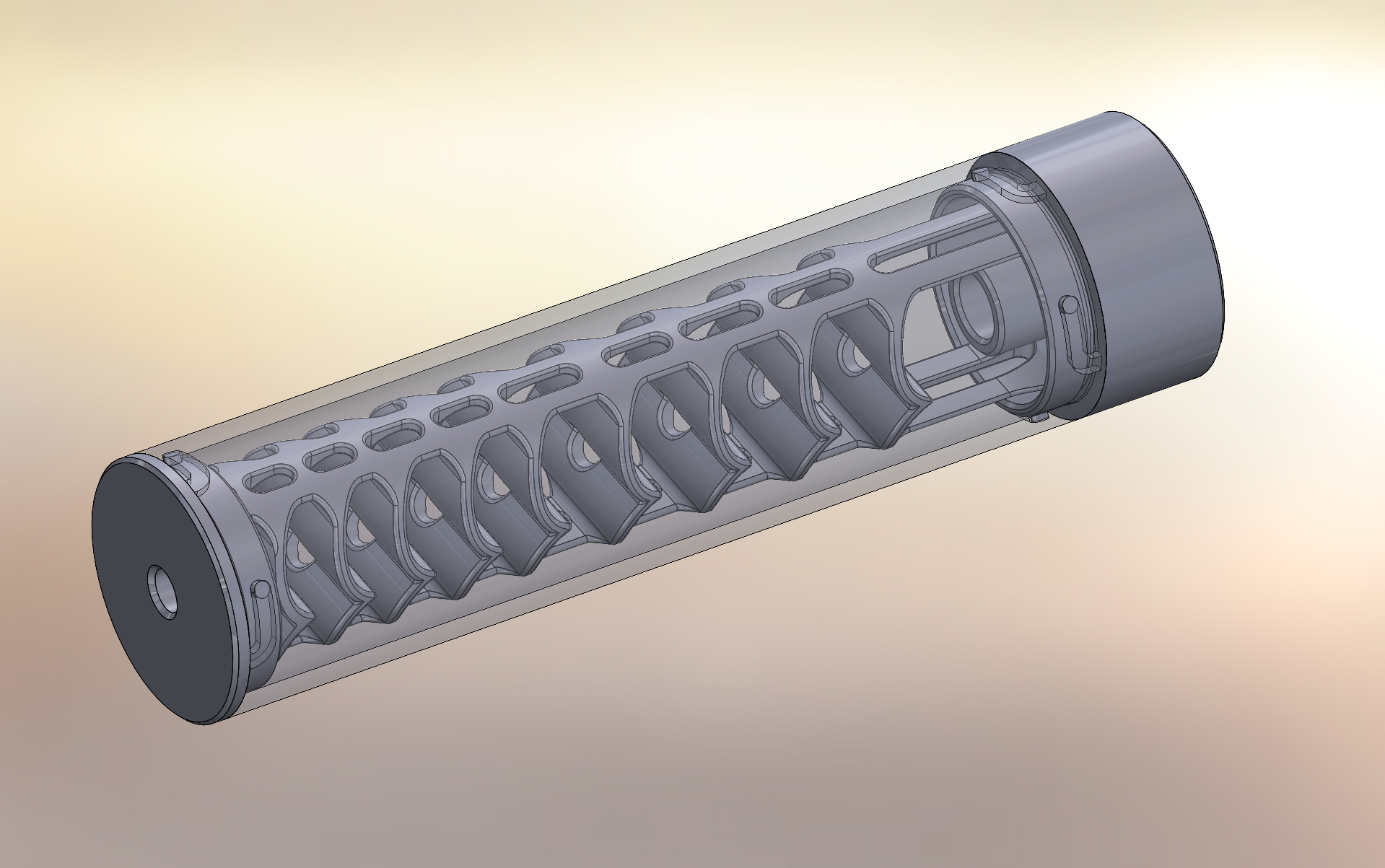

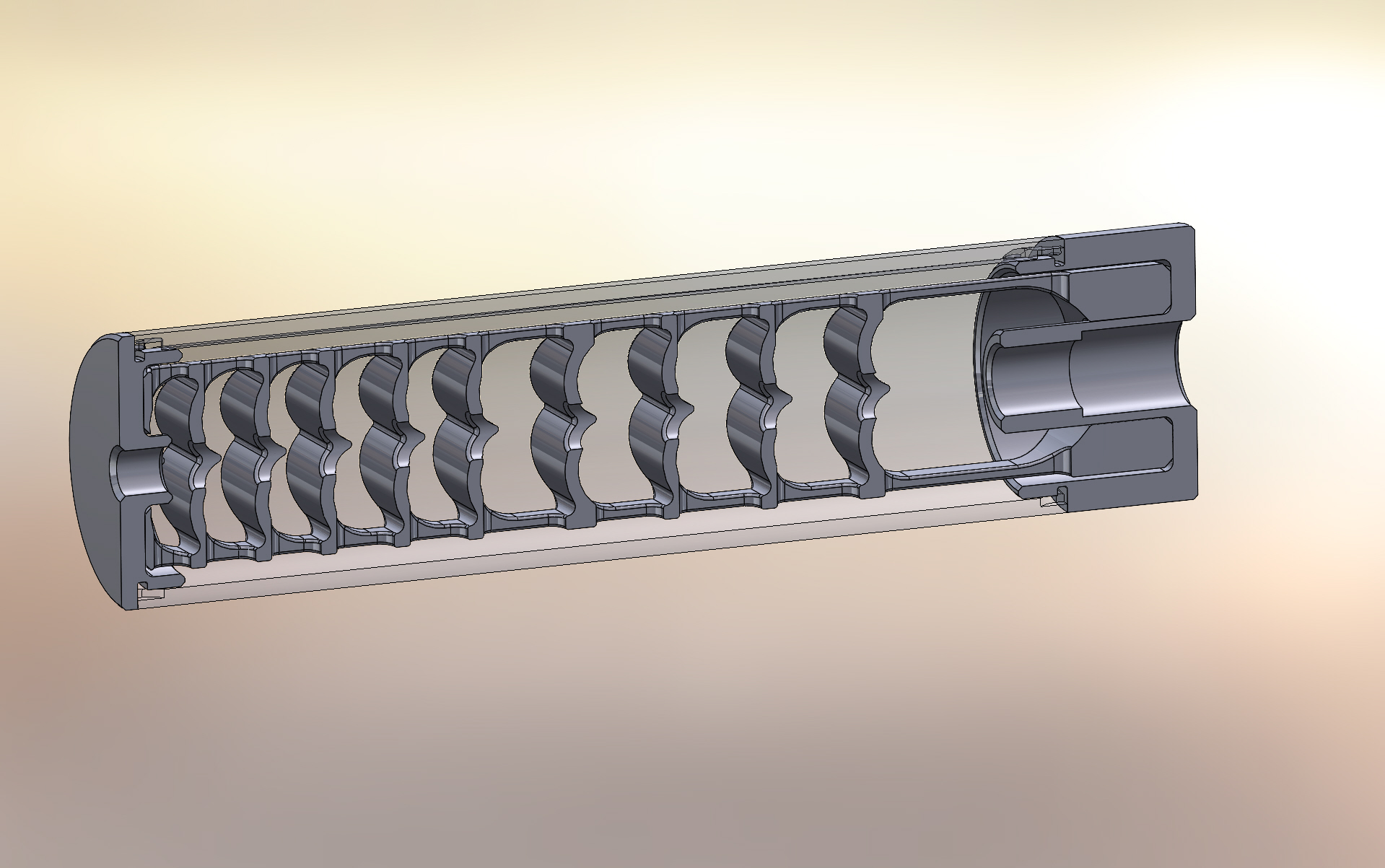

I've made several 3D printed moderators. I use Carbon Filled Polycarbonate. I think they're as quiet if not more so than some of the big name ones, but the print time and removal of supports is a drag. I print the core, go around it one time with fiberglass window screen material (to keep the felt away from inside the core), then go around one more time with 2 turns of felt. The two end caps keep the core centered. The rifle end of the moderator is printed with a counterbore that is a slip-fit to the barrel and a helicoil is set at the bottom of the counterbore to engage the barrel threads. The counterbore takes the hanging weight off of the threads and puts it on the barrel.
