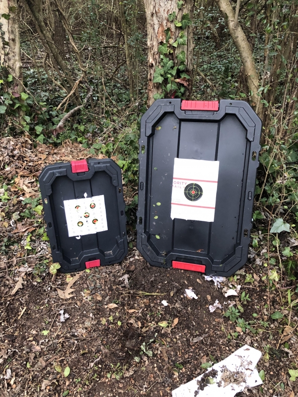

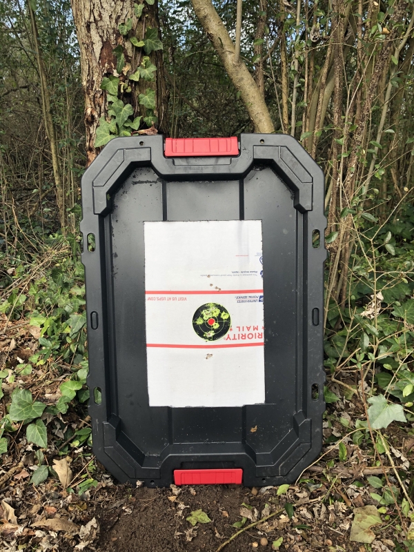

Thank you for the video! I’ve made two of these pellet traps and can confirm they will stop a .30 Red Wolf at 50 and 100 yards.
Just slap on a new piece of cardboard and I’m ready for another session. Extremely convenient! Thanks again 👍

Thank you. I really only put in the rubber mulch without packing it in per se. I did build it up enough to allow enough pressure on the cardboard to hold it in plece. The cardboard is only larger than the hole, not as big as the tote. Not too full that it will bulge either.
There has been NO ricochet at all.
