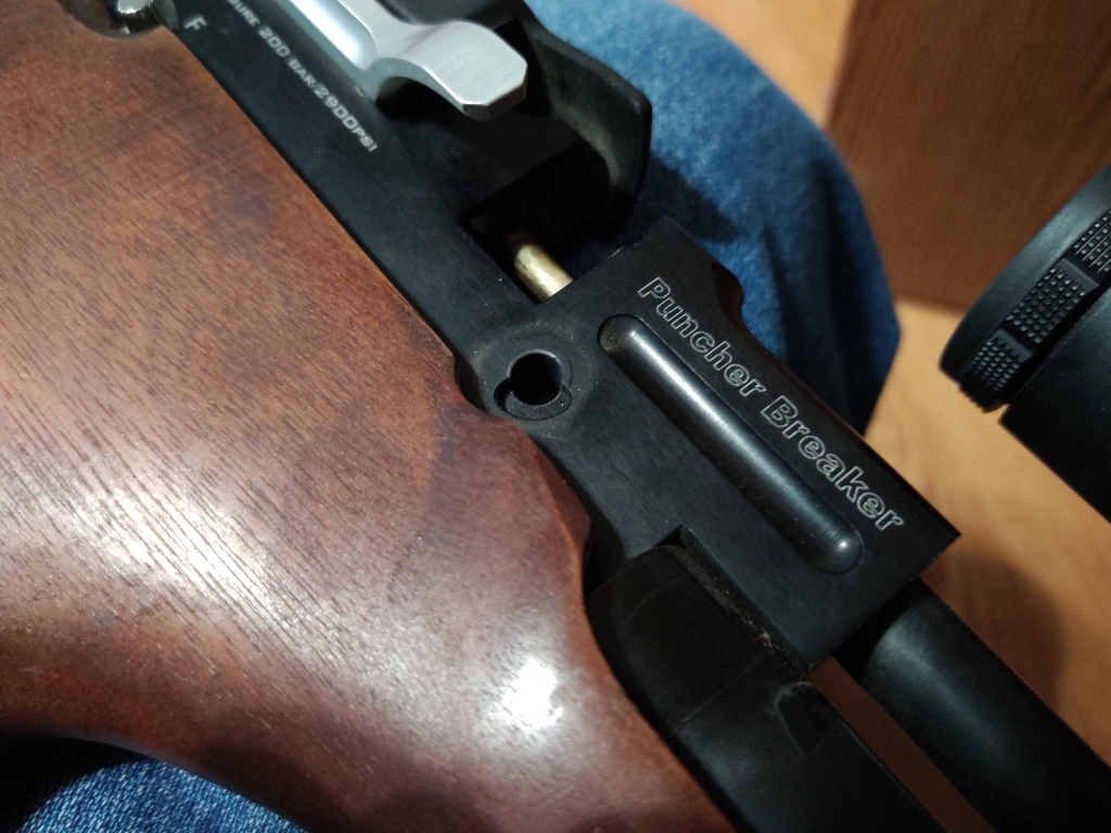

Yep, it was originally made for the Swedish market, 10J, as I have a license I contacted the seller, who told me that the only difference between my gun and a fac one was a small set screw blocking the power adjuster. I removed it, and aside from the fact that the hole in the power adjuster is tapped, I am told it is supposed to be exactly like the original version. Hence why I would like to compare some parts with another gun.
Also, the guns are modified in-house by the seller from original guns, so I expect they would know if anything else is different from the regular version. Aside from that, I measured the hammer spring, which seems to be the sam length, but I have no way of verifying the thickness.

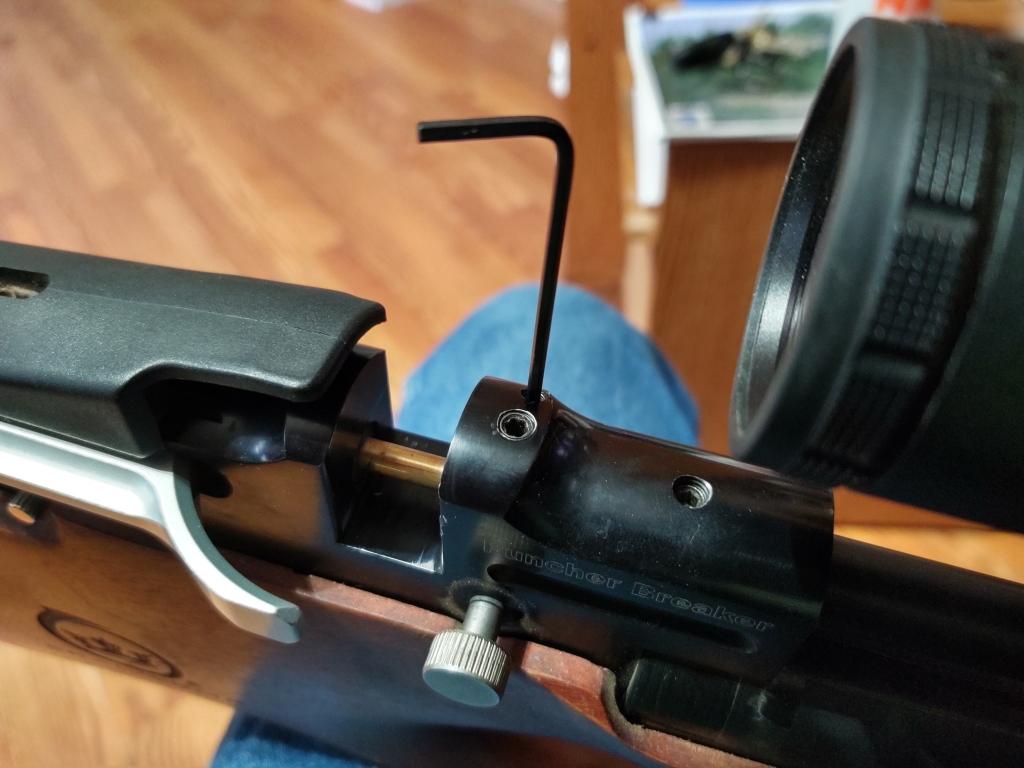

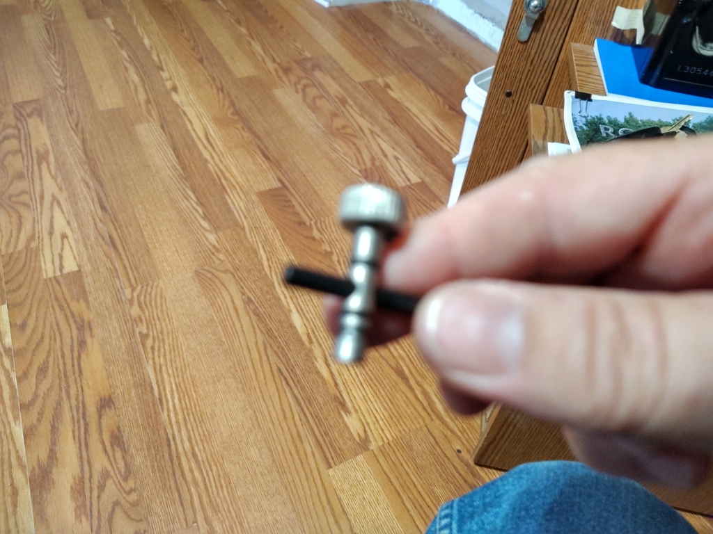

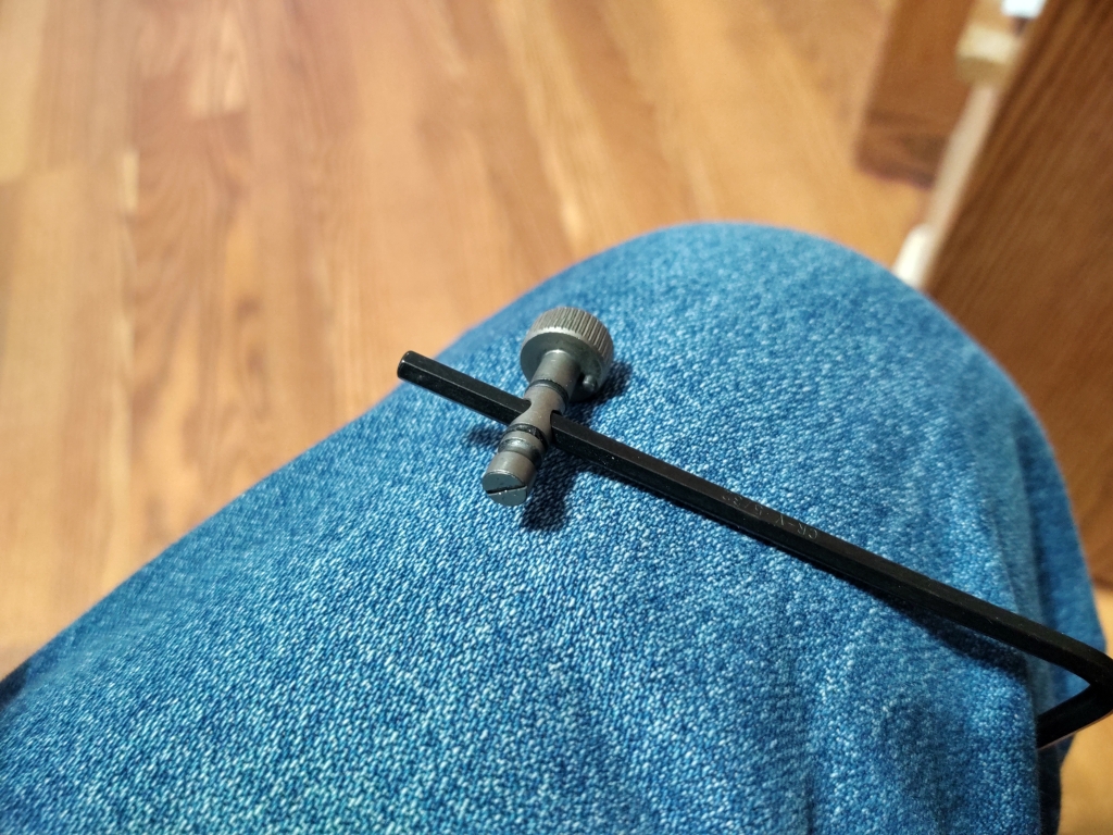

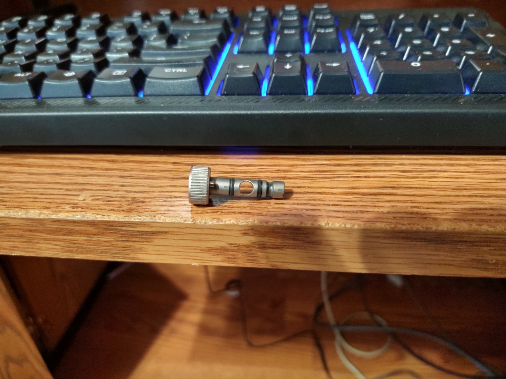

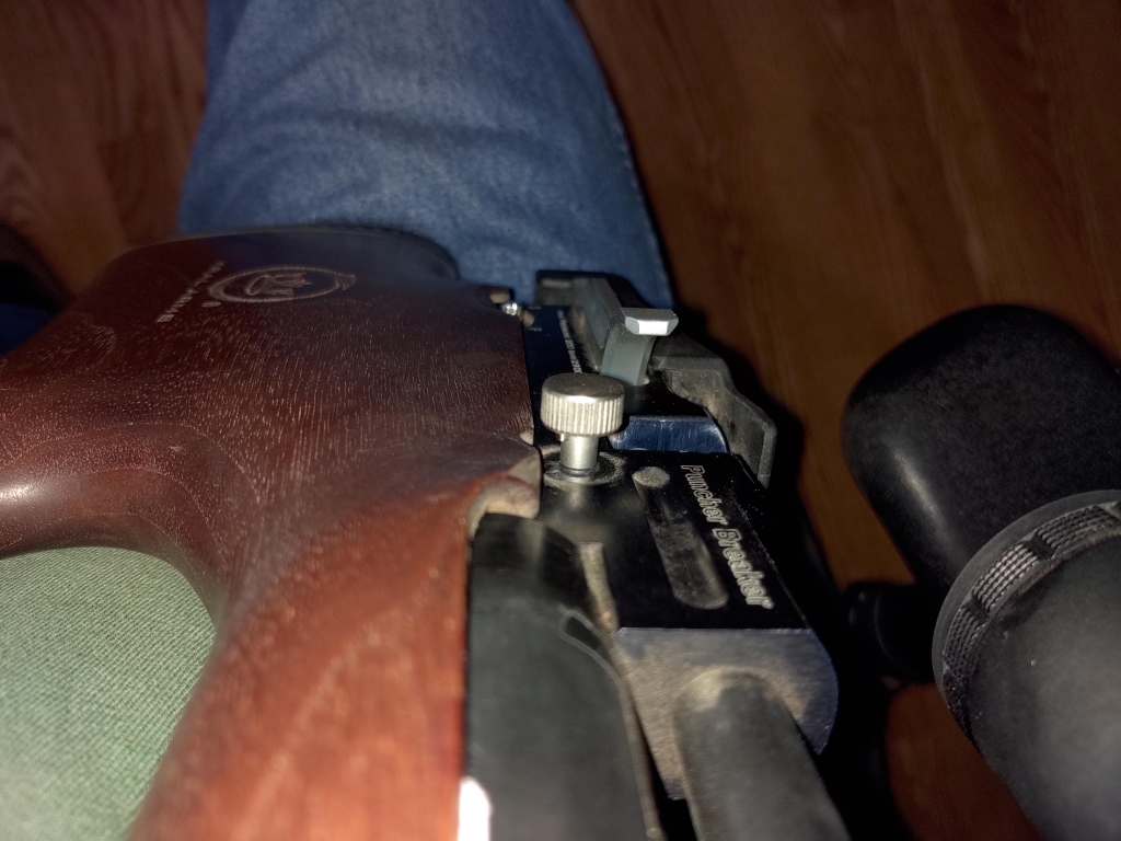

with a 2mm hex wrench, loosen the rear, left set screw that is just in front of the magazine.
Then
 Press/pull the knob to remove.
the transfer port port should be just over 3mm.
