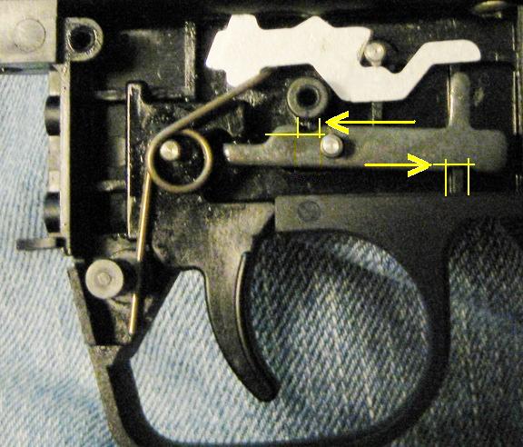

As part of the installation did you notch the OEM part ( called "link" in Crosman diagrams) as shown in the photo below?
It works well when it does.
Mine is the exact opposite, as I have experienced sear drag (hammer does not hit the valve in full force), so I will Dremel the hammer a bit---have not done it yet.
Paired it with a stainless Don Cothran Roller Trigger.
It has no slack nor creep and is very sensitive (I like light single stage triggers) but does pass the bump test.
I also shimmed it to make up for its slimness.

I'm on the gta but that inquiry isnt me. I think with loose production tolerance at crosman the sear is a hit or miss product. For me it would sometimes cock if I fiddled with the trigger when cocking but then would fire upon closing the bolt. For me it just isnt working but for someone else it may be gold to them. It worked on my 1377 just fine but not the maximus. I have a discovery and want my maximus to be the pimped out version. Lol. I think I'm going to try and find a marauder trigger and go all in on it.
