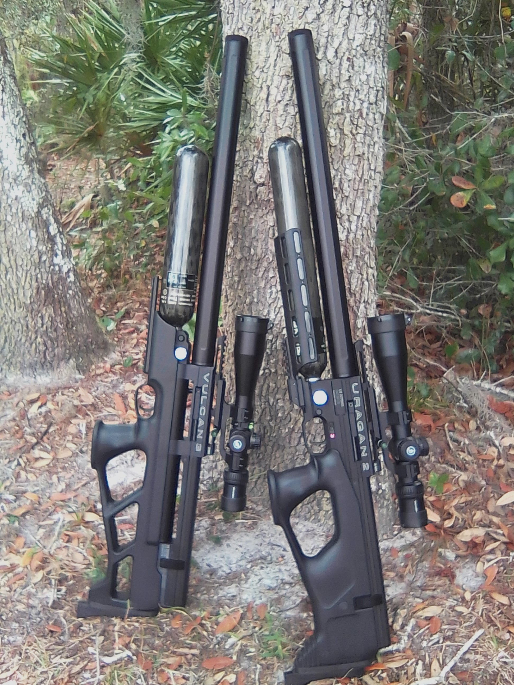

Here's my two .30 (700mm) sluggers, designed and tuned by AGT for slug shooting. ZAN's .30 Slug Assortment box helped identify what weight slugs these factory tunes preferred. From there I shopped AVS, NSA, Wildman and Javelin for slugs in that weight range, some shooting better than others. Finding accuracy with slugs took a little effort but not frustrating nor discouraging. WM
