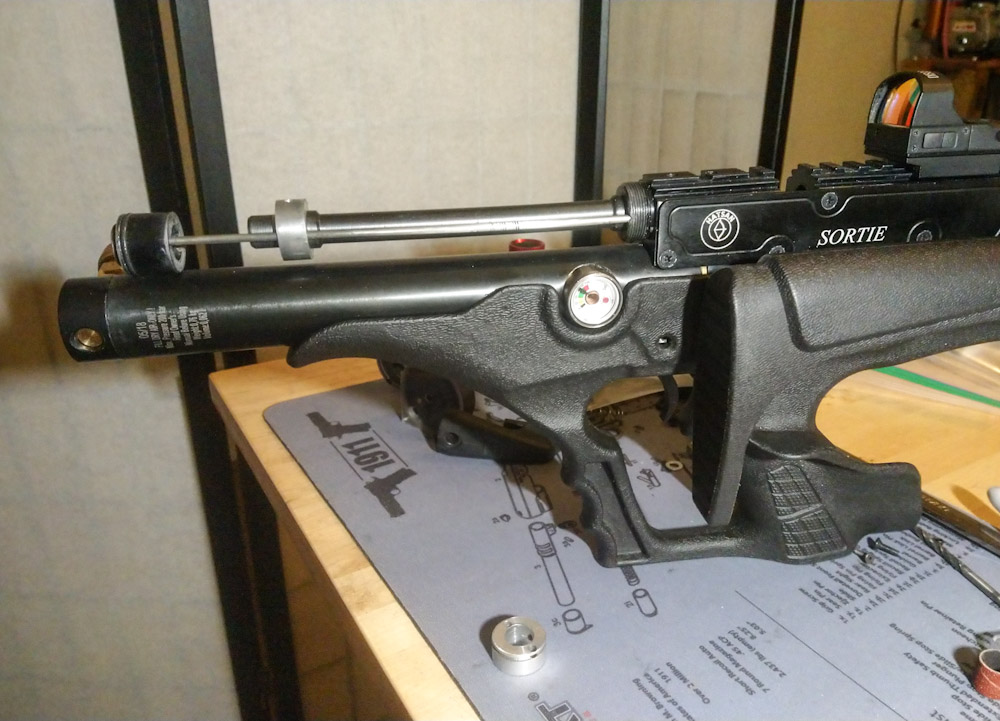

new barrel bushing fits very snugly Inside shroud, not loose (traps more pressure to act on piston, also quieter since my shroud has vent holes) . You can see the original bushing on the work mat. I tried cutting an oring seat, but the oring would rub on the rod the piston actuated, slowing it....

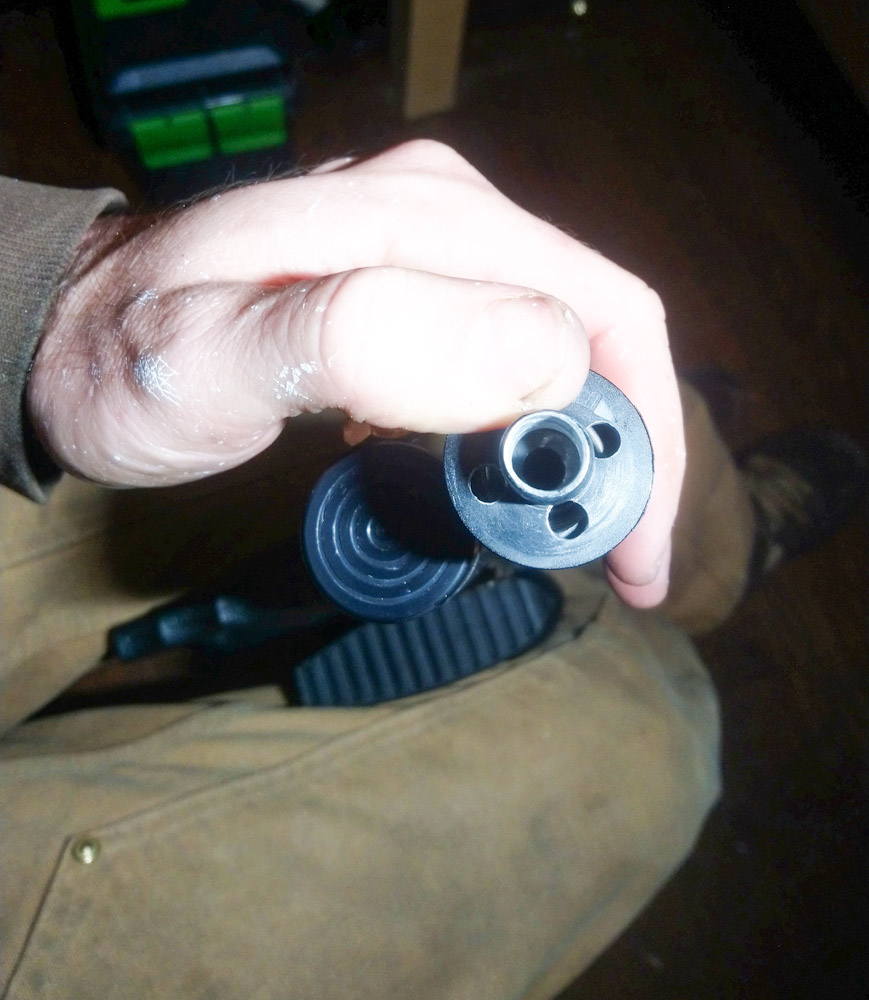

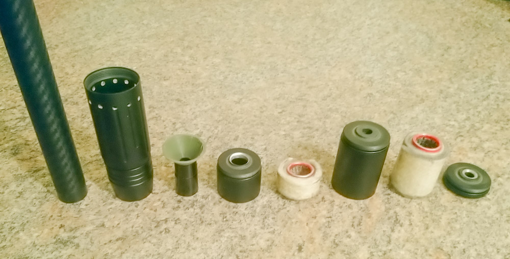

Polished action. Heavy porting on mod adapter. Ported side of moderator body, and vent shroud thru the side of moderator. Muzzle blast is channeled straight thru moderator. First baffle opened significantly to provide expansion volume... Delay back pressure. Restrictor fitted in gas piston forward of muzzle

No problem. It did take a considerable amount of time making improvements here and there. The real breakthru came trying something I knew wouldn't work, but did show me that the muzzle blast was coming out of the gun in a column, completely avoiding the 4 outer ports I had punched in the moderator adapter. Leading to other modifications....
I only use hand tools, dremel, drill, ect. I had a friend turn the barrel bushing for me, however... There were other small tweaks and modifications I didn't list. Too much work for sure, but I wanted what I wanted. And got there.
