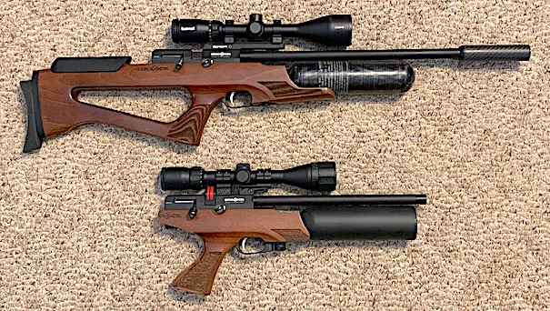

FWIW, I'm down to my last uncircumcised Brocock and have no plans to butcher Ol' Faithful. The .22 Bantam Hi-Lite 'semi bullpup' carbine is unerringly accurate, dependable, impressive and lovable... as is (top).
But after recently being cheated out of the .177 RonCo BroCo (Hi-Lite) pistol conversion (bottom) by a slick-talkin' Okie (;)), that term an oxymoron if ever there was one, when I found myself totally devoid of butchered Brococks my imagination got the best of me and I couldn't resist the 30 foot pound Sniper pistol endeavor. On second thought, maybe that was a flashback or fever-dream.🥵
