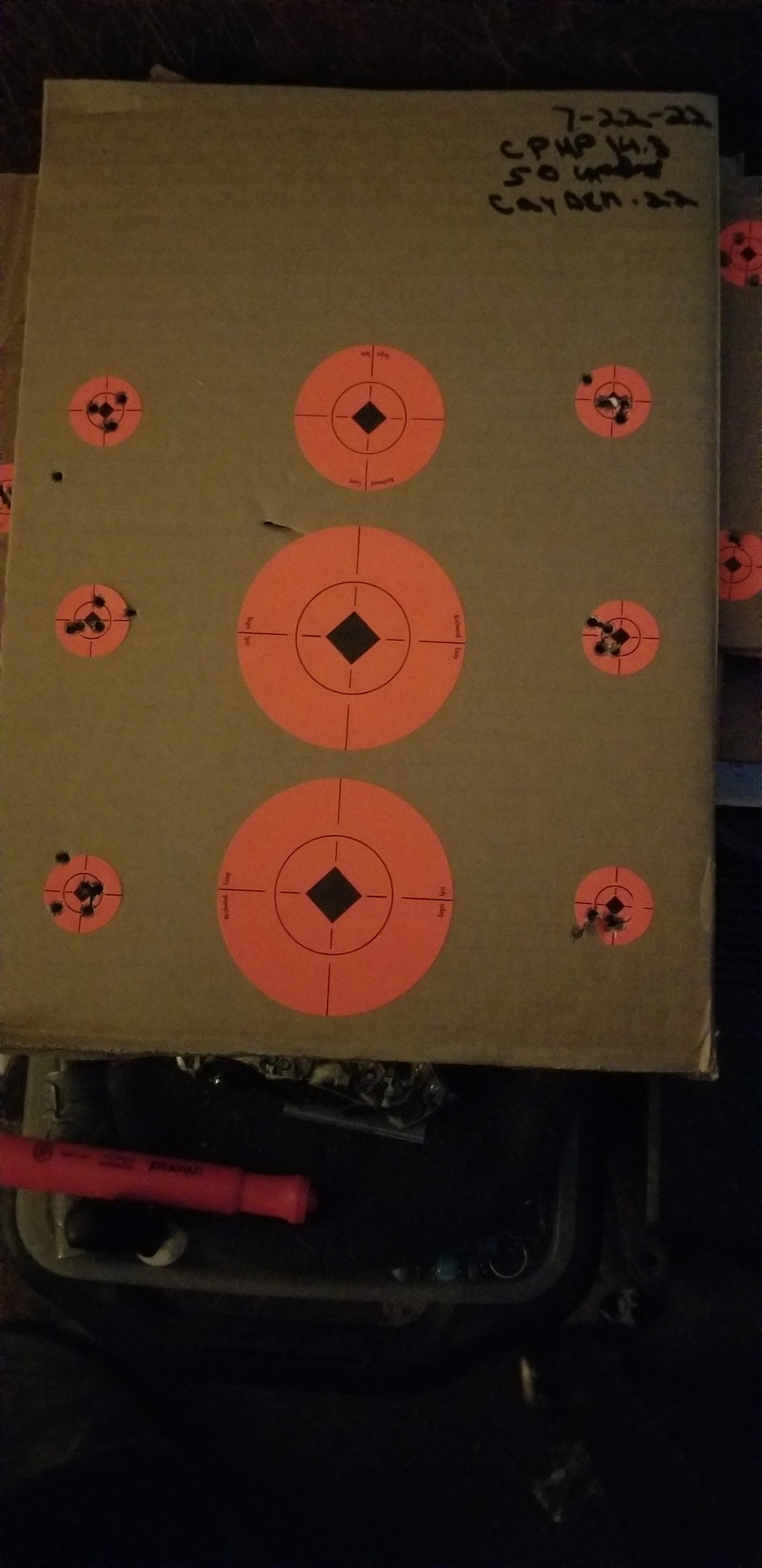

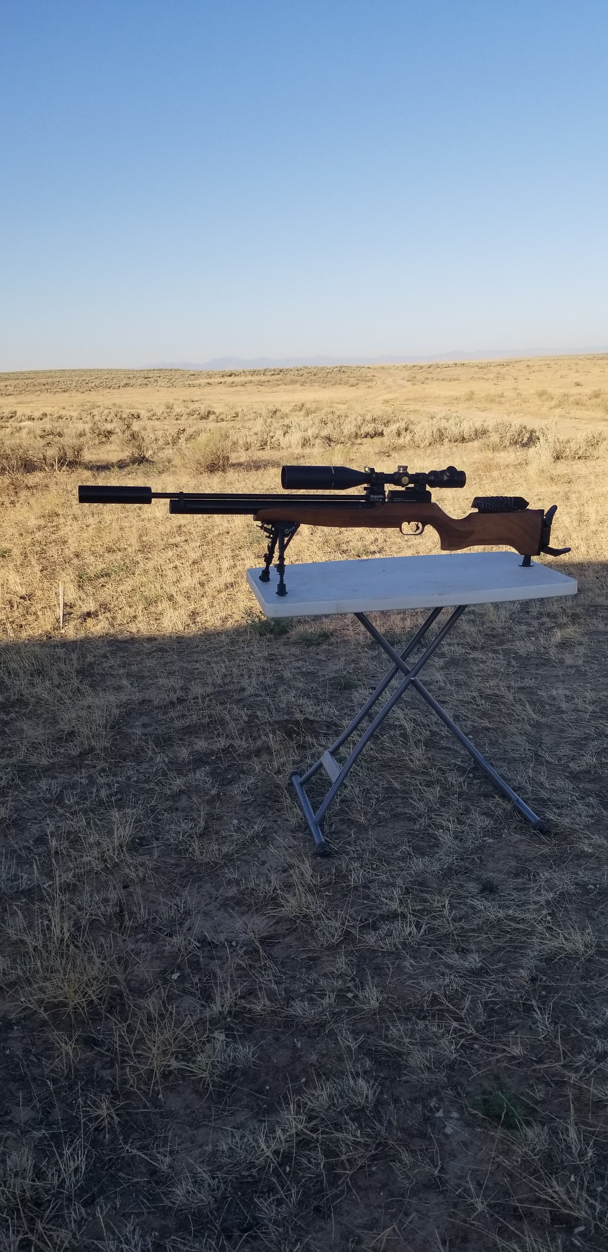

I thought I would post a shot string @50 yards and a picture of my Cayden
