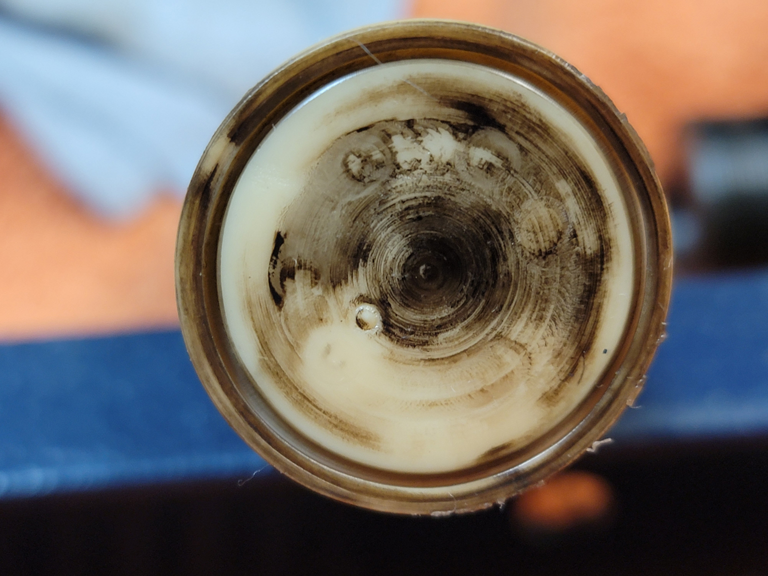

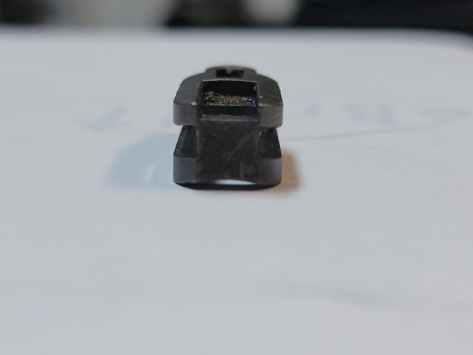

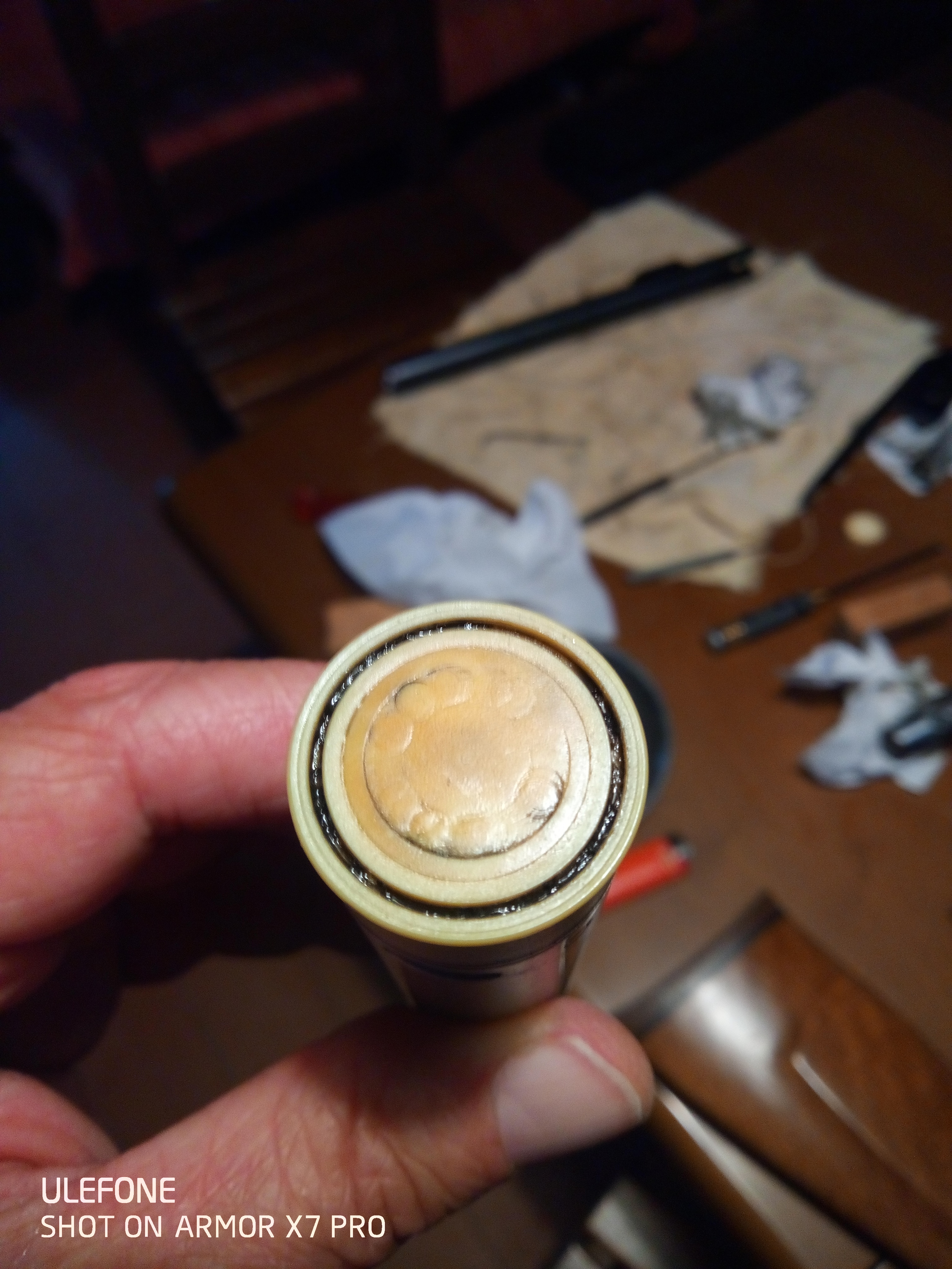

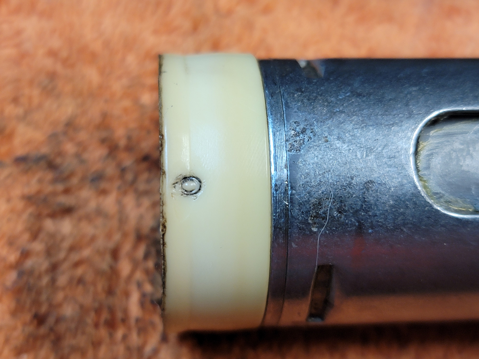

Torn down, this is what I found.
Cocking Shoe is new type
Aside from what appears to be some minor dieseling, I dont see any major issues? I would expect to see more of a "flair" at the top of the seal thats for sure. As stated previously, this rifle has relatively low pellet count ran throught it. That seal is telling me the opposite. That little "dimple" on the side in the one photo looks rather odd. If I had to guess, this rifle is around 8-9 yrs old. Stayed in the closet most of the time as I enjoyed shooting the HW95 much more. I'll hose everyhting down with brake cleaner, do some deburring of all the sharp edges, get that piston sleeve out and lube what I can until the new Vortek kit arrives......
I really appreciate everyones input. Knowledge is power.
That seals pretty rough.. it needs to be gone.. ( opinion). Being that factory installed seal maybe kinda par for the course somewhat..
Like the transfer port marks. Shows could be poor sealing pressure / not enough pressir to cushion the end of travel / like slamming .
Definitely scared up maybe from install and looks kinda dry or factory trash in the grease from your next to last picture above. Just looks like a poor fitted factory job .. ( why guys that buy a new hw/r fix them new out of the box🤤)
Regardless a new seal fitted and lubed right is a must for sure ....
I guess now is get that kit in and see how ya stand ...
Looks like the seal was hanging up on the install. Someone pushed down hard with a punch to get it to clear some roughness on the entry or the receiver slot. Damaged the seal in the process. Not sure it looks bad enough to cause that much loss in power. Probably between the damage and the dried out lubrication it did. Check the interior for burrs or roughness. You could do the same with the new seal.

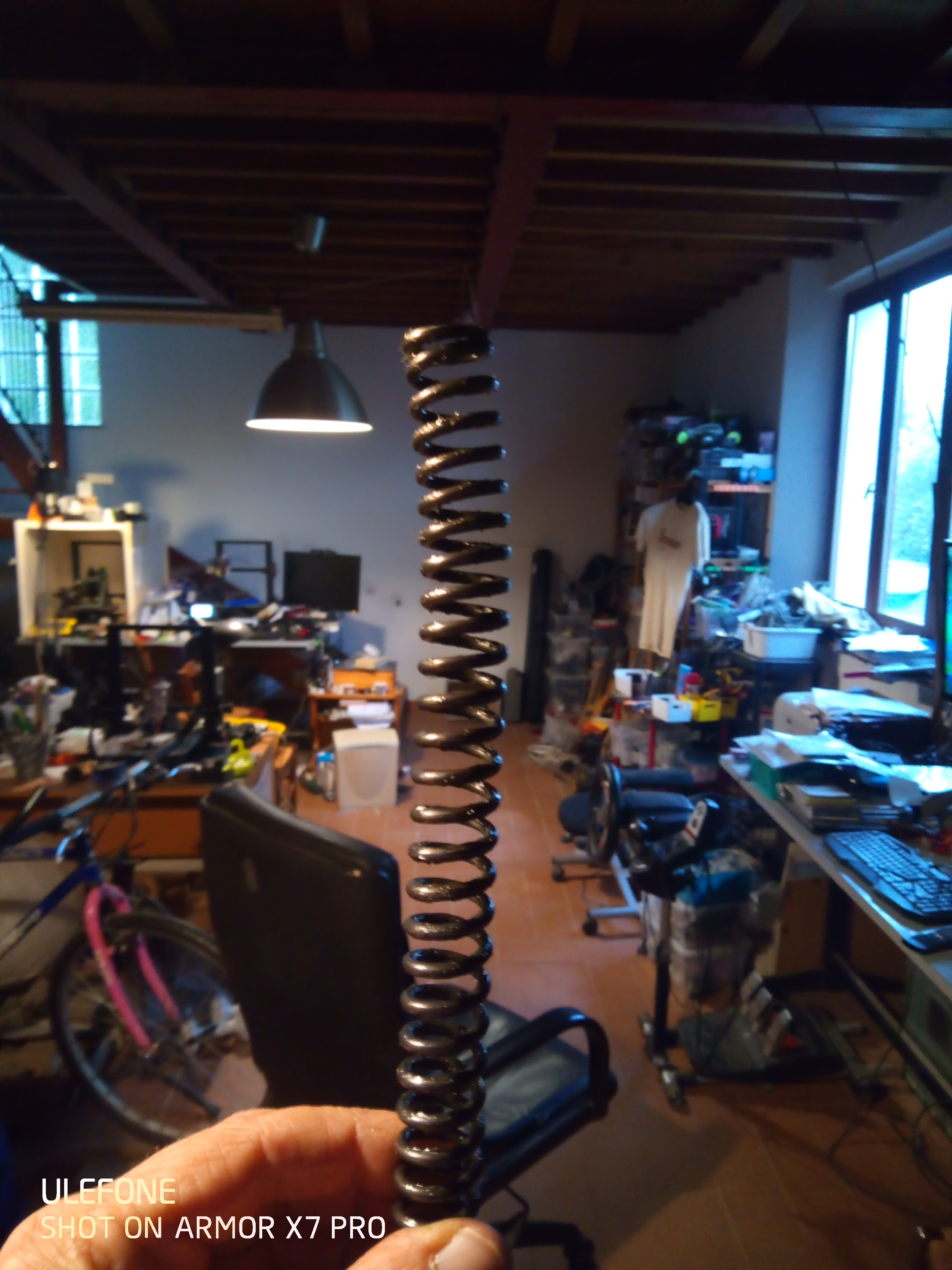

I made a lot of practice and mistakes with my HW50S with the original Weihrauch full power spring. Due to an improper excess of lubing with oil based grease, I've got dieseling and the collapse of the spring. I agree with the deburr of the sharp edges into the cilinder and I found that's enough to lube the seal with two drops of silicone oil, after a brake cleaner wash, and grease just a little bit the portion of the spring that seats into the piston.
I prefer to service more often but avoiding dieseling.
