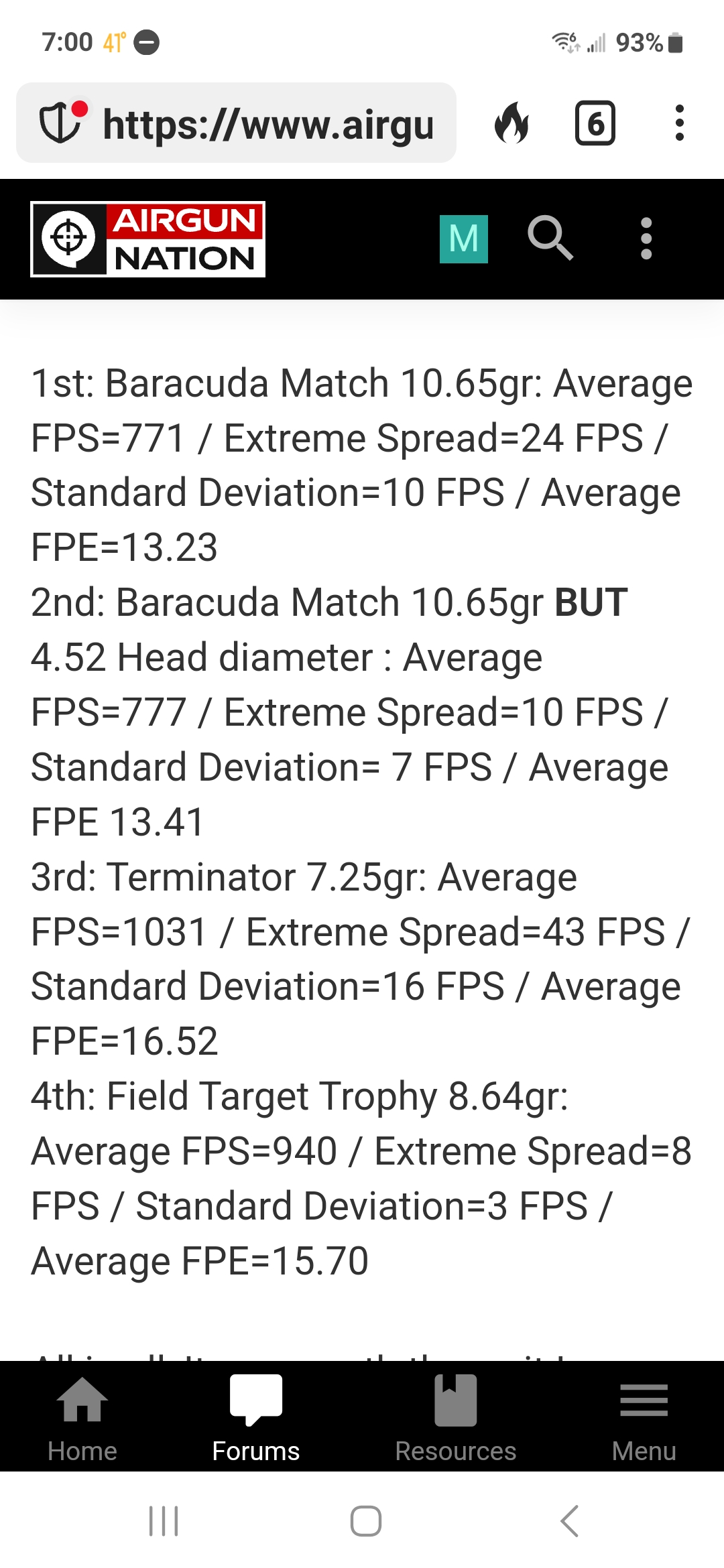

New (replacement) Spring kit installed. MUCH BETTER. I decided to test an assortment of H&N pellets including the Baracuda Match 10.65gr that I used in my intial evaluation. Testing was done a few min. ago at a Temp of 66. 10 shots were fired before recording shots to clear out any remaining solvents and or lube in the compression chamber. All are 5 shot groups:
1st: Baracuda Match 10.65gr: Average FPS=771 / Extreme Spread=24 FPS / Standard Deviation=10 FPS / Average FPE=13.23
2nd: Baracuda Match 10.65gr BUT 4.52 Head diameter : Average FPS=777 / Extreme Spread=10 FPS / Standard Deviation= 7 FPS / Average FPE 13.41
3rd: Terminator 7.25gr: Average FPS=1031 / Extreme Spread=43 FPS / Standard Deviation=16 FPS / Average FPE=16.52
4th: Field Target Trophy 8.64gr: Average FPS=940 / Extreme Spread=8 FPS / Standard Deviation=3 FPS / Average FPE=15.70
All in all, It was worth the wait I suppose. Not only is the power back in line where it should be, it shoots much, much smoother.
NOTE: In addition to the spring kit, a new piston and breech seal were also installed. Life is good.......again.

I didn't check your calculations in this post. Here you list the FTTs as 15.7 fpe. That math is incorrect and why I thought the gun was down on power. My calculations are 16.95 fpe which is fine.
Yes, thats what the app says......but if you take the average FPS and do the math, it comes up with what you and me stated.....strange.
Thanks. I was considering getting another chrono for that app. Now I'm not. Thanks
There is nothiing wrong with the App. The problem is me. The App however WILL NOT allow entry of bullet grains to the 2nd decimal point. Looking over my data entry, I found that I did not enter ANY decimal places for bullet grain weight. After adjusting the data for the above example Field Target Trophy, if I add .6 then the FPE changers (of course) to better reflect actual numbers. MY BAD for not realizing this. It would be great to have bullet gr weight entered to the hundredths obviously......I was just on the phone with Competition Electronics who make he Chrony, And begged them to update the app to allow grain weight to be entered to the 2nd decimal point, and they told me it couldnt be done....according to the app development team. I explained how important that is to our sport, as our projectiles are rather small compaired to our firearms counterpart. It probably fell on def ears.
