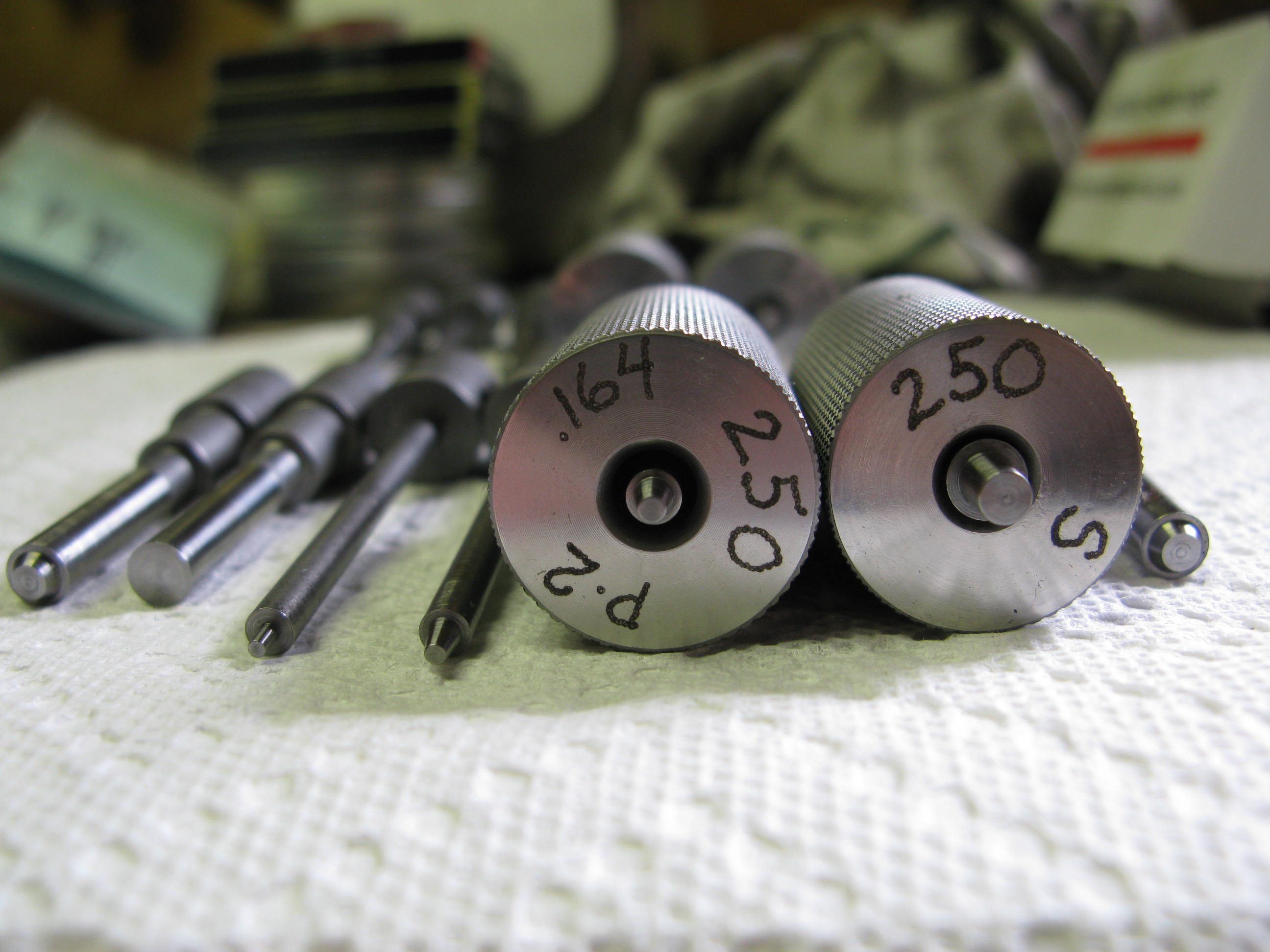

For those interested, the S swaging die, (see pic), is needed to make the hybrid style slugs. It does everything except form the nose of the slug. The P die is then used to form the nose. The P die is also used by itself to make standard slugs complete, whether they be hollow points or solid points. In the picture both dies are there along with some of the punches that make the HP's and different bases.
