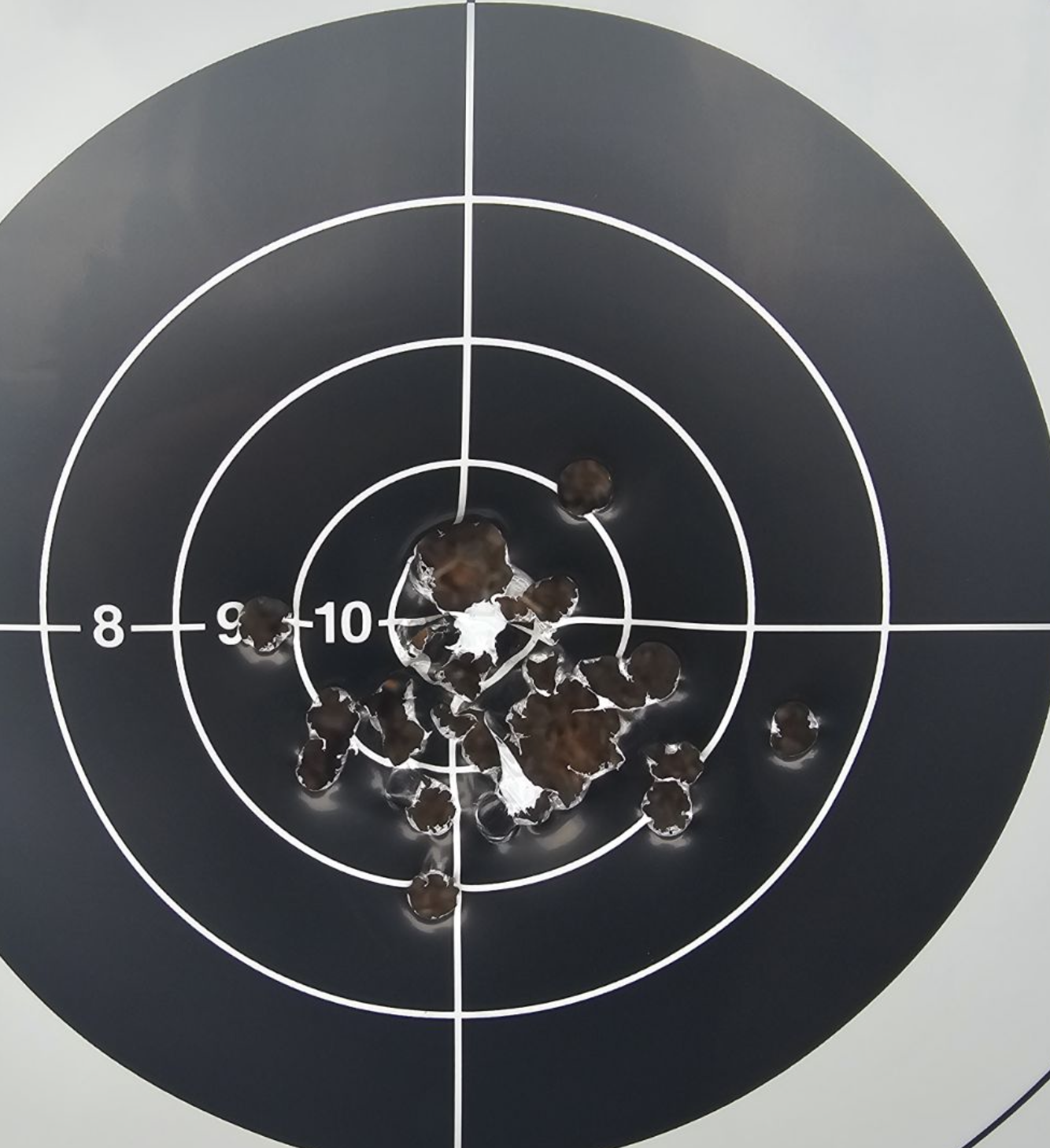

Got the rifle in last night went out his AM and ran a few mags through it. Matthew had made a silencer for the spring, nope didn't do it...hang on to that thought.....with 33.96 JSB MkII perking along at about 970fps 25 yards wasn't too bad, ok groups. Tried some Zan's up to 40gr, much slower of course but ok. Gun sounded loud though with the pellets, couldn't hear it the report. Came back from Valentines Day Fish Tacos. Pulled the hammer spring out, and flipped it around with the 'silencer' to the rear so see if that helped. Put in some 33.95;s, let one go, ok MUCHO better, twang is still there but manageable, I could actually hear the report, not too bad. Perking along at 970 again, SD about 2.3 ish.

Well got to my permission, got set up and ok dummy you left targets at home for setting it up. Got a plastic bottle set it out at 100 yards, dialed up the scope to 100 and let fly, oh my it hit it, a few more hits and it went down below the weeds, kept on shooting. The 33.95's were 970fps SD of 2.2, loaded in some RMR/FX 26gr slugs, 1032fps, sound of hitting the bottle. It's overcast and cool, too cool for Ground Squirrels so I wait and chat with the Horsemans Assoc. janitor. He's getting ready to leave and oh look a target on a log, 100 yards away but, he had to go, he leaves and the squirrel leaves too. Wait what do I see, it's a big rabbit, aim at its head and...miss..huh?? So I find a rock out there and shoot, misses to the left, do a windage adjustment of 1.25MOA and brings it in, explains why I missed the bunny. All in all the gun worked well, hammer spring is twanging line a banjo still, got home, took it apart, did a small modification to the piece that Matt put in and a piece of electrical tape, now a slip fit inside the spring and, twang is gone.

I played with the tune a bit over the past few days, reduced the reg pressure a bit, just a tiny bit then starting playing with the striker adjustment and spring, got it pretty well balanced out, have both JSB 33.95 and RMR 26gr hybrids shooting ok, SD of 2.3 on both, I've yet to find a slug that works well enough to mess with it further, I've tried Zans 30 - 38 gr, JSB Knockouts 33.49 gr, Patriots 36 gr, none are close enough to right home about. I'm going to revisit the slugs tomorrow and see what happens.
