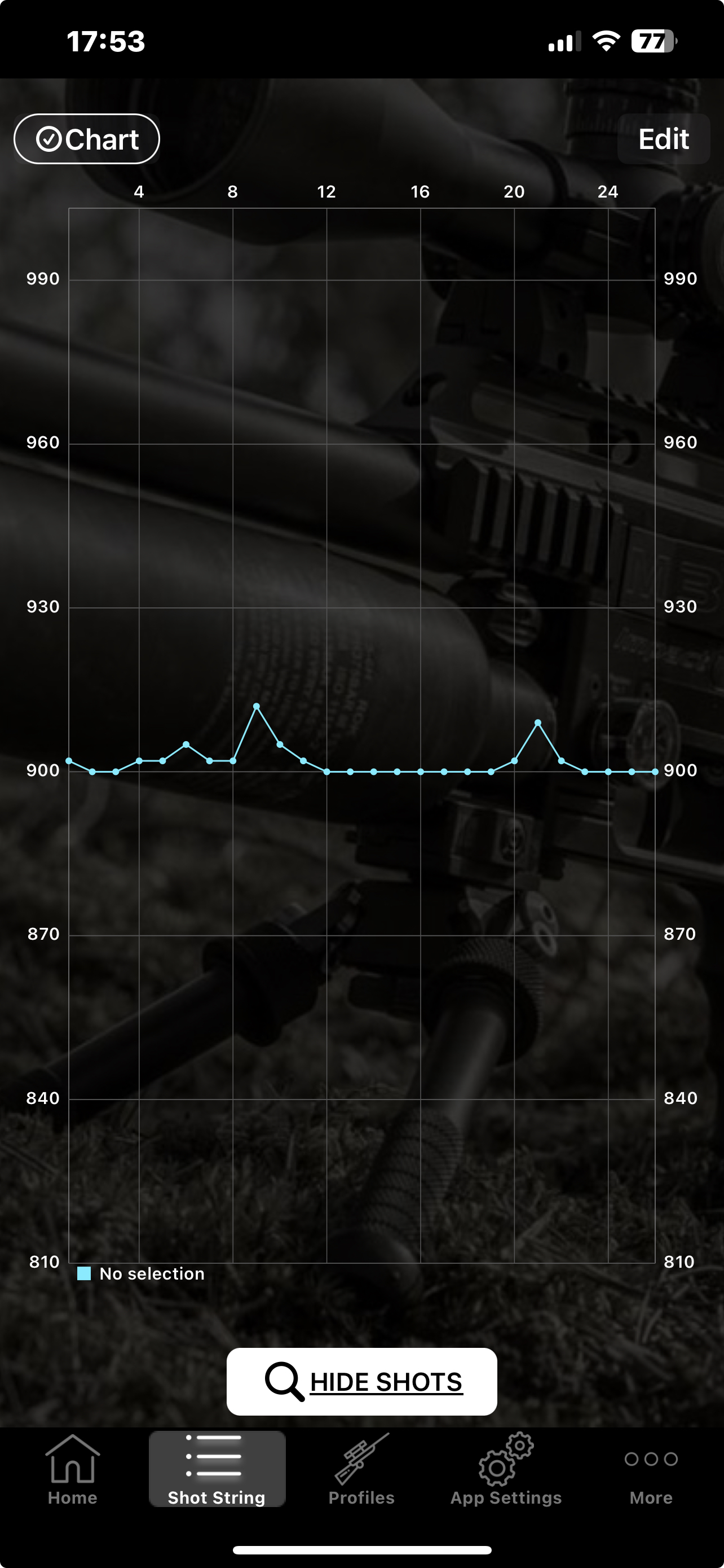

4.2.24, remounted the scope, Arken SH-4 with their highest mounts to clear things, clears and that's all I can say, it's close but see light and that's all that matters. With the AEA Center Punch 6 shots.....887fps, Spread of 2, SD of 1.0. I'm calling this close enough. I don't want to bring it up, with 25gr pellets I'm pushing a touch over 1,000 fps. Tank is down, time to play with my......replacement balls. A note on the Center Punch, they are...snug... in the breech, I need to measure them and compare against the JSB's
Update, I measured a few JSB's and 10 or so Center Punches, the CP's were between .2503" and .2506", the JSB were .2500 to .2503. This explains why the CP's are tighter in the breech. BUT there is no evidence that the tighter ones create an issue with speed or accuracy. The first 3/4 are the Center Punches, the next spike are the JSB's. It's obvious that the regulator is bumping up a bit. Nothing really significant IMHO.
Screen Shot 4:3:2024 IMG_3FD7AB9ACC8A-1.jpegScreenshot 2024-04-03 at 17.53.56.jpeg
Notice there is a 15fps increase from what I said above. All I did was reseal a bleed valve, and pump up the Raptor to 300 bar. I was 'thinking' of bumping up the speed a touch but the gun did it for me, how nice.

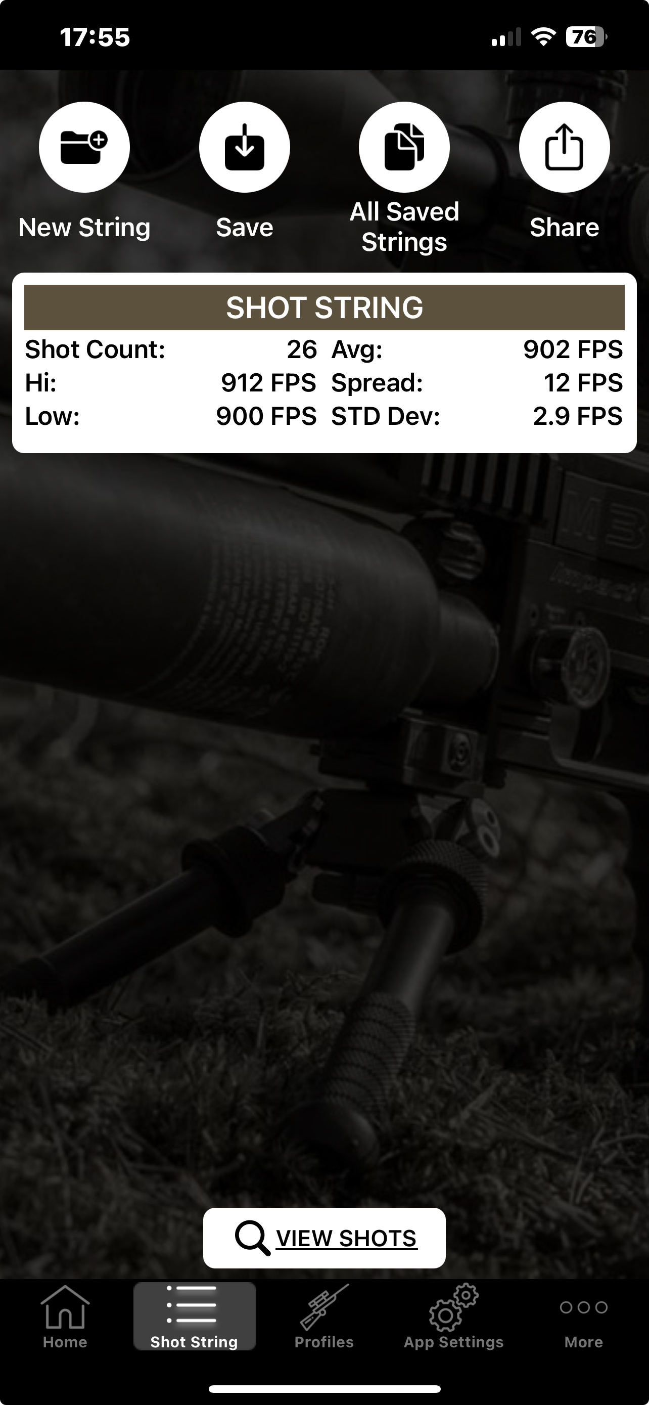

More playing with the AEA Dead Centers, the Raptor REALLY likes them. Verified my zero at 30 at home, first shot was 912, next 22 shots were 900 to 901 STD of 1 fps, close enough If the gun sits for a bit the first shot is always a touch high., next day went to my permission, target at 70 yards dialed the scope to my 70yard and hit 5" steel, moved over hit the 3" steel, moved over, hit the 1" steel, dialed to my 110 yard, aimed at a little dirt clod and hit it. Calling it good.
