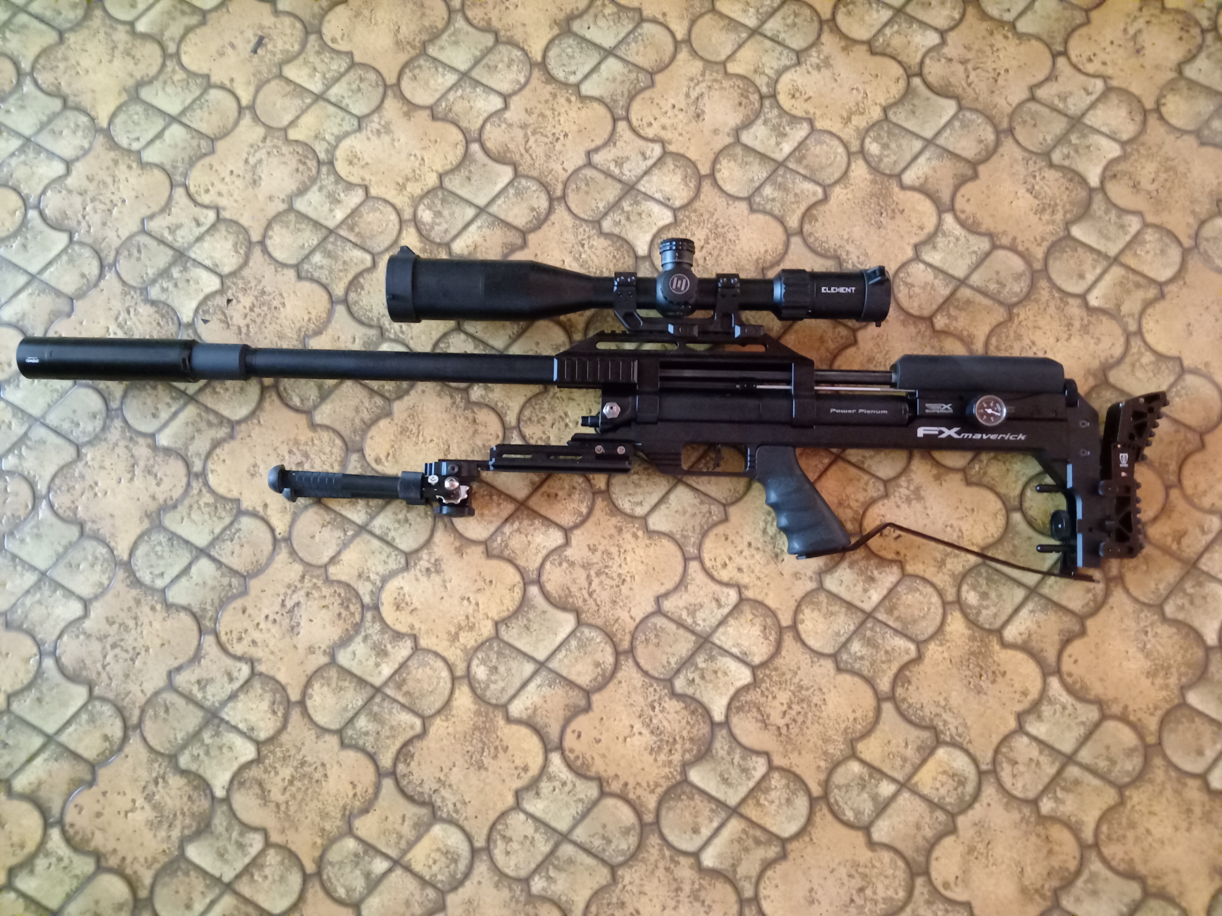

I have maverick in 700mm .22 heavy barrel and tungsten hammer. Shooting mostly 40grain/2.6g H&N slugs. For me, its totally enough.
