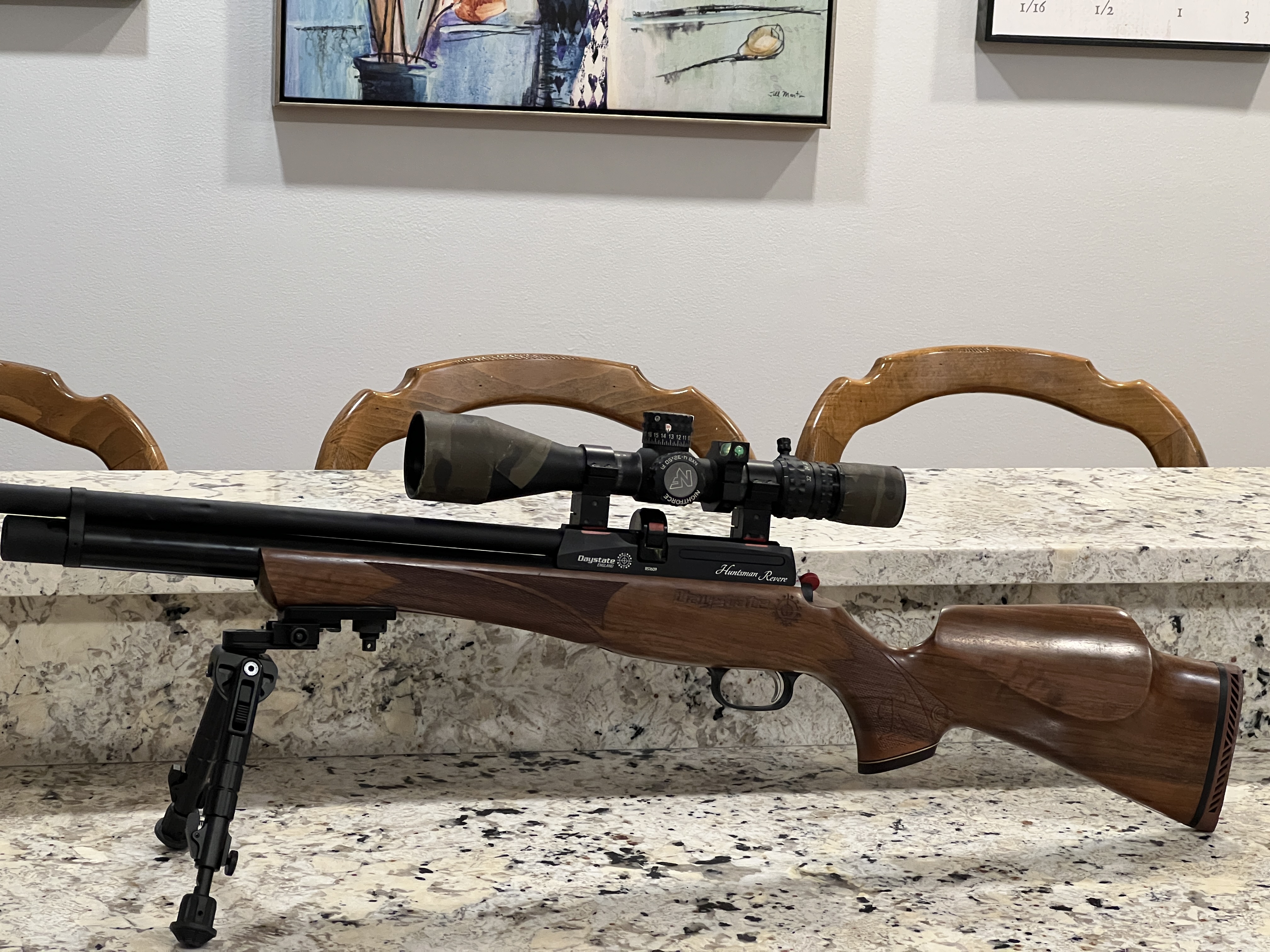

I have a Daystate Huntsman Revere .177 cal and can assure you that it is accurate using JSB 8.44 and 10.34 pellets. This rifle's sweet spot is 15-17 fpe. I do not attempt to use it beyond 50 yards, mind you.
