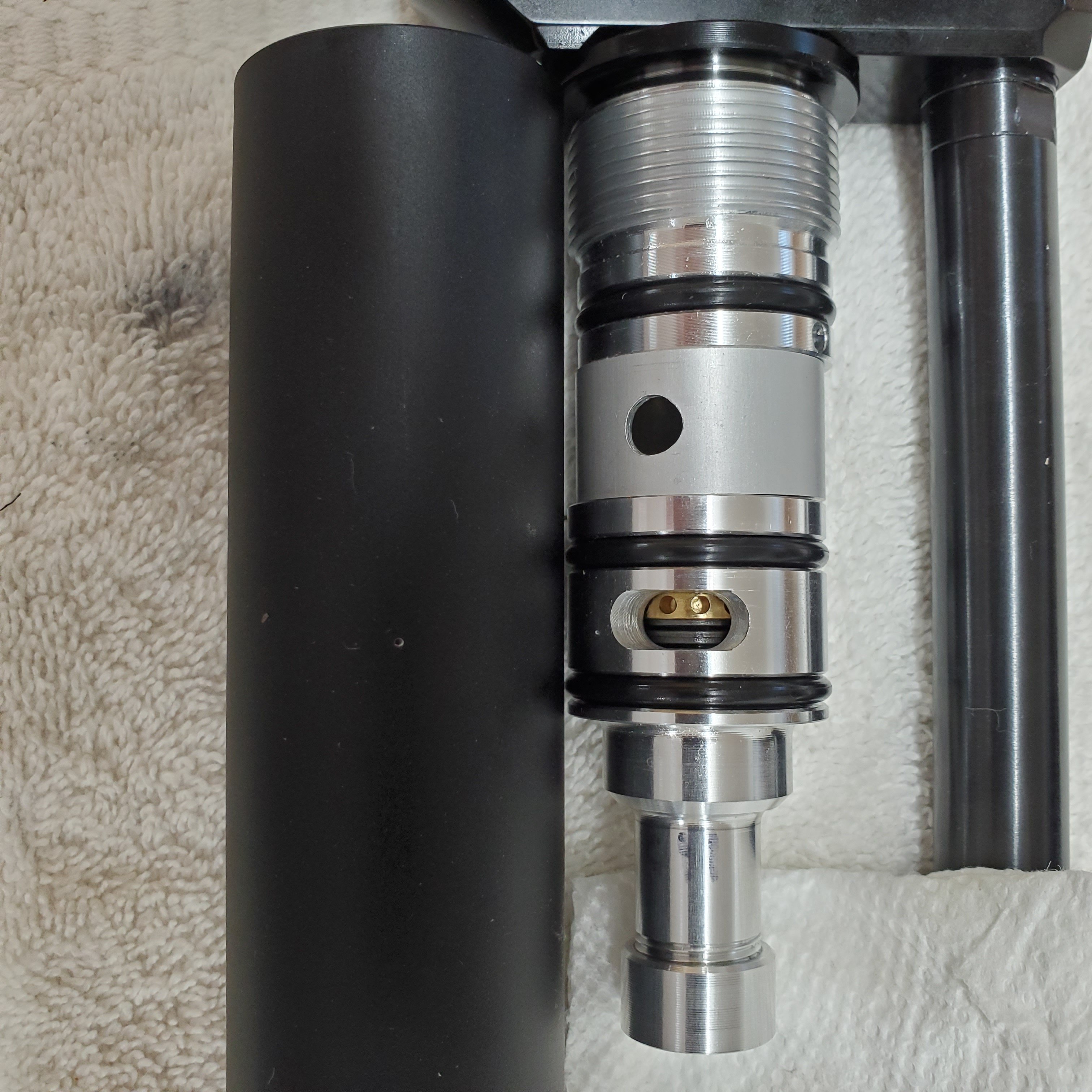

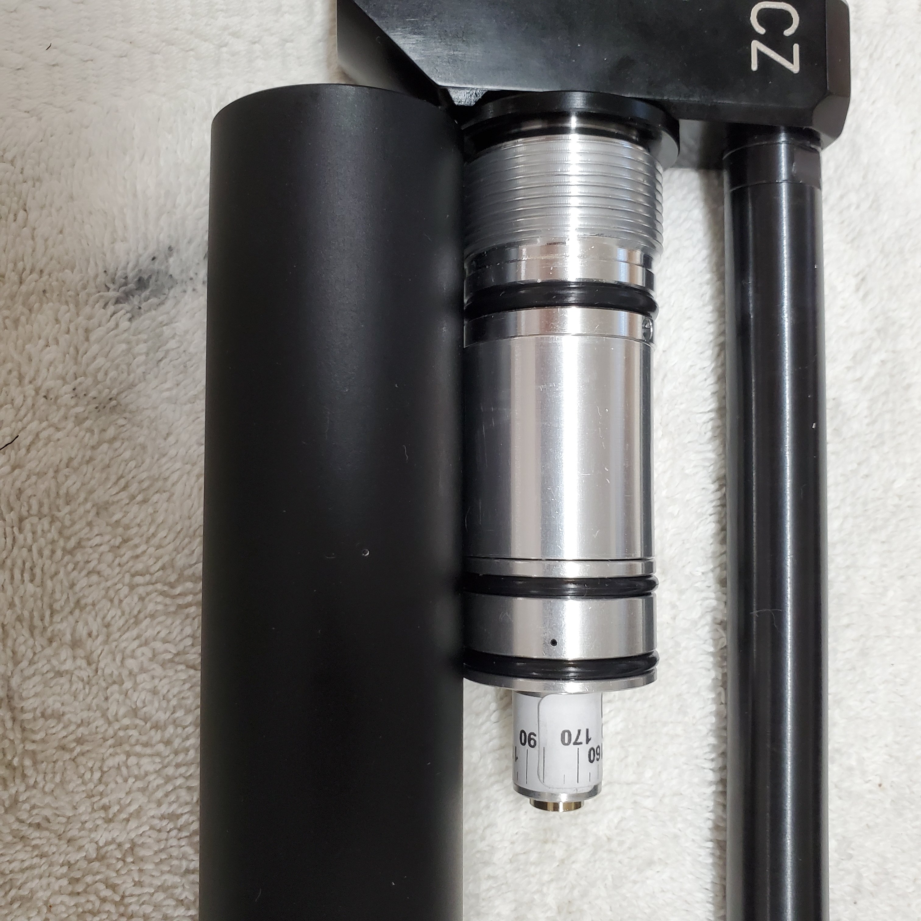

What was the head size on those?Cut my spacer down tonight, got it shooting around 890 very accurate with h&n barracuda match 10.65 grains reg set to 100 bar...
