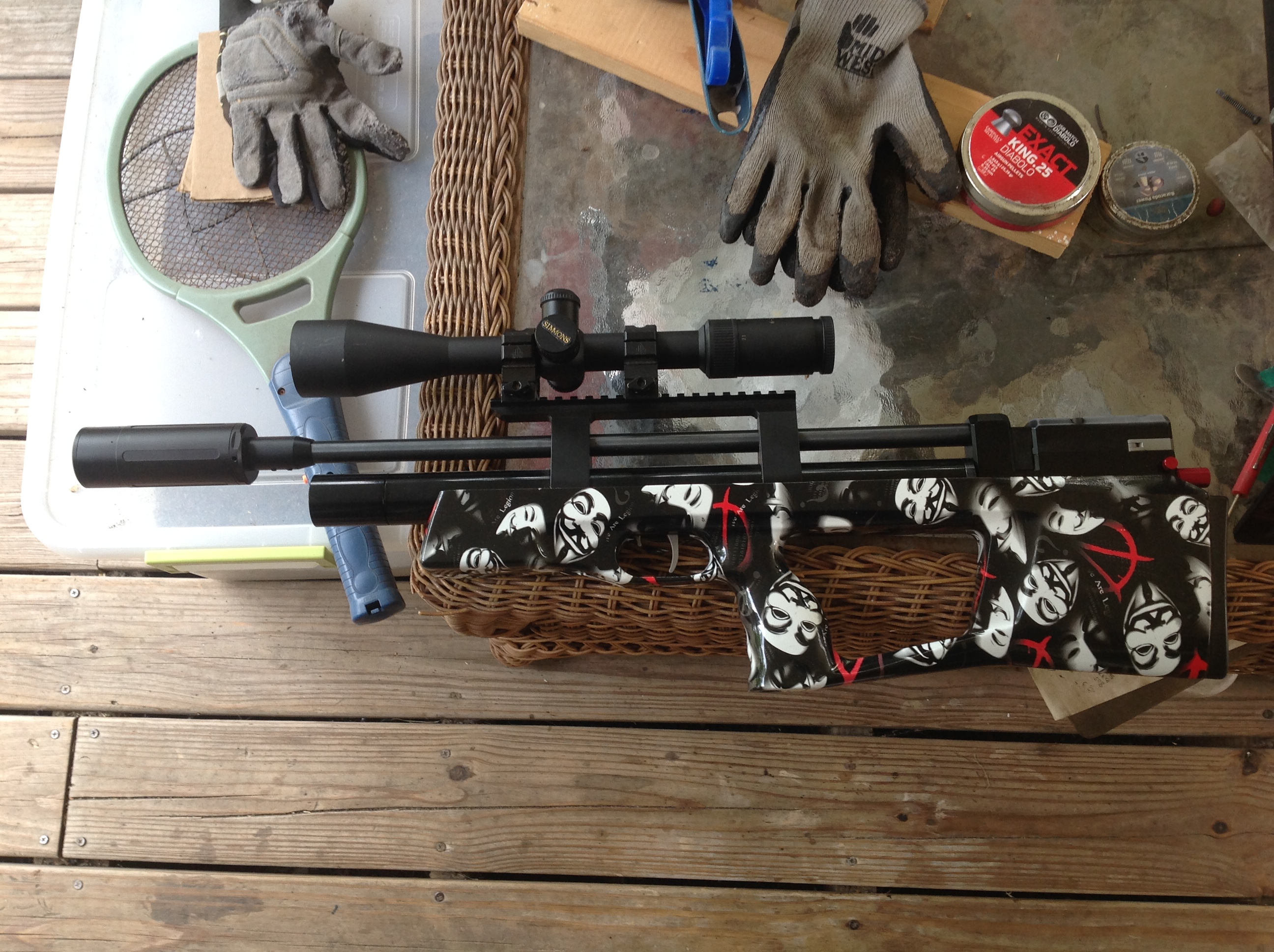

KyPop, have you pulled the barrel and pushed a pellet down her yet? is there a loosesness or a catchy edge at the crown, when the pellet head exits the barrel
still kickin chickens here just got new rings for the P-15, put one of those kits for, forward cocking from the English chap, need to raise the SWFA 10x up a little for a higher cheek weld due to the kit. If I was to do over, I just get the P35, but not going back
my avatar is her
I didn't. I had the barrel off and cleaned it per Motorhead's instructions, though. My wife is ready for me to give up on my quest but I still would like a .177 that shoots with a low fpe and great accuracy at some distance.
The .177 was loud where I had the reg set at 100 bar and it wouldn't group. So, I took it out and set it to 120 bar which is what HUMA said was the average for all FAC .177 PCP rifles. I shot what could be some promising groups with the JSB 10.34's with a 4.52 head at about 915 fps. Way faster than I wanted but I guess I'm gonna have to do what the rifle dictates instead of imposing my will upon it. All of my pellets have a 4.52 head and I'm thinking of trying some with a 4.50 and 4.51 head just for kicks.
I know there's a boat load of physics involved in sending a piece of lead down range with air pressure. I get that. But, it seems to me like the manufacturers of the rifles could come up with a step by step process of working your way through the physics to an accurate outcome.
