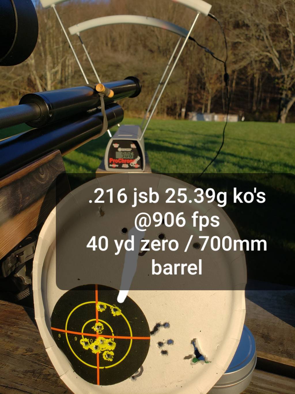

I'm approaching being frustrated again as I just can't seem to get this damned thing to shoot anything over 23g in .217. I'm eyeballing that other tin of the .216's - I accidentally purchased those when I was using the original LW barrel - it didn't like them but LOVES damned near anything in .217. "What have I got to lose . . . " I mumble to myself - may as well give 'em a go and see what happens.
. . . . . . . pew. Whoa. pew! What? pew! pew! What?! What!? Are you kidding me . . . .?? 906 (avg) and these *are working* - like - they're friggin' grouping - pretty well too. No friggin' way!!! My hands are freezing by now but I load up another magazine with these .216's and grab a splatter sticker and walk it out onto the piece of paper I've been using. I walk back to the table and just shoot two over the chrony to make sure I'm not on crack - 908 / 906 - ok. Let's see if I can hit this thing.
I'm going to test with these .216's again tomorrow - maybe speed 'em up to 910 - 915 and see if they'll tighten up. Shrug shoulders - shaking head. I don't know, I won't even pretend to understand it or what / why this barrel likes .217's up.to.a.point (23's) and then ( apparently? ) switches off to .216's for anything heavier. (??) Whatever - I don't care at this point - if and when I find something that it likes - be it .216, .217, .218 or something else - that's just what I'm going to use.

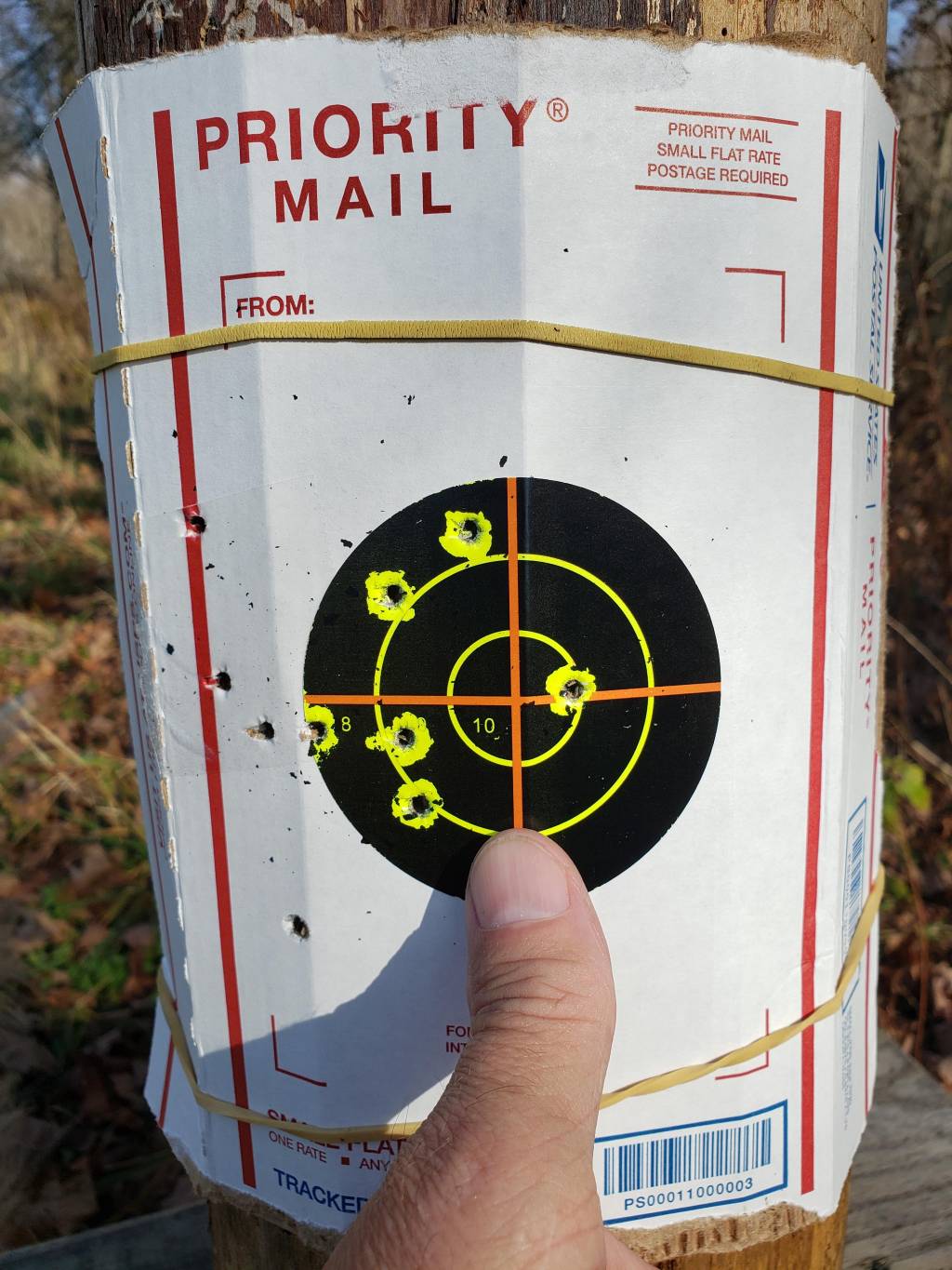

Still leaving the gun at the same tune - I ran the 27.5's through it and . . . whoa. :) 974avg and these were grouping extremely consistently and super tight at 41.
* oh yeah -- I zero @40 but I 'eyeballed' the test target when I set it up today and when I did finally measure it with my rangefinder - 'eh - I was off by a yard. Close enough . . . lol *
. . . so back to the 27.5's. These things kick ass - I may run with these vs. the 31.2's

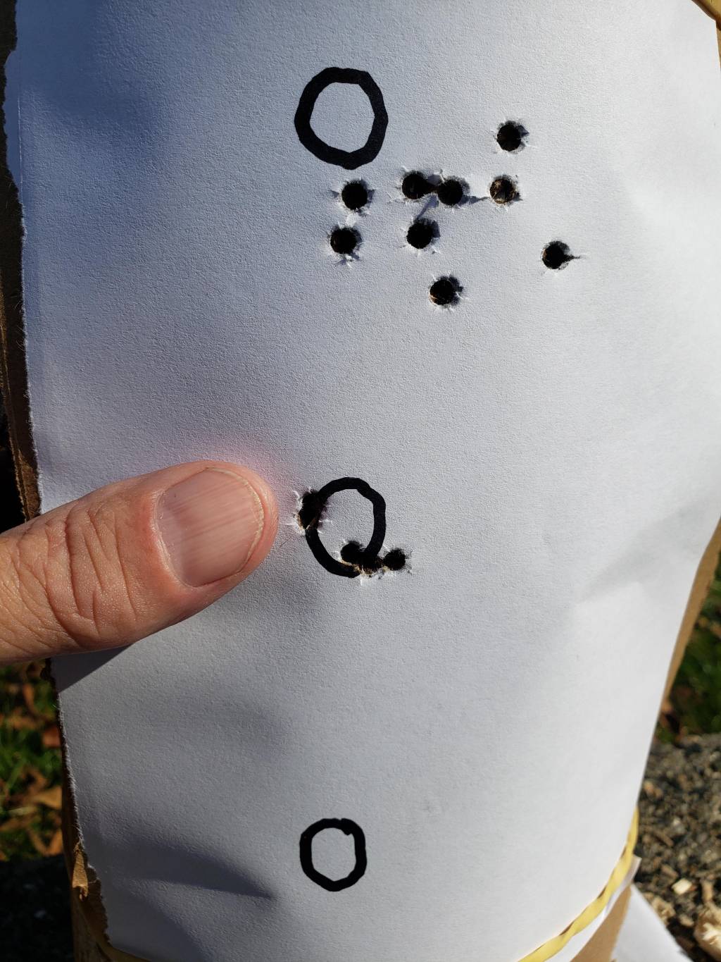

Pics below were with the 31.2's. The top circle was the first 9 shots, aiming at the circle, and dialing in the speed via the HS. The 3 at about 5:00 is where it seemed to tighten up pretty good in the low 920's. I adjusted the crosshairs on the scope and loaded another 5 into it and went at the second circle below. I was happy with that. ( at this point still thinking I was zero'ing at 40 - not knowing it was actually 41 . . . whatever. lol )
Happy with that second group at "40" I decide to setup out at 100 -- I grab my rangefinder and setup another target out at 100. Only after I get back to my seat and dial up what strelok tells me I'll need for this 100 attempt do I think to verify my 40 . . . {sigh} ( strelok ranging might be a little off . . . ) Whatever - I'm just happy as a pig in doo doo that I've *finally* got this barrel shooting half decent. :) As you can see below and as mentioned above - wind was pulling them a bit - once I figured that out though - 'eh - not bad. Not great - but - for my first time shooting 100 in a while AND what with all of the issues I've had getting this 700mm barrel to shoot anything half decent - I'll take it!!
