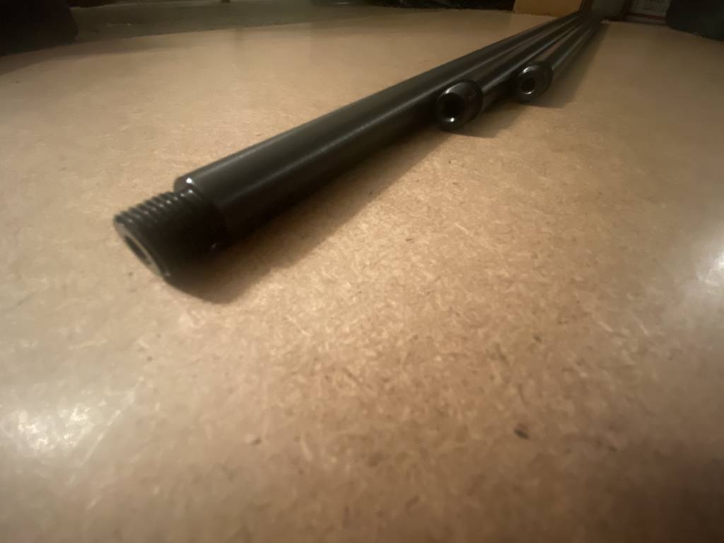

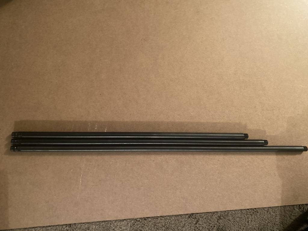

An interesting turn of events today! I decided to spend some time re-evaluating these two new 700mm CZs that I've had stashed away for a few months. I knew they had tight bores, super-conservative chamber throats (chamber "leade in"), and unintentional chokes in them (likely from aggressive machining / threading operations at the factory.
My prior experience shooting a 700mm CZ was in a friend's rifle was anything but spectacular (3-6" at 100y no matter what ammo I tried). I figured if worse came to worse, I would chop one down 100mm and see what happens 😂

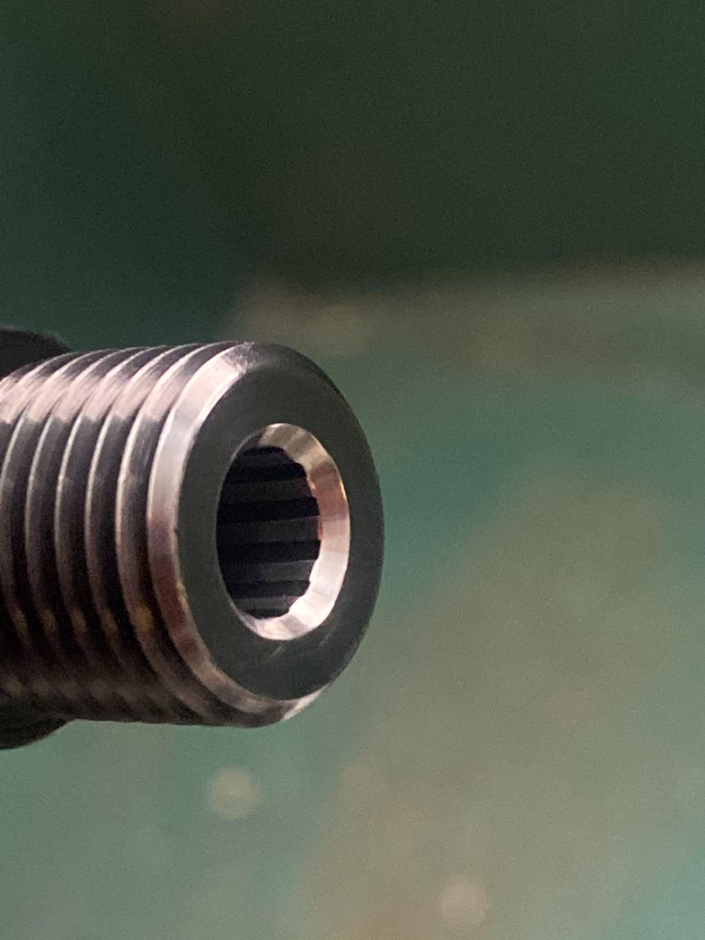

Longer story short, I realized today that there were common problems with these barrels (and likely others out in the wild) - the primary issue - they both had some burrs at the muzzle crown! These burrs are like a big fat speed bump for the projectile exiting the barrel. I pushed an 18gr JSB through the bore, which started off a little rough, then smoothed out until it hit a slight choke (3/4" from the muzzle), where it then came to a DEAD stop right at the crown!

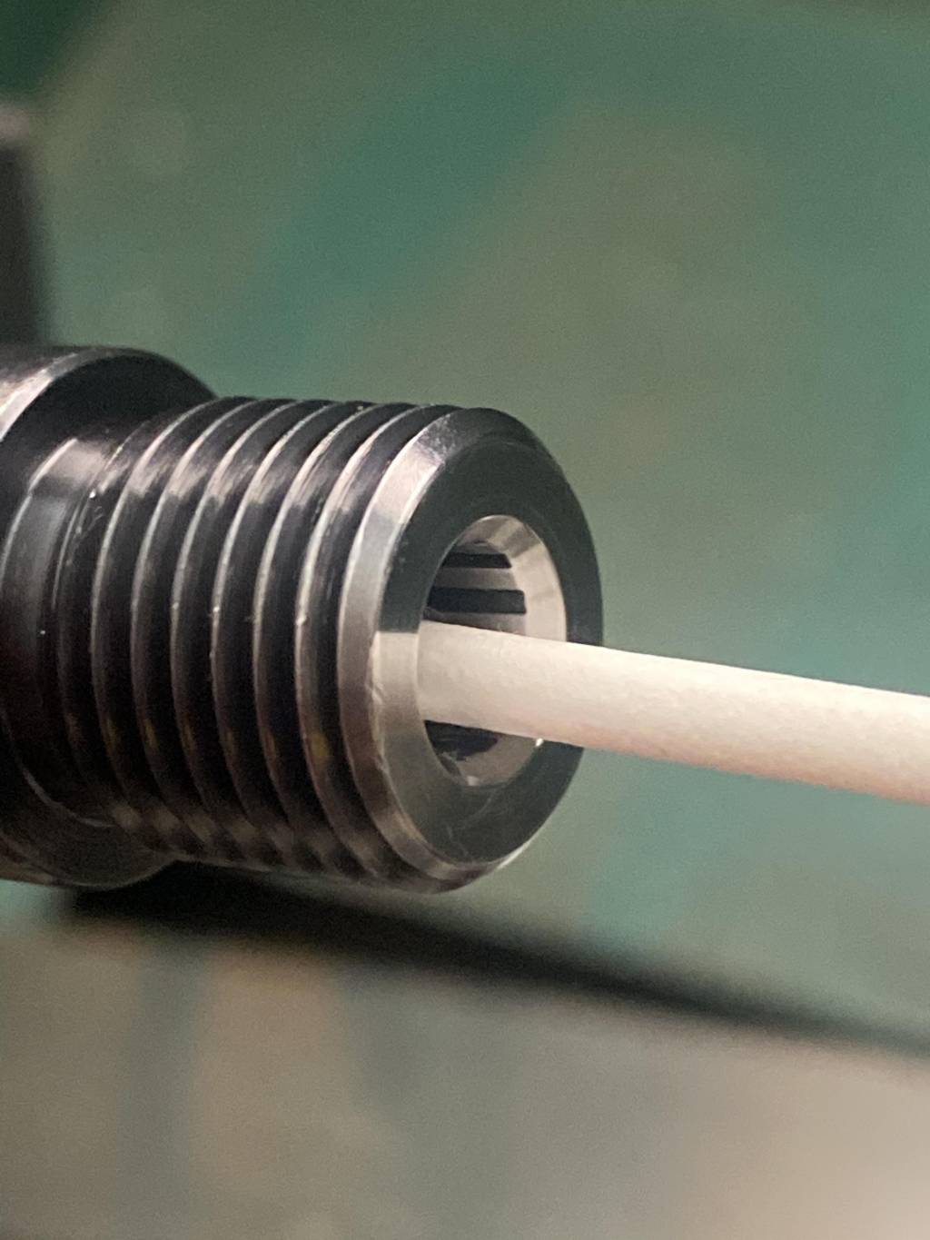

Made an attempt to lap it away with my brass lapping tool, but that failed because it was too recessed. I could see that it was going to take some effort after I saw it through my 90 degree borescope attachment.
Being late in the day and a little burned out on barrel machining and unmotivated to set my lathe back up for barrel turning (I had already machined two other custom barrels this week and stowed away my 4-jaw), I decided to use my .22cal hand crowning tool, I just needed to make a new brass pilot for it matching the diameter of the crown burr, and I would then cut away the burr while making a new 45 degree crown. I had already made a CZ .22 brass bore pilot anyway, so this plan made the most sense.
After two passes with the hand tool - bingo! My CZ bore pilot fit and I finished up the new crown. Probably the largest 45 degree crown that I have made to date, but hey it worked 😂
I could probably face it a little and shrink it, but who cares 😂
So how does it shoot? MUCH better than the first 700mm that I shot! Although, I was ill prepared today making the last minute decision to test it. I was rushed to install the barrel, scope the rifle, and race out to my shooting spot (it's illegal to shoot here after 5pm now!). I turned up the reg from 100bar to 150, but forgot to put in a heavier spring. It was also very windy as usual, and I didn't grab all the ammo that I intended to test - but I only had about an hour before I had to pack up and leave.
Even with the suboptimal velocities, it was still printing 1.5" in the wind with 24.8gr NSAs, 24gr (2S nose) Varmint Knockers, and 32.80gr XLHPs. The few Monster RDs that I had were in two tuns that have been at the bottom of my range bag since late 2018 😂.. but they show STRONG signs of doing well with these barrels!
If anyone needs guidance for getting your barrel to shoot right, let me know. ALSO, very important - I also discovered a while ago with my 550mm CZ that reinstalling these barrels can be TRICKY!!!! There's a tendency for them to bottom out in a way that they're incorrectly oriented! If you were to torque the barrel down real tight with the barrel skewed non-concentric, and if you were to torque down the caps on the trigger housing, your barrel would be ruined (bent)! There's a process that I've developed that I can share at some point, but feel free to ping me if you need help 👍

As for these CZs, I couldn't be happier. Cutting one of them down to 600mm to see how it compares with the performance that I had with the "magic" 600mm FX slug A liner that I ran for a while (I actually wore that liner out after several months!).

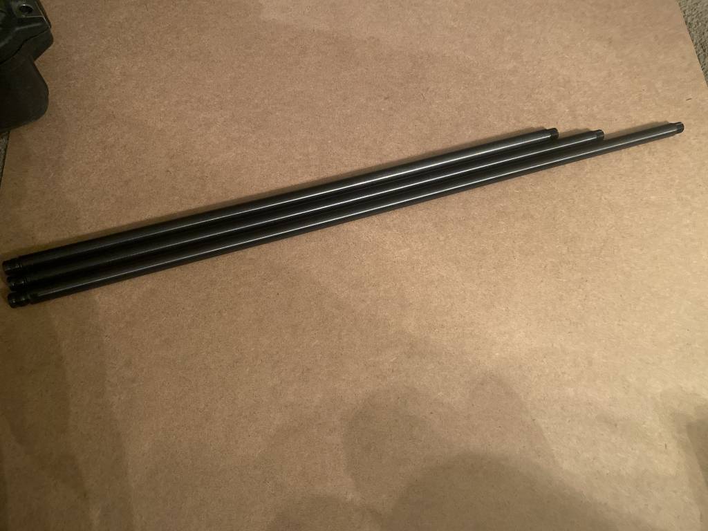

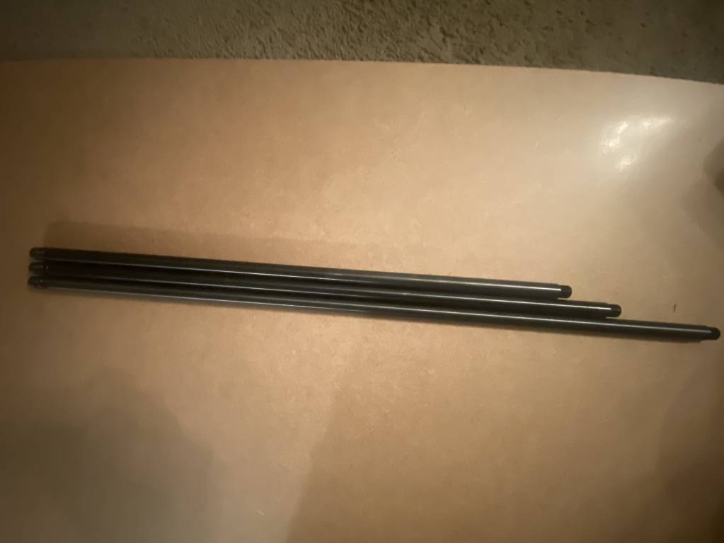

I chopped off 100mm from barrel #1. Got it down to 600mm on the money. Did the re-threading > crown > polish dance and modified the chamber throat so that i
t seats the larger boat tails (29-40gr) MUCH better now.

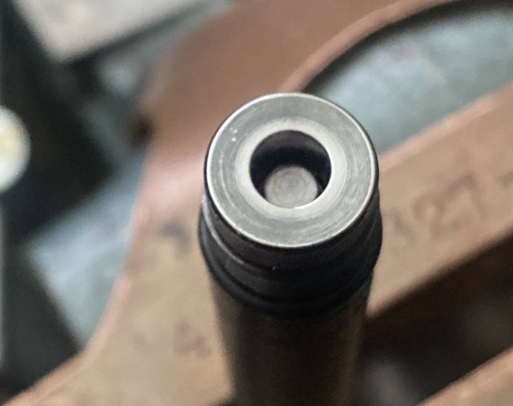

Here's a 29gr RBT dropped into the breech. It stops just a hair short of the depth that the factory pellet probes load them to:
Just need to re-blue the areas that I modified (ran out if acetone lol), and then get it installed for testing tomorrow. This test should provide a lot of insight on the optimal chamber geometry that I'm OCD about!

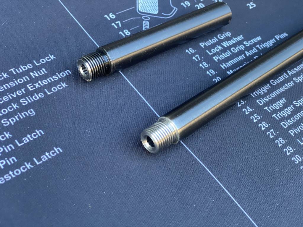

Bedankt! Yes, the choke is definitely something that has to be examined. I have (4) of these long range CZ barrels right now, plus some factory pellet CZ barrels that I adjusted for ~24-27gr slugs. Each choke is a little different, some are tighter than others, and some appear to be "abrupt" (where the bore goes from smooth to extremely tight in just a couple of mm).
Regardless of how long or tight the chokes are, I have had great results polishing themI just polish them very gently and meticulously until I can push ammo through the bore nice and smooth by feel. It doesn't take much effort, so it's better to spend more time with less abrasive polishing materials than with less time with highly abrasive polishing materials.
From all of the time and testing that I have done (quite a lot), a "slight" choke doesn't hurt anything - however, you have to run patches through them more frequently than cleaning than an unchoked barrel. They benefit pellets and smaller airgun slugs the most, but they seem to cause accuracy issues with larger slugs (unless you clean the bore after every 30-40 shots).
There's too many small details to describe in this post for barrel machining / polishing / fine tuning operations, but if I could filter down the things that are most important to me for obtaining the best results - I'd say (in no particular order):
Concentricity - the bore should always be concentric from end to end and the bore diameter should be consistent (overpolishing with a lathe or rotary tool is VERY dangerous!).
Crowning - it needs to be square obviously. Now there are some that say the chamfering angle doesn't matter, but I actually prefer 45 degrees. Reason being - I have had perfectly square 11 degree crowns and some other angles cause some issues with moderators attached. I also round them off a bit at the outer chamfering edge by hand on my lathe. I won't argue with anyone about this nor will I spend any time theorizing. For anyone that doesn't believe me - use whatever angles / geometry that you wish.
Chamber & throat - this is a critical part of the barrel! I commented last night in another thread on this topic, I prefer 2 degree reamers and I ream them just deep enough to seat my smallest projectile in the rifling. The projectile MUST seat concentric to the bore, and not sit too low at the end of the throat (or worst case of all - be sitting in free bore).
It's vital that no chatter marks be present in the throat / bore from the reamer. It can also be devastating to overpolish the throat, however- it must be absolutely smooth. Otherwise, you run the risk of damaging the projectile during the loading / chambering cycle and/or the shot cycle itself.
