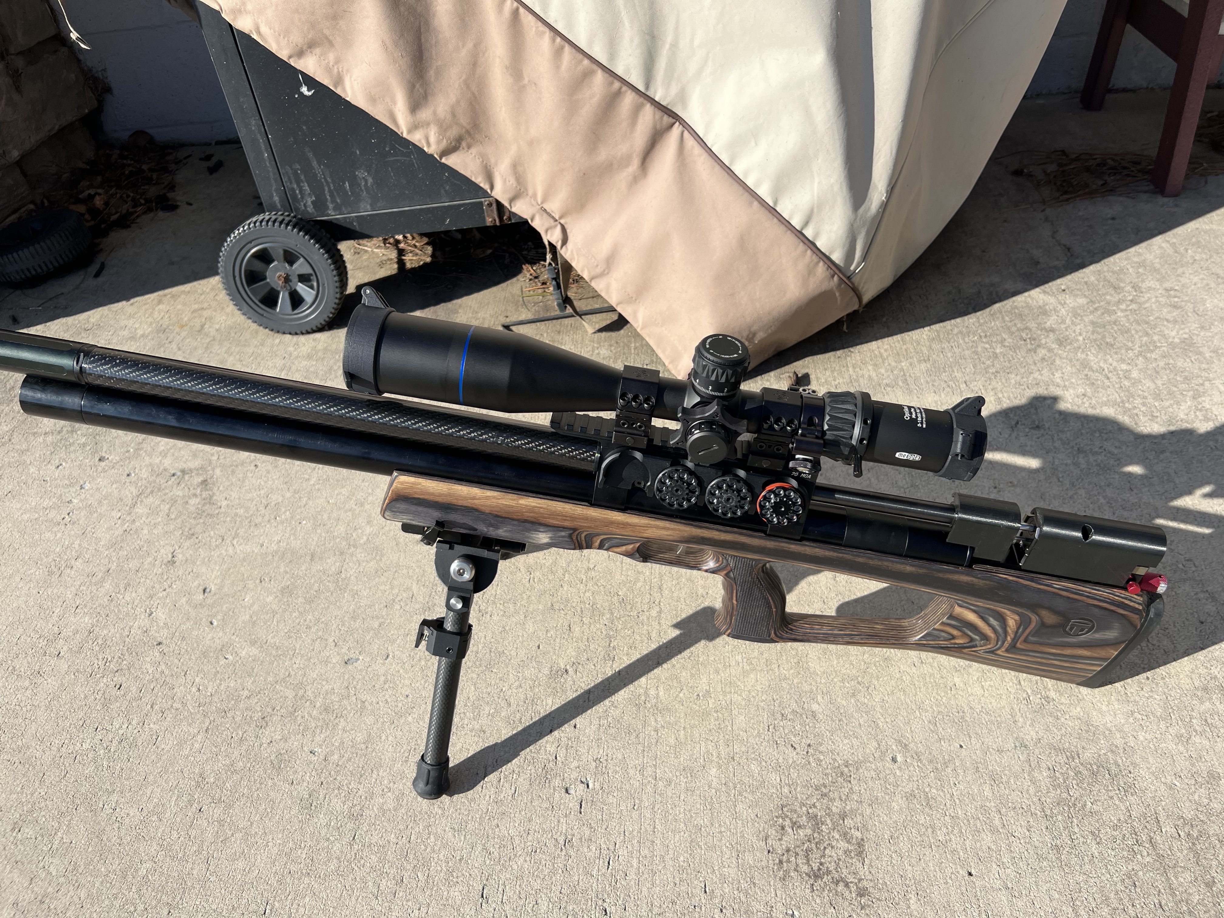

I finally finished the build of my Taipan Long transforming it into a slugger. 700mm CZ barrel, dual power plenums, a custom carbon fiber barrel tensioner, and a nylon washer behind the stock spring. With reg at 130 bar it’s plateauing with FX Hybrids around 1040 fps. I’m quite happy with the power output now to see what kind of accuracy we can do.

Always beautiful thing seeing a Taipan getting the treatment. My only concern is I had read that the 2 plenums in line were NOT effective as you would intend. Did you bore out one to enhance faster air flow to refill both plenums after each shot? But it is a very nice looking set up.
Good question, I've heard the same. I don't see the downside to a too large of plenum, however...and with this kind of fpe at 130 bar I'm not complaining. Also, the longer air reservoir makes the barrel look not quite so long.

I was shooting for 925-975 fps with the Hybrids, but the current 130 bar reg setting is too high for optimal performance with the 22 grain hybrids. I'm going to run some 24.8 NSAs through it and see what kind of speeds that gives me. If I can still hit 1000 fps I'll be thrilled. That would put me at 950-970 fps as the ideal HST setting, perfect speed for these 22 caliber pills...hopefully.
The barrel tensioner system that I installed worked out well because I can actually unscrew the DonnyFL KOI moderator from it's 1/2x20 unf cap which is screwed directly on the end of the barrel and serves as the nut that tensions the barrel. This makes transportation quite easy and the length without the moderator is only 1 or 2 inches longer than the factory Taipan Long. Is the carbon fiber barrel tensioner necessary? Not really, but it's definitely very stiff for a 700mm barrel; even stiffer than the factory 550mm barrel was.

Wow beautiful set up
After playing with the NSA 24.8's in .216"-.2175" sizes, Sniper showed a definite preference for the .216" and .2165". With the current reg setting(130ish bar) she pushed them to right around 1,000 fps max velocity...so I backed the HST down to 950 fps(49 fpe) and that's where I did all my testing with different slug sizes. It comes to me now that I should have experimented with velocities from 925-975 to see if I could really dial in the accuracy potential...but I've since switched back to FX Hybrids. On the accuracy of the NSA's, I was achieving 1/2"-3/4" groups regularly with the occasional 5-shot group at 50 meters coming under 1/2".
I was pretty happy with that...but the starlings weren't. I really put a hurting on them in this area with my longest shot being 85 meters. The NSA's @ 950 fps MV pleasantly surprised me on the terminal performance. The HP really did it's job well with a significant "POP" upon impact and every bird that I hit died...all quite immediately with significant damage to most. I digress...
FX Hybrid's(incidentally, the NSA 24.8 grain slug and the FX Hybrid 22 grain slug have the same estimated BC of .080 despite the NSA being almost 3 grains heavier and .2 mm shorter)...my first tests with the Hybrid's revealed that Sniper pushed them to 1040 fps max velocity which was a bit faster than I initially liked. However, I was feeling in a tinkering mood one day and decided to try them again for grins and giggles. I backed off the HST 1/2 a turn and shot a few...at around 1000 fps and yes, accuracy was not great...roughly 3/4"+ groups at 50 meters. So, I did what I should have done with the NSA's...played with the speed dialer to experiment with velocities. 875...no good. 940...money! It still needs further tuning but currently I can regularly put 3 shots under 3/8" at 50 meters. Also great is that it's using 2.2 bar/shot which means I can get at least 55 accurate shots per fill...I like. So far, I've dispatched a starling at 45 meters, a dove at 75 meters, and a pigeon at 118 meters. Accuracy definitely kills! The estimated .08 BC of the Hybrid's seems close but it's hard to tell without some serious downrange time.
I'm pretty happy with the accuracy results of the Hybrid's out of the 700mm CZ barrel but they are only doing 44 fpe at the muzzle and so wind drift may still be a struggle to deal with if I want to accurately shoot past 100 meters.
Maybe someday I'll turn up the reg and try some heavier NSA's for better BC and downrange performance but for now...I've got six trays of Hybrid's on the shelf and it's hard to mess with this kind of accuracy and shot count...
^5 shot group at 50 meters...130 bar reg, 940 fps, light wind
While it would be nice to be shooting 30+ grain slugs at 1000 fps and doing about 70 fpe at the muzzle, I'm just not sure the factory Taipan valve system here is built for it. I've a funny feeling that even if I could achieve that power by turning the reg up I would lose a lot of efficiency due to air flow restriction...especially in .22. But maybe the NSA 27.5 grain with a .090 BC would be the ticket for helping buck the wind past 100 meter...oh, the rabbit hole!!
I just hate losing that 40+ shot count per fill...

I've always held the stance that Vets just aren't valved for big power. As they come, they're intended to be pellet guns. As that they shine. Sublime shot count (for the volume) and shot cycle. They can be pushed into higher power with longer barrels, plenums and upping the reg, but you gotta smack that efficient valve real hard to make it put out big power and the shot count simply tanks. And the pleasantness of the shot cycle goes away too. And then there's the question of how long is the poppet gonna last when I'm smacking the ever living daylights out of it....

Pretty much what was going on in my head as well...

Not to mention the tube vs bottle and 250 bar max fill pressure...
Yep, there's only so much air there, both that the valve can release and that the tube can hold....
I've got a big long 28inch barrel for mine. I played with it a bit, but was surprised to find the extra length didn't give me much extra FPS. I think it's because the valve just doesn't flow a ton of air at hammer spring tensions that I'm comfortable with ( til it'll just barely still cock with the OEM hammer spring with zero preload shims), and that was even with a plenum addition. I also didn't like how long it was. Wasn't long til I dropped back to the previous 23inch barrel.
I feel pretty satisfied with what I have for now. I really don't have a reason(or place) to be shooting past 150 meters anyway. Most generally, birds and other game are comfortable with letting you get within 75 meters so it's not like I'm giving up everything. I guess it's on the windy days that I wish for a better BC projectile. Then again...these Hybrid's have roughly twice the BC of 25 grain JSB Monsters...shouldn't complain I guess.
