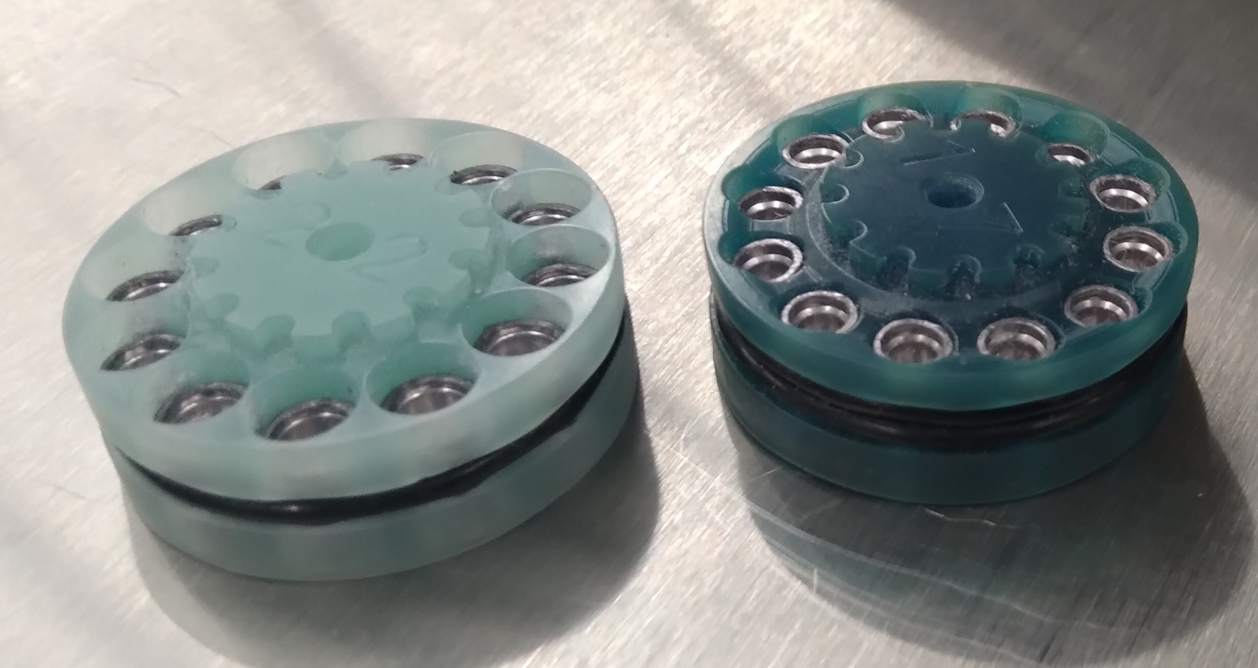

Taipan Mutant resin 12 shot mags coming soon
These are working .177 mags. never thought I'd have so many shots. I'm just research & development lol. I did furnish an original .22 mag.

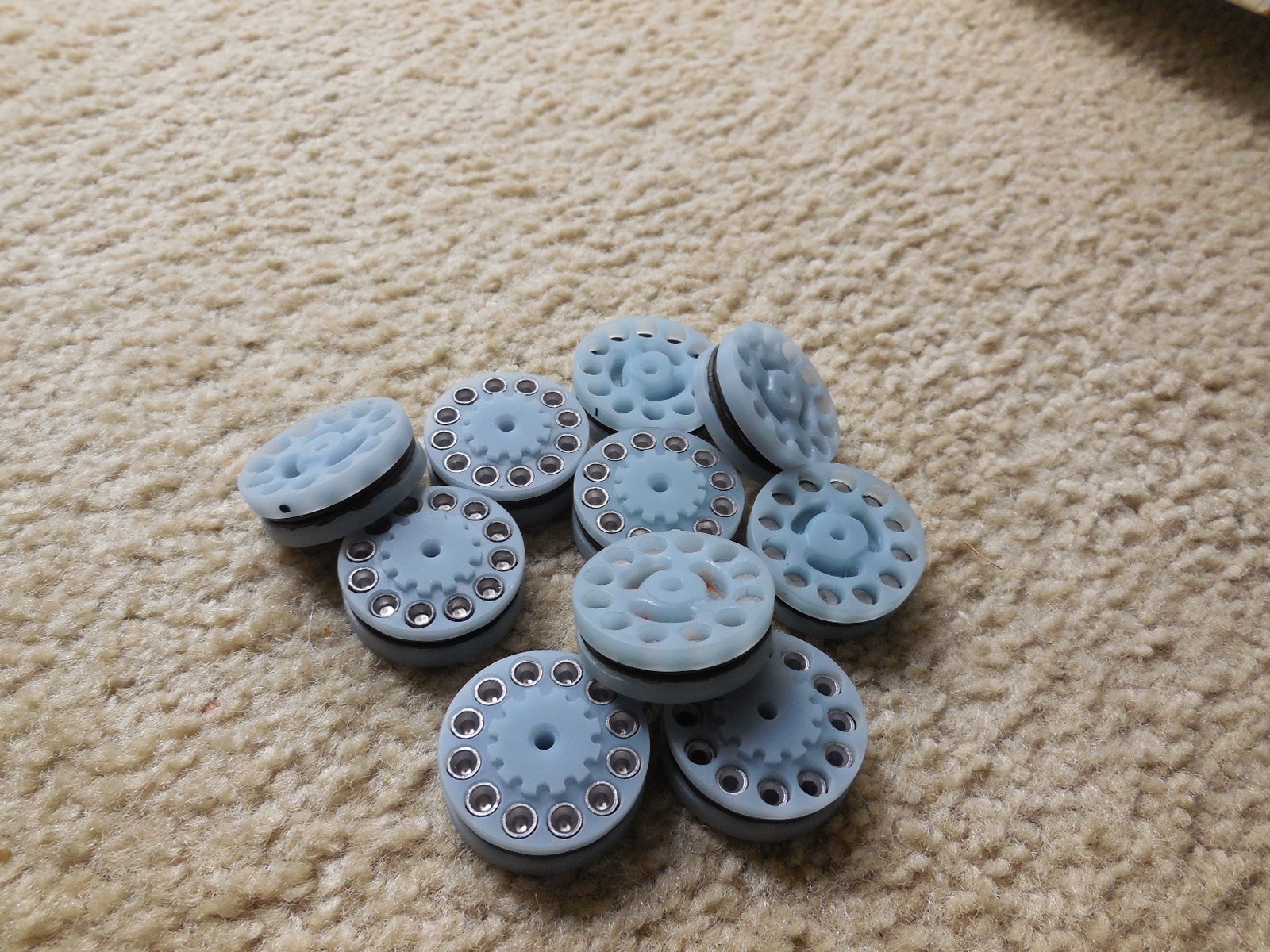

lol I been using 2 mags since 2015 it crazy now I have 14. If any .177 mutant owners are members drop me a pm.

maker let me know ... fragile cause of the wall thickness between pellets. dropping on a hard surface may crack or chip..
I use eSun Hard Tough + Shiraya Tenacious in 3:1 ratio. I wash with EasyGreen in ultrasonic and not IPA (stains), also UV submerged. Bigger parts that are part of tight tolerance assembly - annealing as a very final step. These my parts are very durable and machinable (drill, mill, turn and tap)
