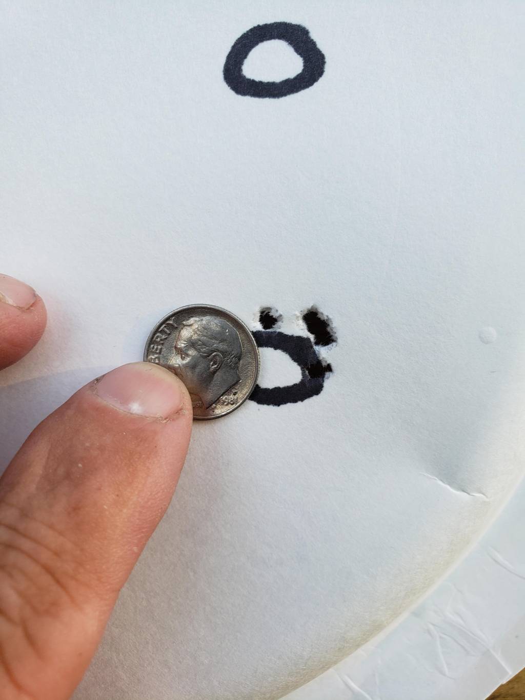

. . . anyway. These finally showed up today and honestly - I wasn't even going to bother testing them as I've got the .177 Taipan dialed shooting the 10.3's and it's wickedly accurate out to 70 yards - probably further but I didn't get a chance to take it beyond that. I wasn't going to mess with it but . . . these Griffin slugs showed up. ( Scratching head . . . " what to do? " ) I'll just load up a magazine with them and shoot it w/out touching the gun - the gun was shooting the 10.3's at 885-890. I set up a target in the back yard at 30 yards and pull the trigger - it lands a little low - maybe half inch. Shrug shoulders - ok - send another two or three and see if they all hit about a half inch low too. They do. (!) Holy crap.
"What?!"
I then ran a couple over my chrony to see just what they were flying at - yeah - 772. I turn up the hammer spring a little over 1 full turn and now at 850 fps I'm getting dime sized ( less then a dime actually ) groups out of it. I'm amazed. And bummed out. This could cost me money - they're not the cheapest things in the world - but boy do they seem to shoot. I'm not sure what the difference is beside the additional .5g in weight ( lol . . . 12.5 v 13 ) but . . . but pleasantly surprised!
