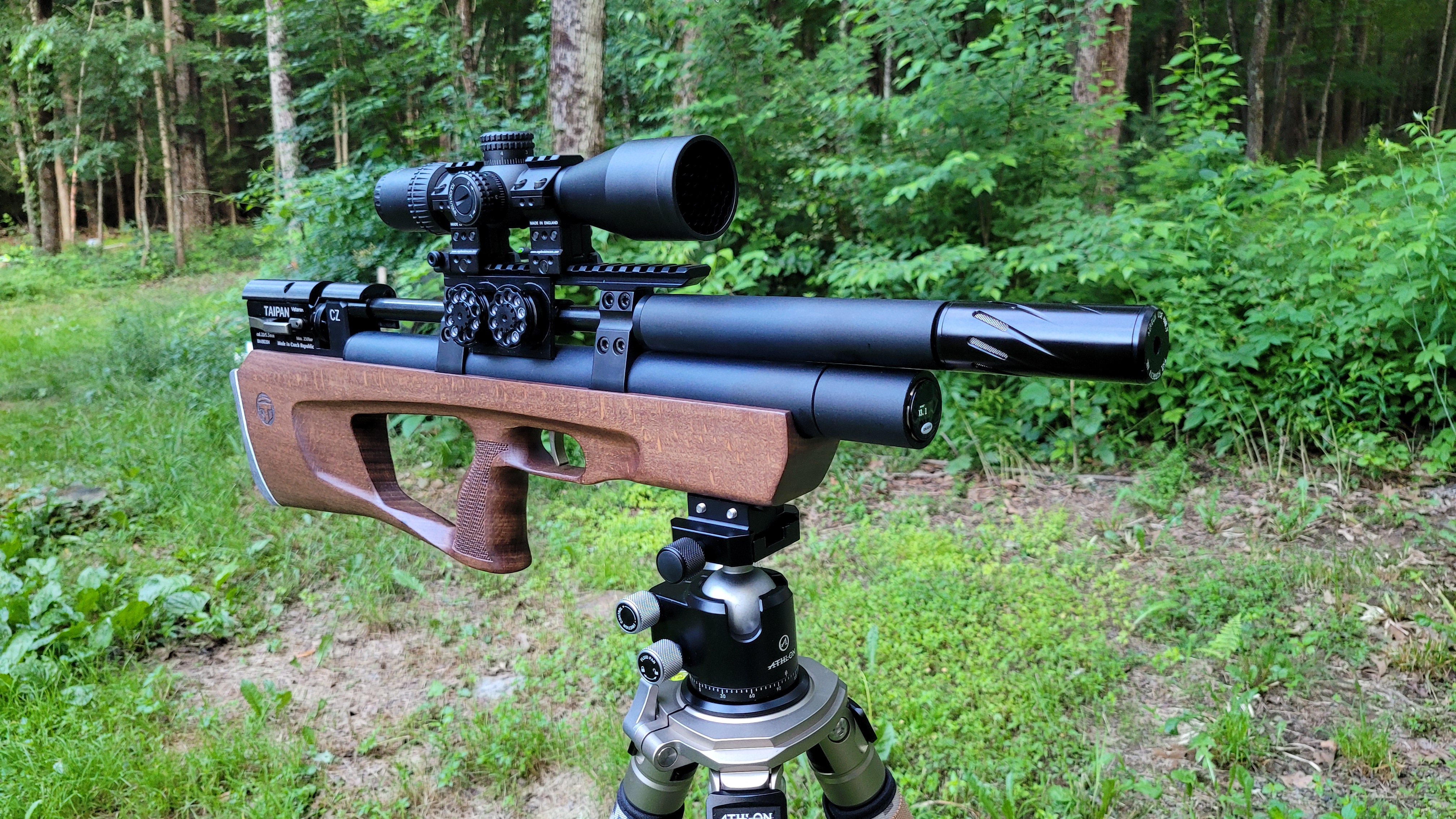

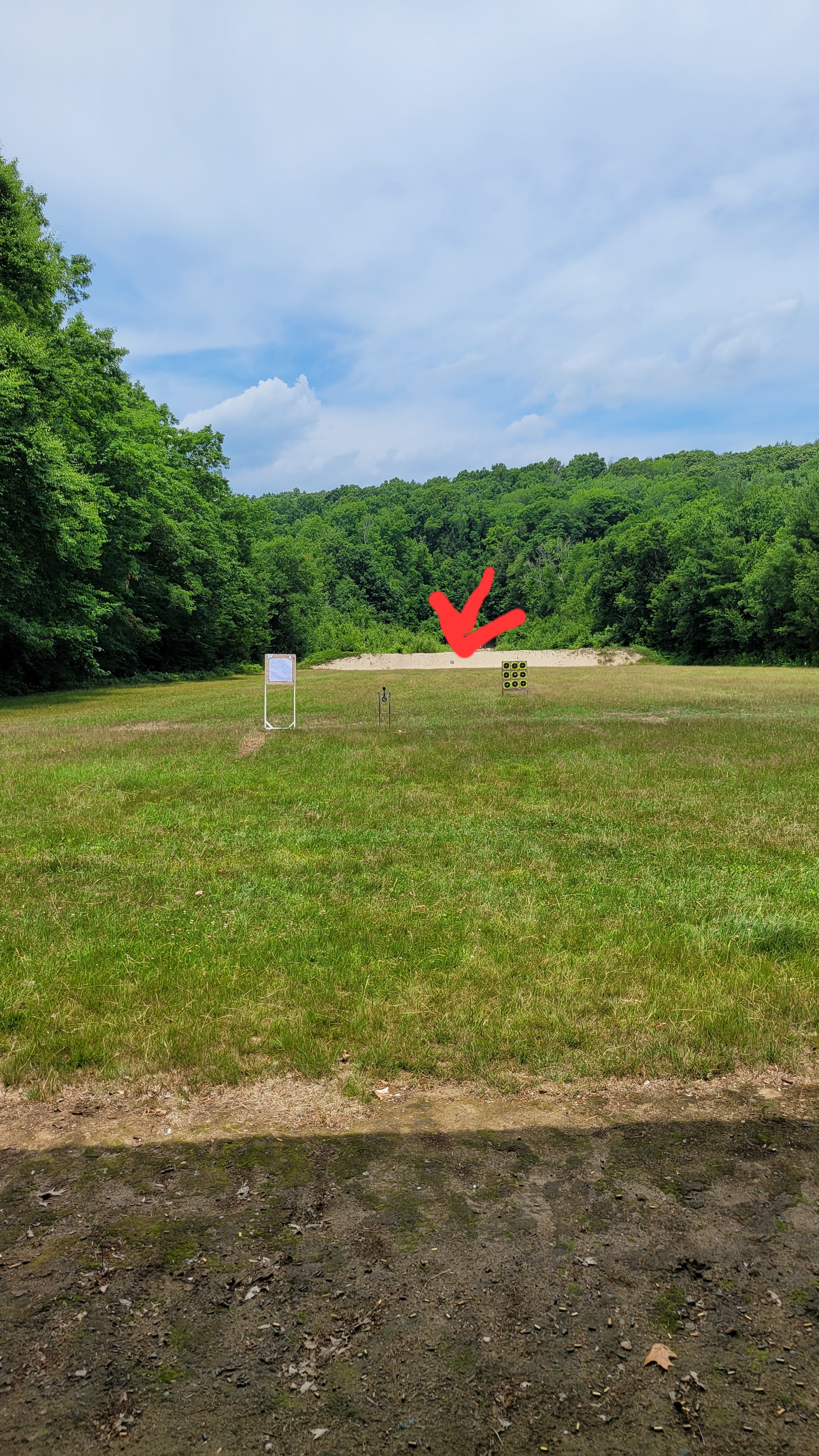

I had my taipan shorty in .22 out Friday breaking clay pigeons on that birm, that birm is 130 yards away! Now I'm not saying it would group well, because I kno it wouldn't but for a compact that's damn good. I wish I had done some 100 yard groups because the 50 yard groups are intense. Oh and it was all off a tripod.

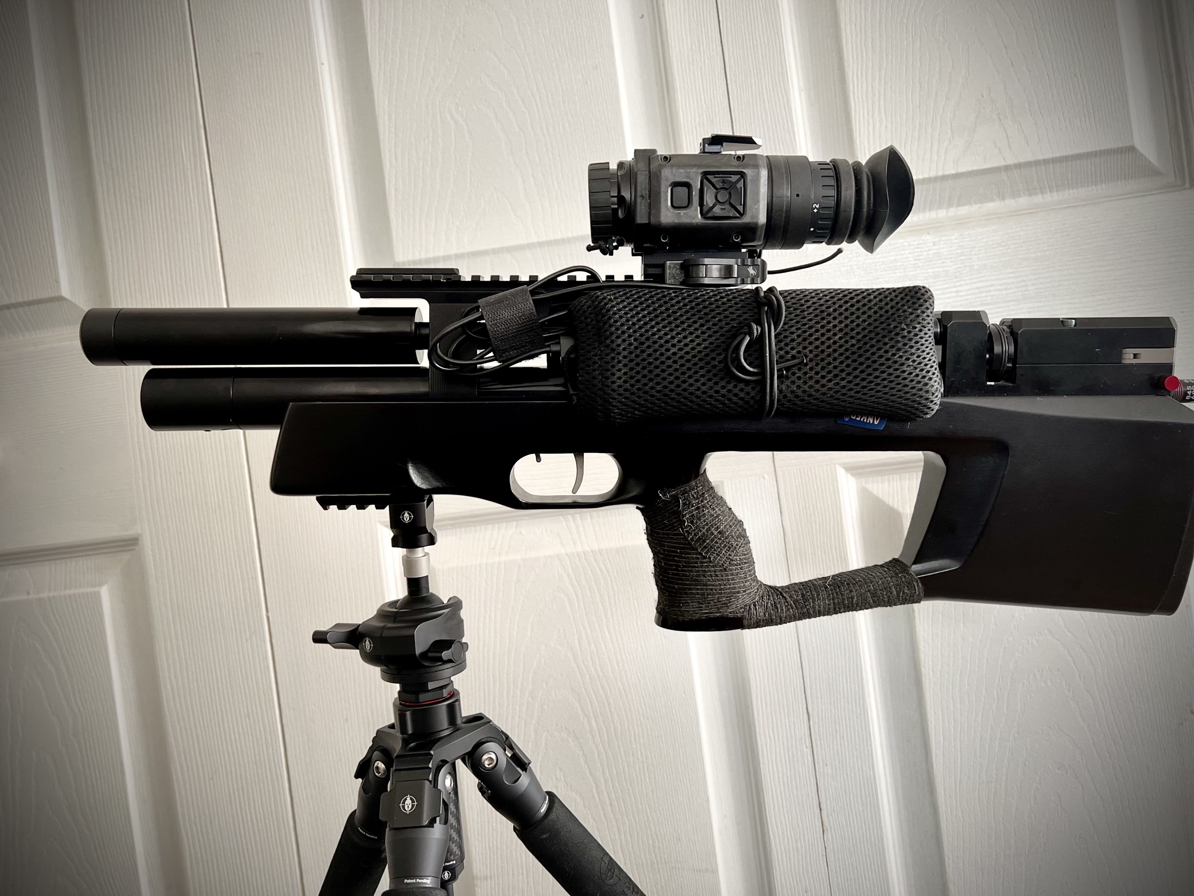

What kind of tripod/ball setup do you have there? I just ordered a Taipan Veteran Standard from UAG with a picatinny rail on the bottom like that, and I just started my tripod research. That looks like exactly what I'm looking for!

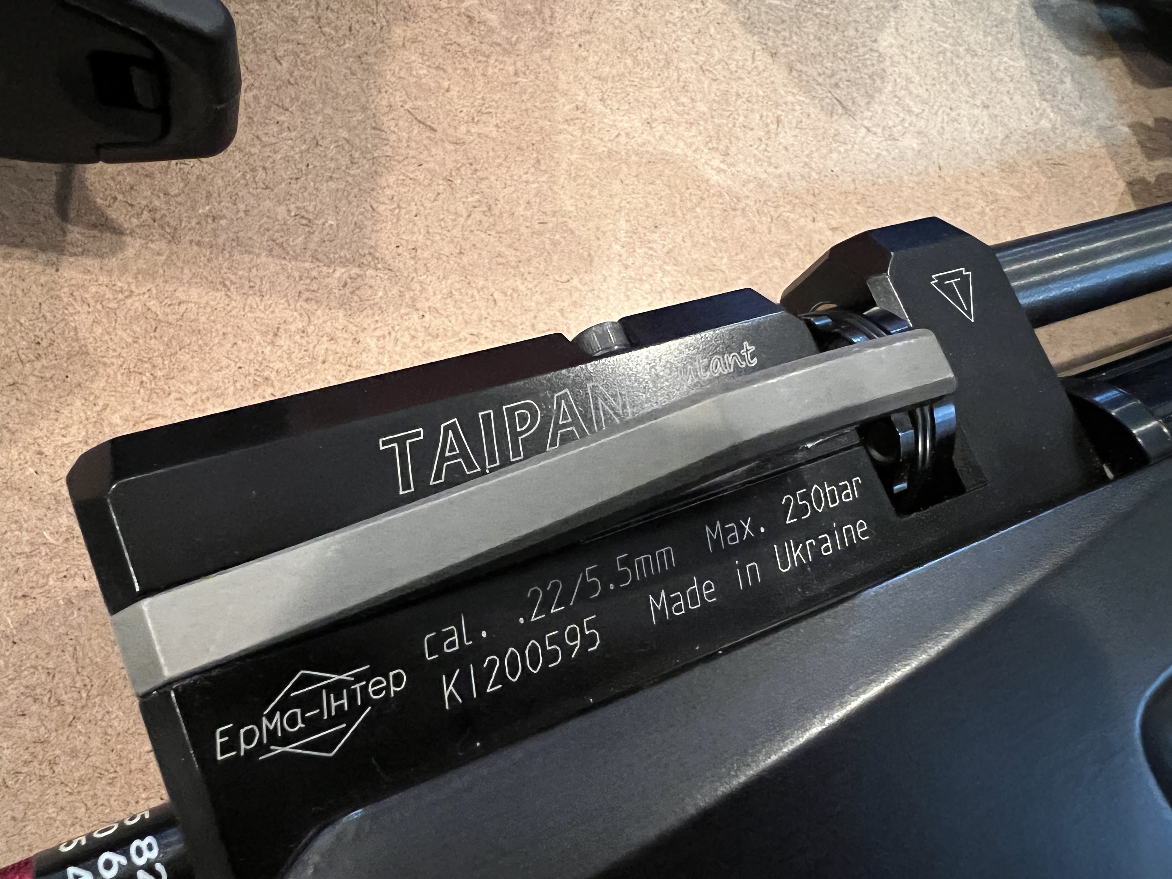

I have the older Mutant standard made in Ukraine. Quality appears to be the same but after trying to buy upgrade parts a few years ago, found out that there are dimensional differences in the Mutant and newer Veteran. The mags won't interchange, air tube is larger diameter on the Veteran, hammer adjuster is larger diameter on the Veteran. I also think the barrels mount differently. Mutant has set screw and Veteran threads in.
