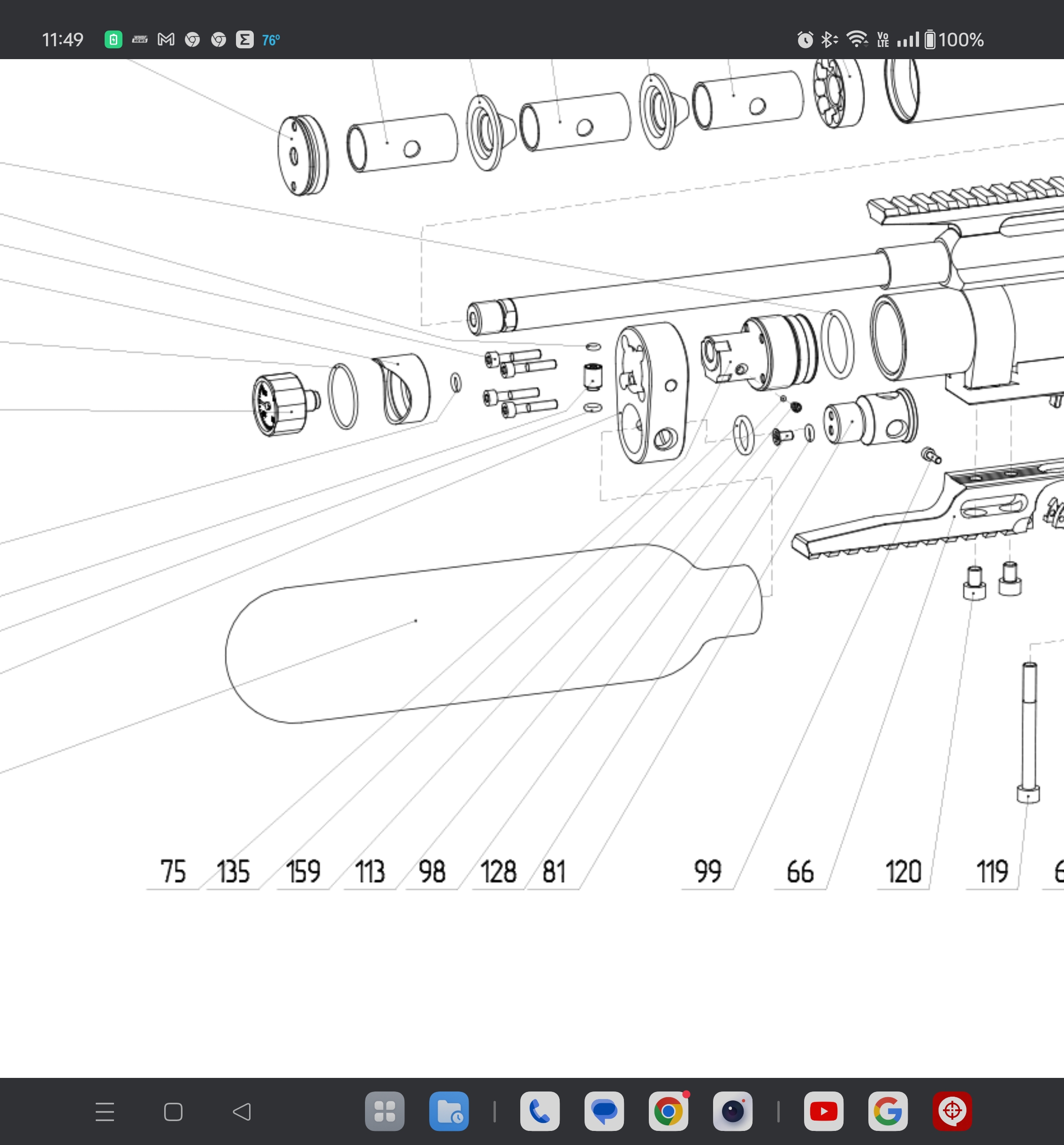

Easy fix....you have to bleed all the air out. Taipan has a video showing this. It's the first o-ring after you take the bottle off.
Reactions: Pfddi
Part 135 which they give you the spare orings....

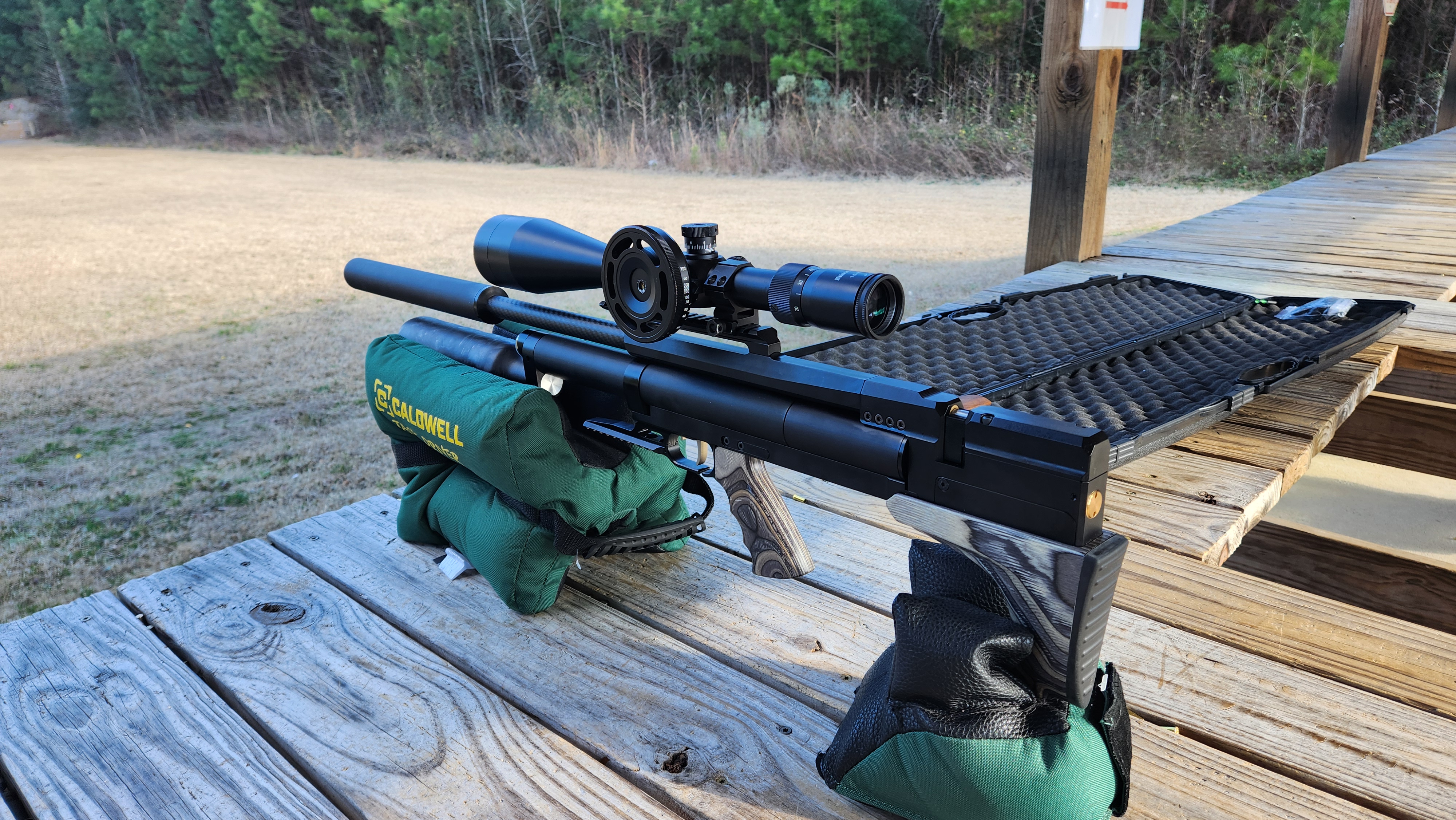

Really great gun!!! Some people just don't like the looks of them but that doesn't better me. Took mine to the range the other day with my Ghost. I didn't even shoot the Ghost...shot the Taipan the whole time at 100 yards!!! Was going to take my FX DRS to shoot tomorrow but might take the Taipan again....here is a older picture.....25cal 700mm barrel likes the JSB KO slugs
