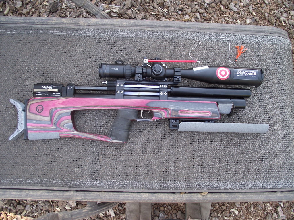

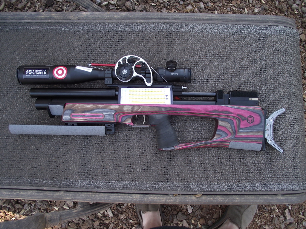

TAIPAN Vet get the Full "Hunter" Field Target set up.
Whoa .. ya don't see this on the FT courses very often

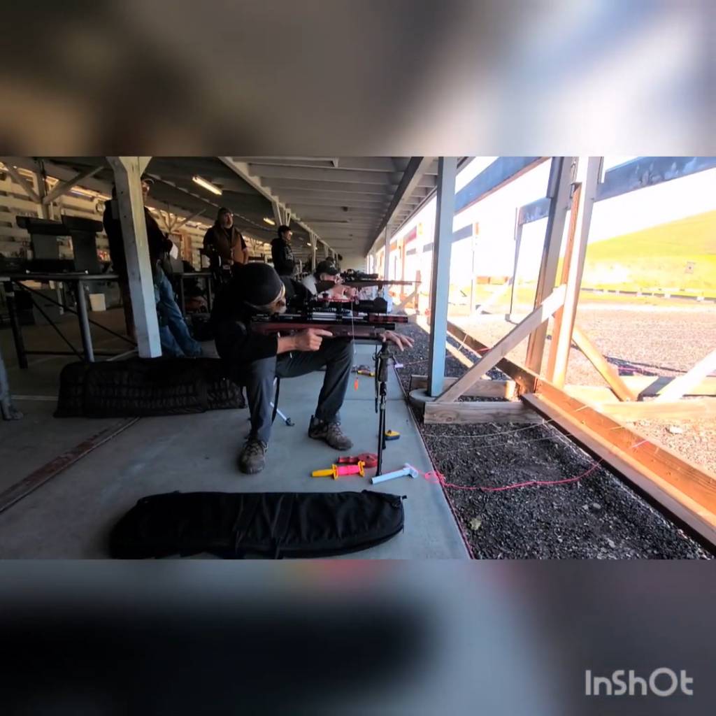

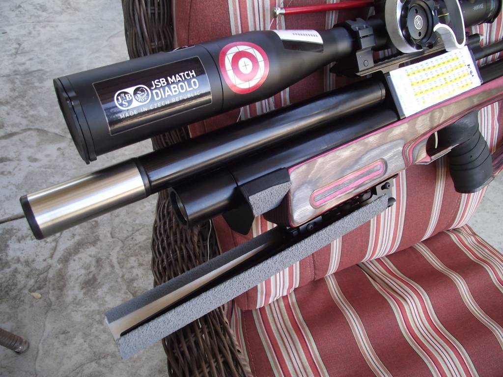

How about a SHORT Bull Pup set up to shoulder and handle similar to a long gun, yet offer far more hold configurations than a long gun.
Shot on shoulder ... Shot across knees ... Shot Deadman too !! It is comfortable doing all these positions. The added front rail and LONG handle/saddle aids in elevated or down angle shooting along with offhand aid as well.
If your on level ground the Long handle can be removed and then you place the V yoke of your tripod into the specialty made V mount on end of air tube.
As set we're shooting JSB Monster 13.4's @ 805 fps. At 50 yards in no wind nearly hole in hole if steady enough. It was used this last weekend at a club match proving it can indeed play the game at a high level.

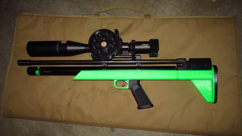

I like the Taipan bullpups. I started with something similar, a Diana Skyhawk with a laminated stock. I eventually went with a 3D printed stock that cut quite a bit of weight.
My FT-PUP. Been shooting it for a couple of years in mostly Hunter Division.
8.2 lbs. with scope ready to go.
28.38" overall length
JSB 10.34@933fps
100 shots on a 25mpa fill (3600psi)

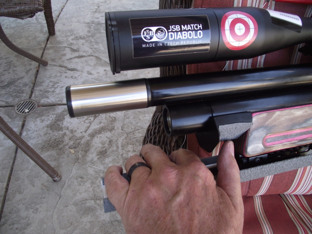

After finishing up some customer tunes this afternoon, decided that my LEFT HAND was in harms way when held over the handle. While one thinks he/she may never have afinger or holding position that may get your hand shot ! ... SAFETY FIRST so I fabricated a Shorty LDC/Extension can to the factory shroud.
As picture shows my hand is now behind the muzzle while supporting it and it is quieter too. Silly quiet.

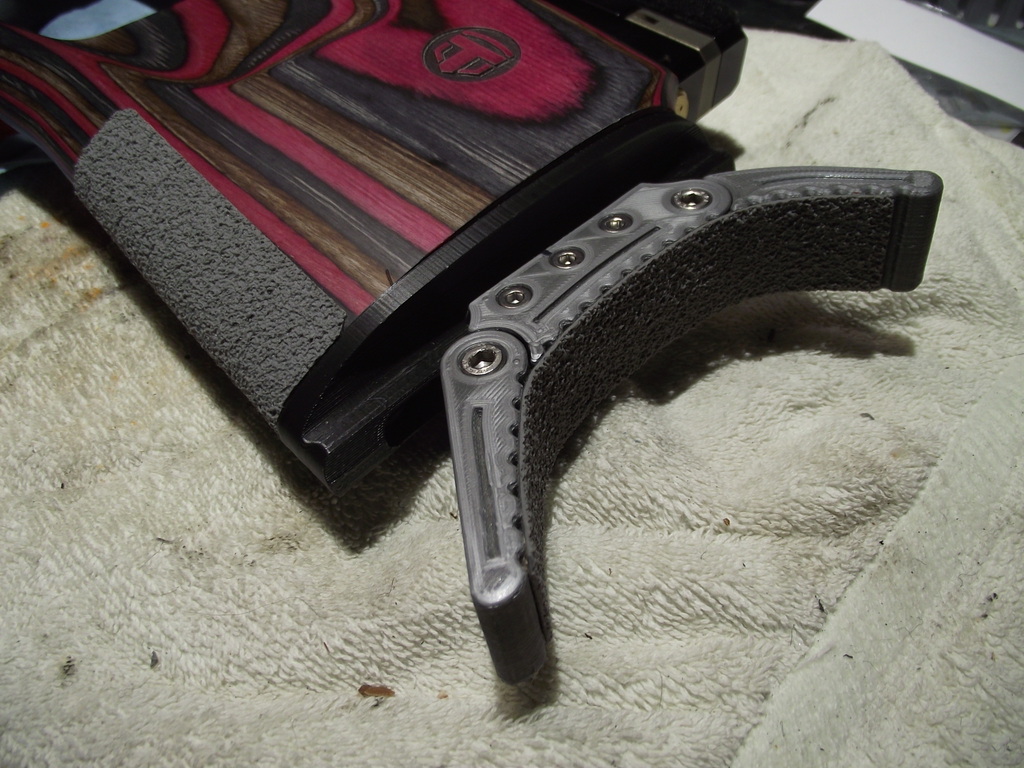

AS too the Sampson adjustable butt plate ( Not technically being a hook BTW ) has had it's adjusted position anchored better via a few daubs of E6000 adhesive.
In the shoulder pocket a strip of 3M rubber traction tape same as what in on the bottom of Butt and Handle. Good Stuff !
Just shot the VET a our local CLUB FT match yesterday. Shooting the JSB "Redesigned" Monster pellet at @ 815 fps the VET shot fantastic !!!
While Missing 1/2 my offhand shots ( My bad ) the vet only missed 2 of 50 shots ( excluding offhand ) in winds that went from nearly calm to 7-8 mph.
IT WORKS and work quite well to my surprise. While it won't be my primary Competition FT rig, it certainly will be my back up gun and be used for club events etc ..
Scott S

Butt "plate" is an adjustable style a buddy purchased from overseas some where ? It is 3D printed having adjustable wings top & bottom. IT IS NOT A HOOK having NO under or over shoulder support mechanics .. SO it is Hunter Class Legal.
How being shot .... Sort of a Deadman position, butt on knee, bipod out front with NO upper body contact outside of Butt Plate in the corner of forearm and bicep.
