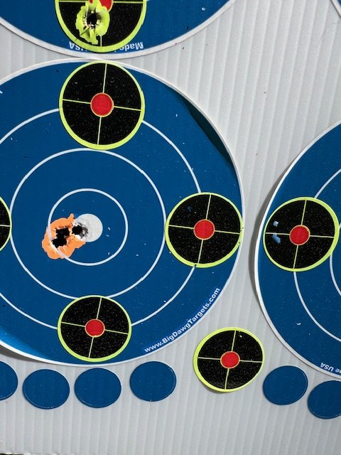

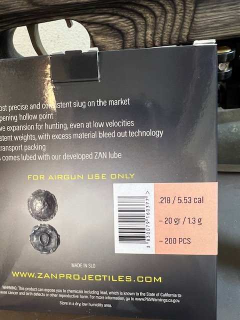

Here is some 1st hand info for you.
I literally just shot this group out of my Vet 2.
The weather sux, well for Texas anyway.. Lol.. High 50's and wind blowing it's ass off, but it does prove a point for ya.
Group is 5 shots @ 40 yards.. ( thats my backyard range limit )
The Top small bull sticker was sighter, the 5 shot group is the center of the blue target
3 pics for reference.
Hope that helps answer your question...

It does indeed... very nice shooting and I guess that's one really nice example! Good shooting! What speed are those Zan's going?

Thanks amigo, did that just for you !!!
btw it shoots the Zan 23gr .218 / 5.53 almost that good too, groups open up just a tick..
Sorry missed the speed question... set up on FX 18.13 @ 990fps, I never ran the Zans over the chrony.. I can once the weather gets back to normal and get back to you, but you at least have a reference with the pellet speeds
Good luck, and have fun !
