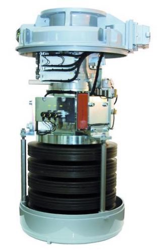

the reason I called them them lock washers is they are used to maintain a load on a bolted connection. I use 1/2" Belville washers made by now made by Solon everyday for electrical connections. I have installed thousands upon thousands. You can probably remember when they used them on automobile front end parts way back when. Are they technically a lock washer? They maintain pressure on parts. I could have chosen the wrong word. Here is an interesting application in this picture. These springs are loaded or cocked by a hydraulic mech. to maintain stored energy to operate a ABB power circuit breaker. They are 30+ " in diameter. I am not an expert on these air guns for sure. And will rely on your experience at times.
https://www.solonmfg.com/using-belleville-springs-to-maintain-bolt-preload
