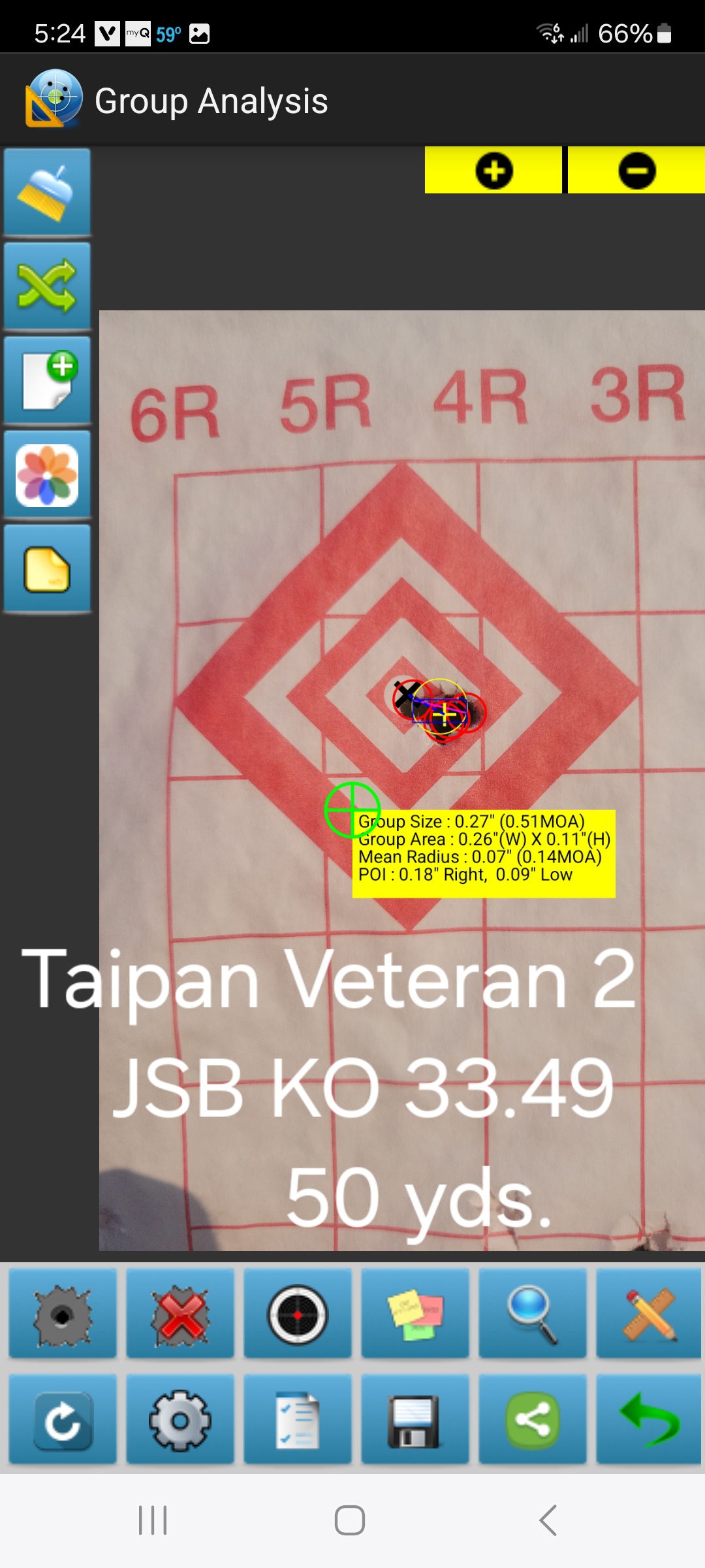

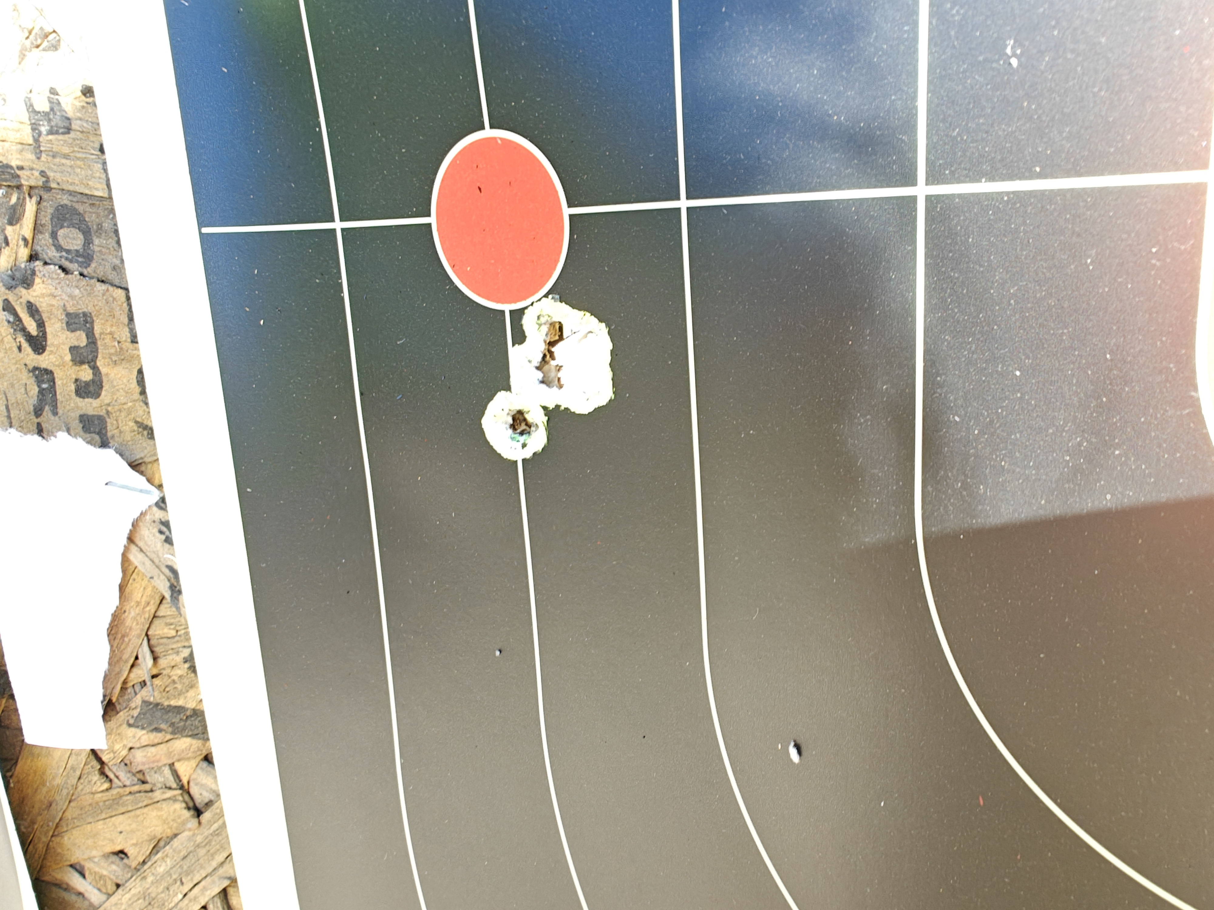

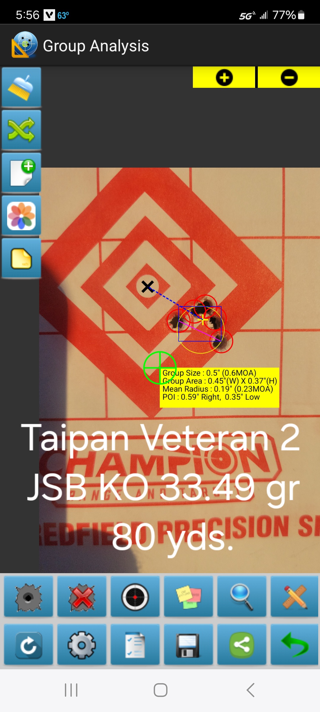

I have been playing with my Taipan Vetran 2 tactical 700mm barrel with slugs. Mine is 25 caliber. I got the tactical version because it was a great deal used. It shoots JSB KO slugs 33.45 gr really accurate. Also shot the JSB Heavy 33.95 mk2 pellets really accurate. I was able to get the JSB KO slugs up to 998 fps. My understanding is the barrel is the same in standard and tactical. Just different lengths. That's in 25 not 22. Oh and it had the stronger hammer spring talon tunes sells installed when I bought it used. These in the picture are going 943 fps

I have the 25cal vet 2 tactical also...shoots very accurately with JSB KO....100 yards group 5 shots...cover a quarter....
