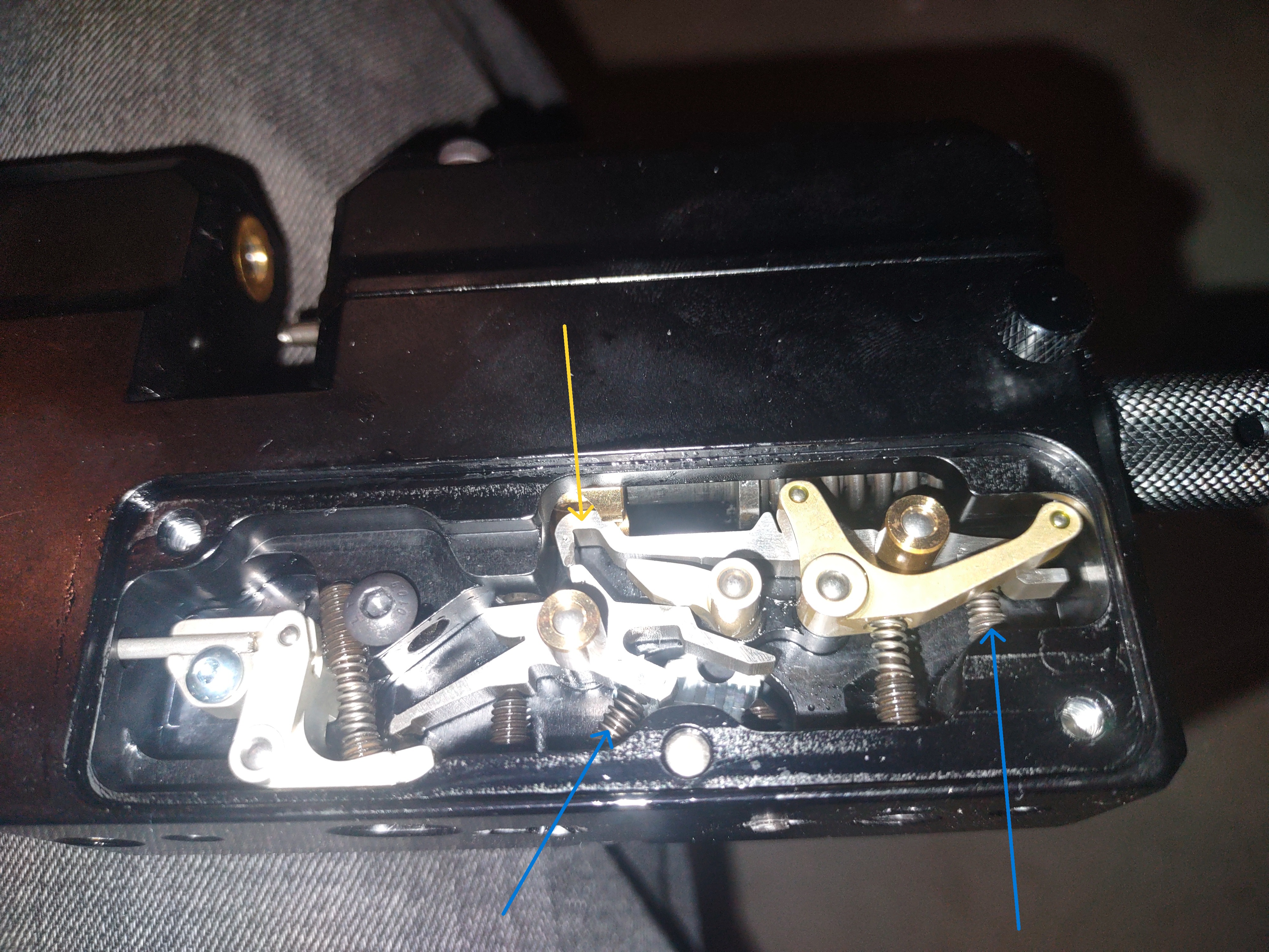

I was able to take of picture of when it's cocked half way. As you can see, the yellow arrow which is pointing to the hammer spring that is stucked or blocked by that bump shown in green arrow. When that happens, I'll need to pull the trigger to let the sear drop to lower the bump, then I'll be able to fully cock the gun. There must be a solution to this. I hope somebody can help. Besides this problem, this gun shoots like lazer, it's the most accurate gun I own at the moment, just too bad it's got the cocking issue.

Okay, after cocking and dry firing for a good part of the day to study the mechanics of the trigger system, I think I found the problem and a solution. And so far my adjustments is working. The problem is the sear (yellow arrow) won't drop down after firing. So when I cock again, it won't cock all the way due to that bump. Since all the trigger systems is connected, I played with the second stage trigger tension and the sear tension to see if the tensions will pull the sear downwards after firing. I rotated both tension clockwise and low and behold, it pulled the sear downwards after firing. To test if that is what's affecting the sear, I reverse the tension to make it lighter on both, and the problem came back.

Came back from my morning of woods walking with about 100 shots with the new adjustments. I'm happy to say the cocking issue totally went away. I tried fast cocking, slow cocking, light trigger pull, full trigger pull, no jamming of cocking issue at all.
Just to memorialize my adjustments for future internet search for solution to the problem, at least for my particular gun.

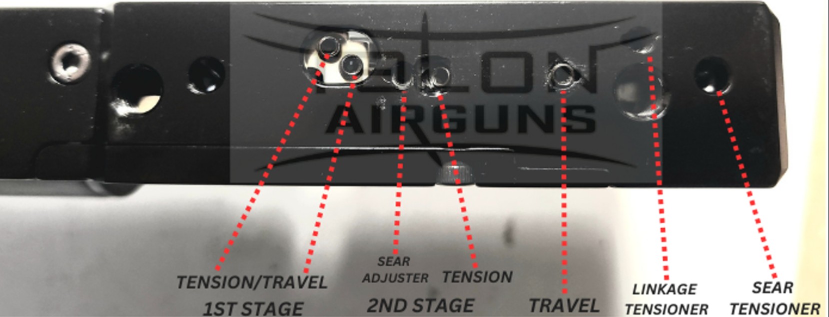

1. Rotate the sear tensioner clockwise two full turns. I first tried quarter turn increments but ended up with two full turns for my gun.
2. Rotate tension of 2nd stage trigger clockwise until the sear drops down when firing.

Such a timely post. I have a brand new Taipan Veteran 2 tactical 550mm, I had the same exact problem! 2 problems actually, but this one really bothered me. I did the exact thing you did (Archdesigner03) with adjusting the second stage tension as well as the engagement, didn't do squat, but it certainly does what it was designed to do, just didn't fix my cocking issue. Like you, I studied how everything worked and went ahead and adjusted the sear tensioner. Well, that did it, seems like it works fine now. I did this yesterday after having the gun for about 5 days. My other problem is a slow leak somewhere. Recieved the gun, it was empty. Pumped it up, lost about 25 bar overnight. Shot the crap out of it over the last few days, seems better, but still a very slow leak. Not worried about it too much right now, will probably degass and make sure bottle, gauge are tight. I think the gun sat in the warehouse for a while and probably lost air over time and the orings/oil dried up a tad bit. We'll see.... Glad you got your trigger fixed, it wasn't hard once you look inside and study it.
