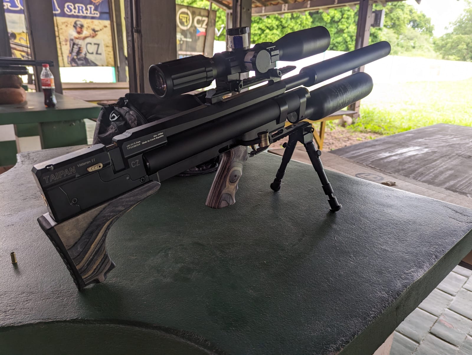

Hello, about two weeks ago I bought this rifle, and I am still unable to find the ideal velocity and the appropriate pellets. I always had the idea that rifles with a CZ barrel were very friendly with any type of pellets, but now I am not very convinced. If anyone has this rifle and has already found the right velocity and pellet or slug, please comment. I leave a photo of my rifle.

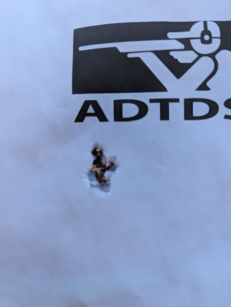

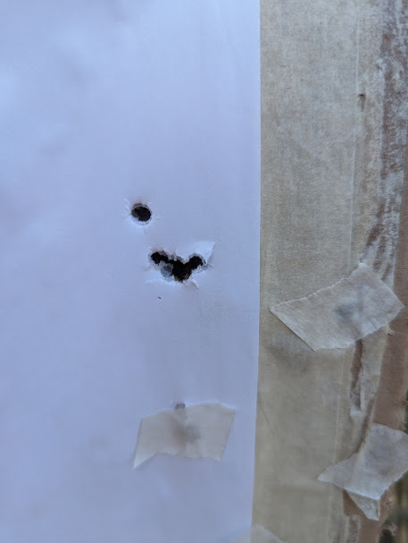

I didn't measure the ctc but I suppose it helps to give an idea, that is 50 meters, the 5.52 jsb suits better. What I don't like is that it doesn't maintain those groups as the days go by, I come back and again it doesn't group in the same way.

Lol I think you have fallen to unrealistic expectations by the keyboard snipers on here that say everyone goes into the same hole every time. Those are pretty good groups at 50m outside. Can you show groups of the bad ones? Also I've personally have had bad tins of 18gr JSBs and haven't shot them in years. The 16gr were better and recently the JTS 18gr are much better than JSBs and have switched to them.

Of course this group is very good, I did it on a day without wind, this weekend I will do some groups again and we will see how it behaves, I still do not have JTS pellets available in my city but I have heard that they are very good.
The groups won’t be that good out of any guns on days with wind. Especially little tiny 18.1’s. Not sure what you expect out of that rifle. Not a powder burner.
