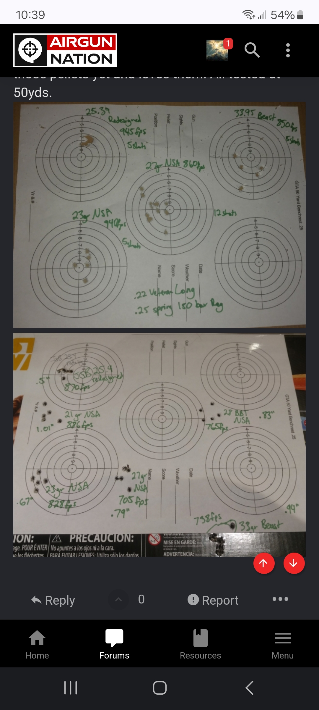

This took me an annoyingly long time to find. I remember in the past having a .22 Long and .25 Standard. Did this back in 2018. Just for fun I swapped the reg from the .25 and the HS to the .22 Long. Took the gun from a 42fpe gun to a 50fpe gun. 54.5fpe if you look at the JSB beasts. Reason for me wanting to find it as i am thinking about shimming my HS to see where my gun plateaus at on the reg setting.

I have tried the AEA 21.9gr and are OK at best to me. The groups a few posts above on the paper are from my old Long in 2018. I posted the screen shot as it took me almost an hour to find and wanted it for info in a recent thread. My groups on card board with stickers are my current targets. I'm thinking maybe I didn't post the 21.9gr AEA targets. They didn't hold near as tight a group ad the 20.83gr Lights. But will be plugging away with it and slugs shortly. Definitely keep an eye out and hopefully it helps for your Barra also.
