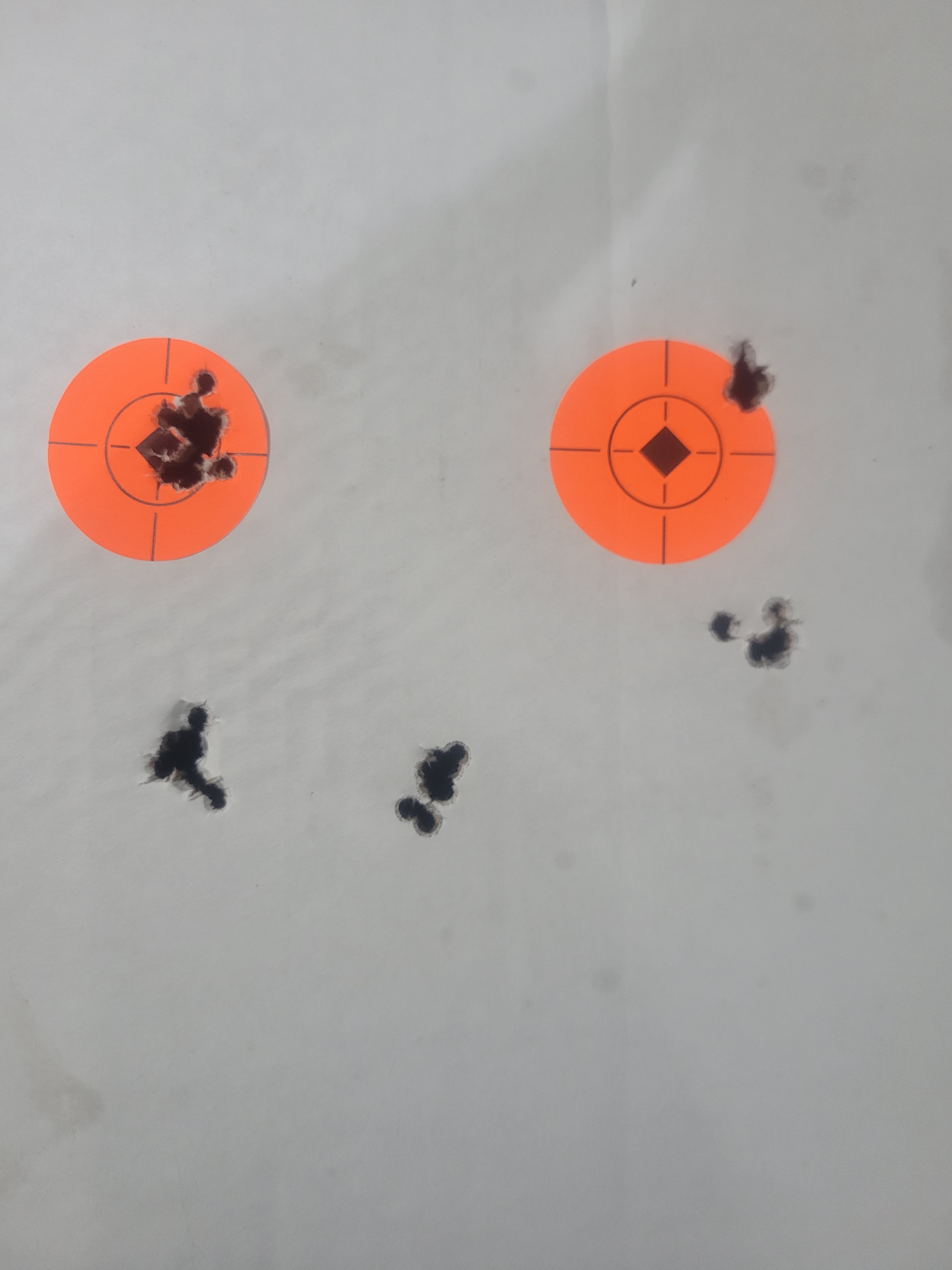

Ok I think a change in plans here is what's going to happen. I think I'm going to shoot pellets with the Vet2 and maybe the Vet1 with slugs. Just shot these groups with them both. Top left is 10 shots with Vet2 with 20.83gr at 925fps. The 2 on the right are 5 shots with JTS 18gr at 975fps.
Bottom left is 10 shots with Vet1 with 20.83gr at whatever speed didn't test. But in the middle is 10 shots with VK 22gr and like before they did extremely well.
That's 2 Vets now that are capable of sub .25" groups with the JTS 18gr pellets. I love those things.
